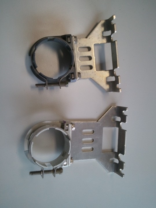

A package just arrived containing 3 support brackets for my 120mhz RGB amps. 2 are correct, 1 is too big.
Does anyone know which projector the bottom bracket is from? It has a barco logo on it.
Support Brackets

Just a guess: The upper one could be from a BG808s and the lower one from a BR909...

None of them are for BR909. The window for cable connection is smaller on Cine 9/BR909.
The upper is indeed for 808 series and the lower could be for 1209 series. On those, the crt socket is bigger (higher).
