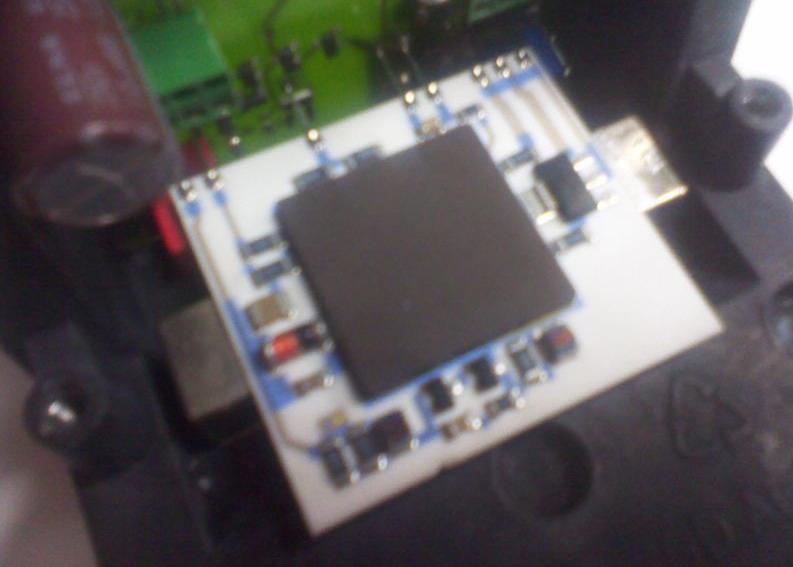

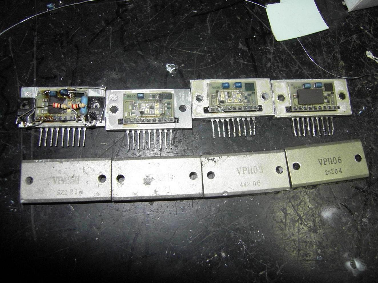

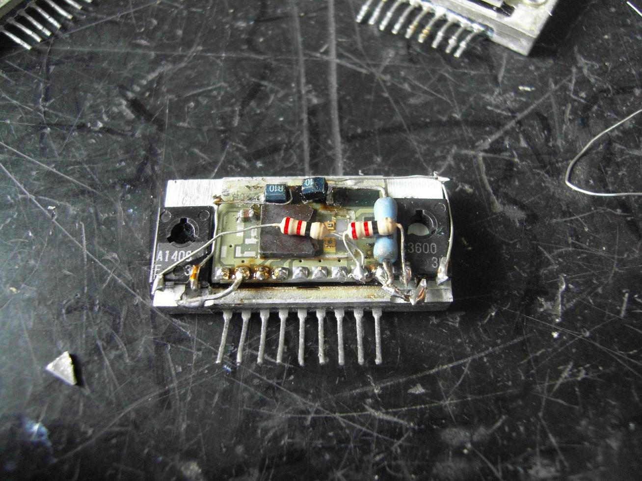

Barco 808S 1208S 1209S video channels are known 180MHZ bandwidth with 909 identical, differing only in CRT socket difference. In fact, the transformation socket can get the same video bandwidth of 909 directly to obtain excellent focusing screen.
CRT socket difference is the use of IC S series socket is that the use of LC 80MHZ VPH08 nominal frequency compensation method is difficult to obtain a flat 120MHZ Bandwidth, 909socket model of IC is unknown and can not be purchased. My internal circuit transformation according VPH06 bandwidth constraints transistor, get 909 plate same bandwidth results.
This circuit is very common for CRT socket NEC PG EHome is the same, and the circuit is to replace higher bandwidth without changing the transistor. vph08 inside the IC is empty, just around the saw with a saw four complete separation 3MM depth can be obtained inside cover. I used 400MHZ bandwidth 2SA1406 C3600 replacement IC internal power output three tubes TR3.4, of course, put the original three complete discharge tube wiring can not have contact. IC's R4 must consider external 5W power, my final solution is still to use VPH08 external current limiting resistor. 200V voltage will be great because the heat can not use VPH internal resistance, but only VPH06 external VPH08 itself is built. With VPH06 is because some Barco CRT socket is VPJ08 is plastic can not be modified and can only be removed VPJ08 replaced VPH06 transformation.
I try to transform the IC is VPH25 18 15 VPA13, found inside the IC TR2 is different. TR2 of the pressure can not meet the needs of the input voltage 200V ic, VPH06 VPH08 withstand voltage of TR2 higher bandwidth is low. This effect is good enough

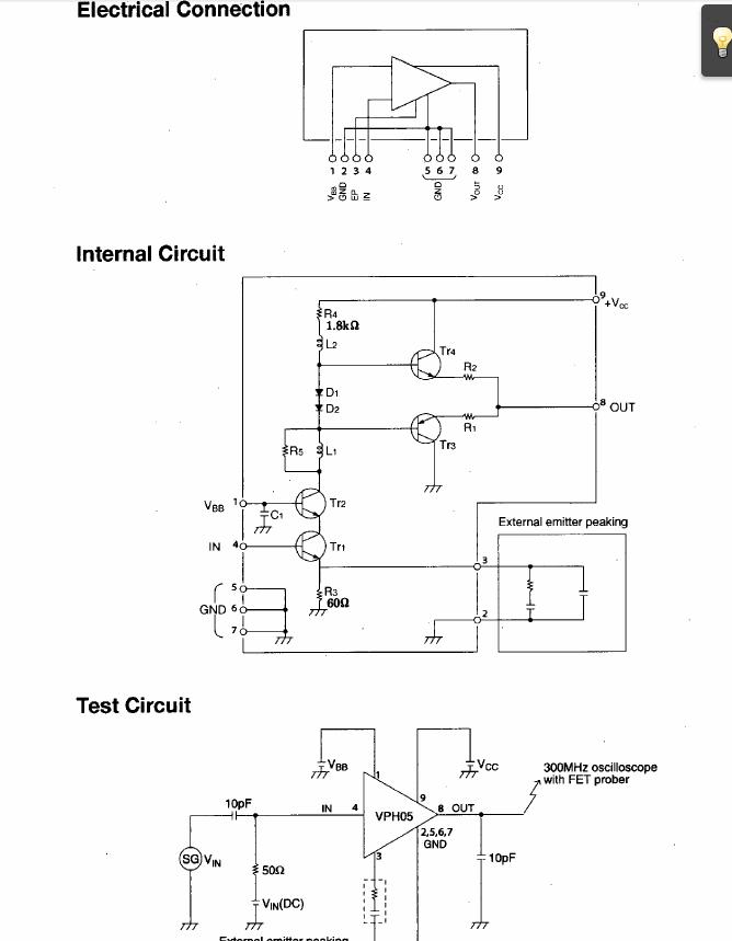

VPH series IC internal structure

Polished sides of the modified placement of the IC transistor

IC does not require the installation is complete closed

VPH internal Drawings

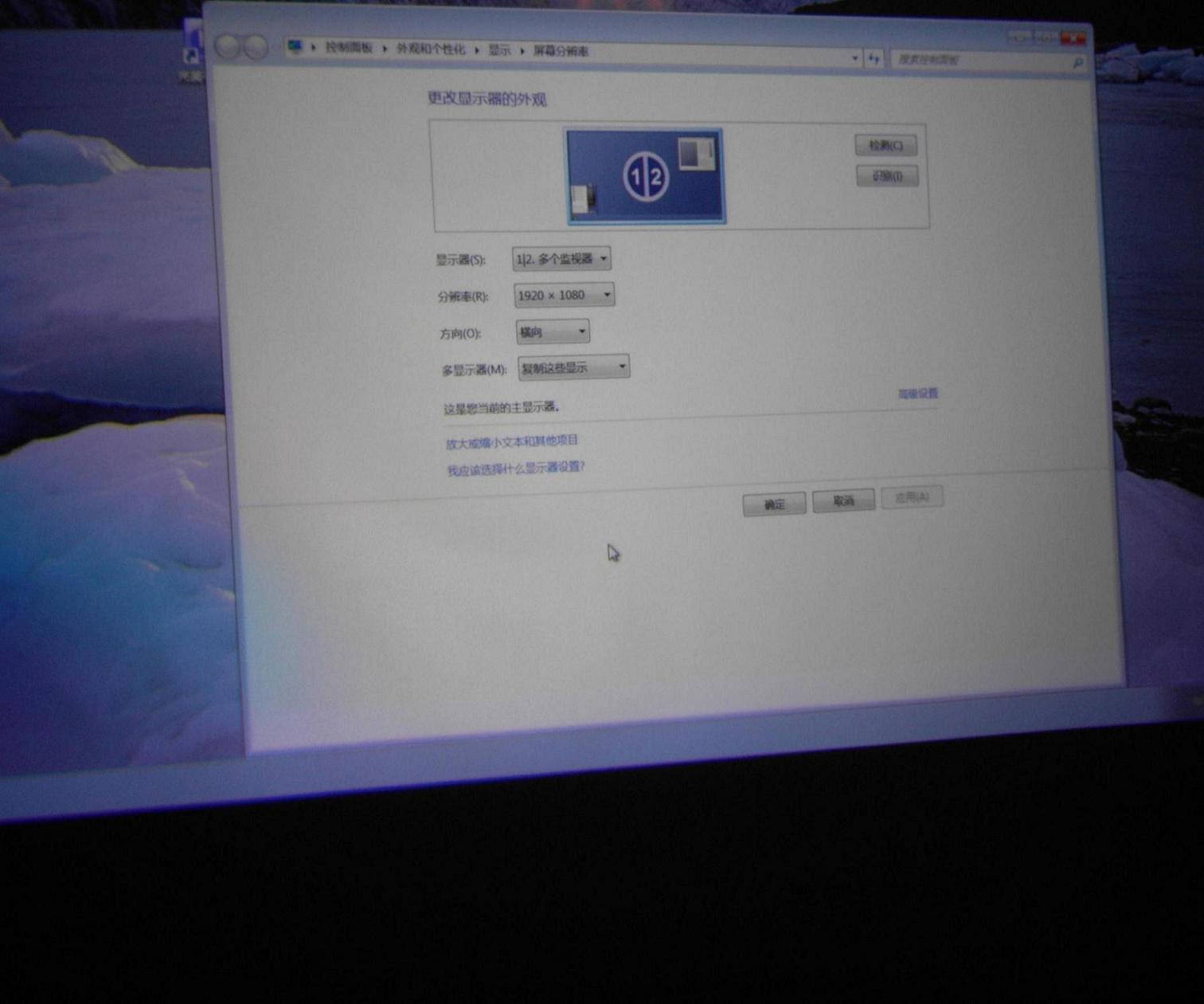

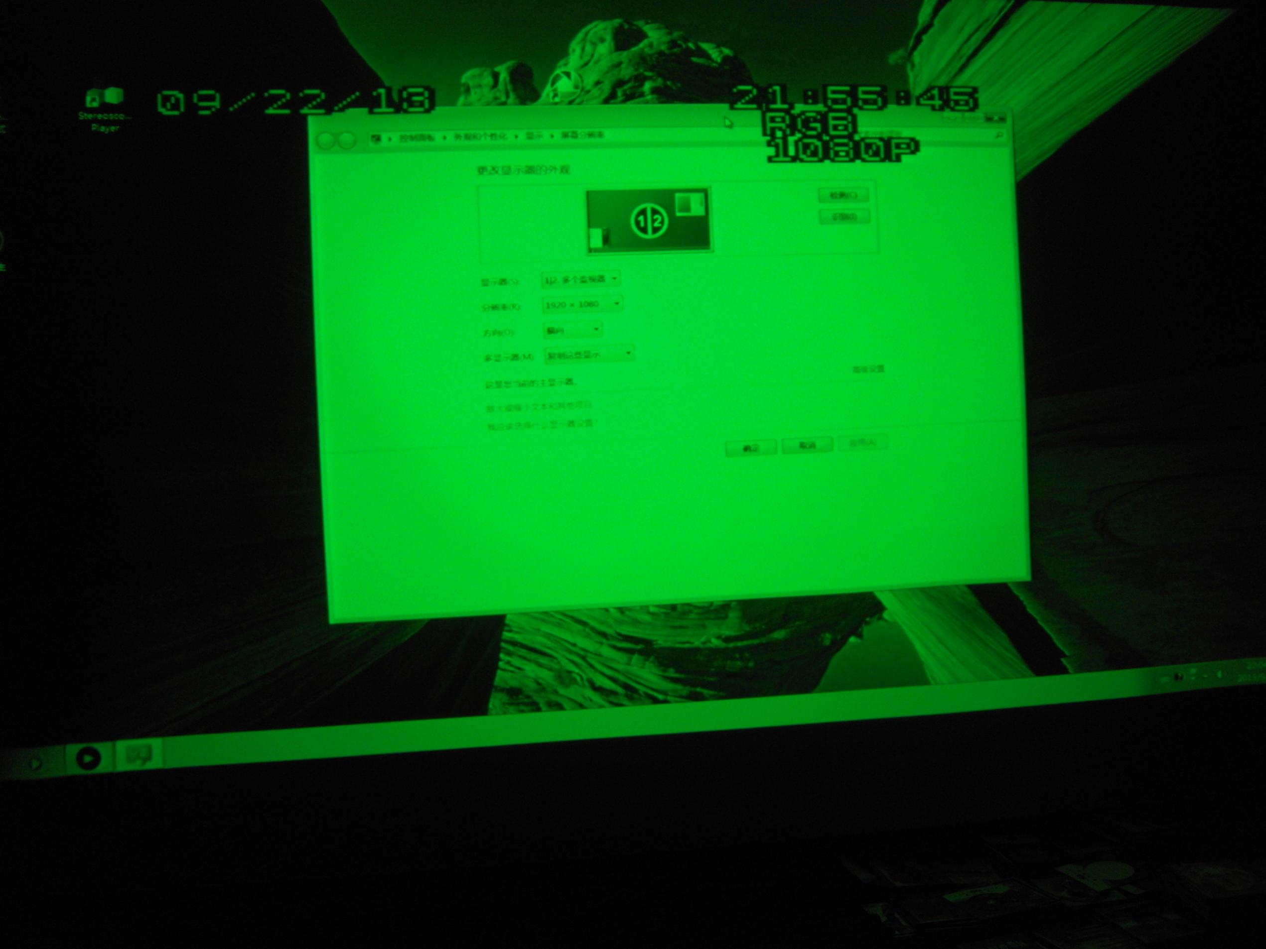

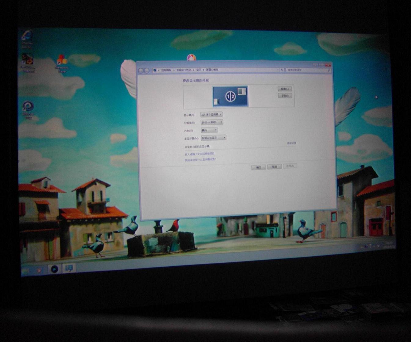

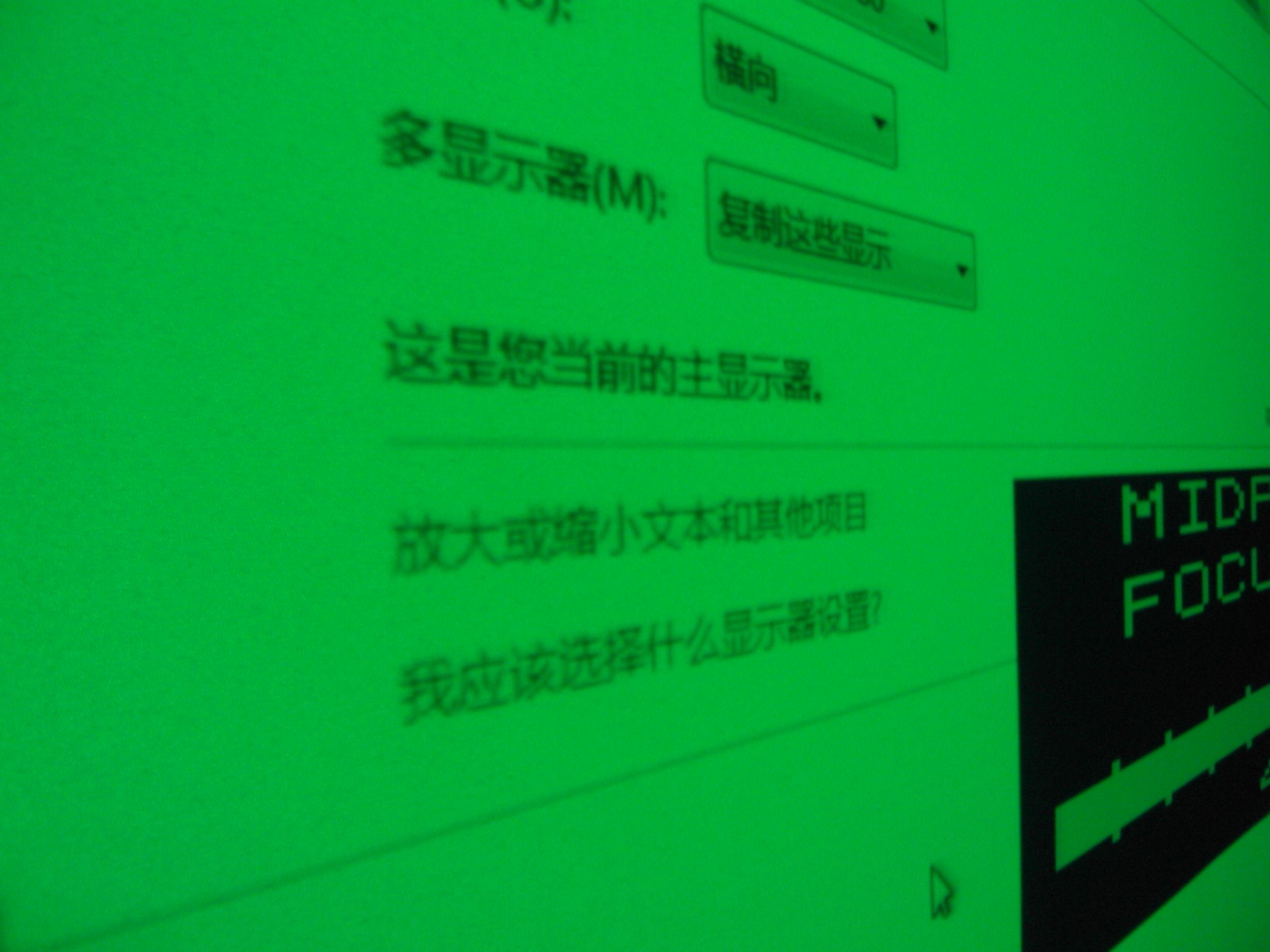

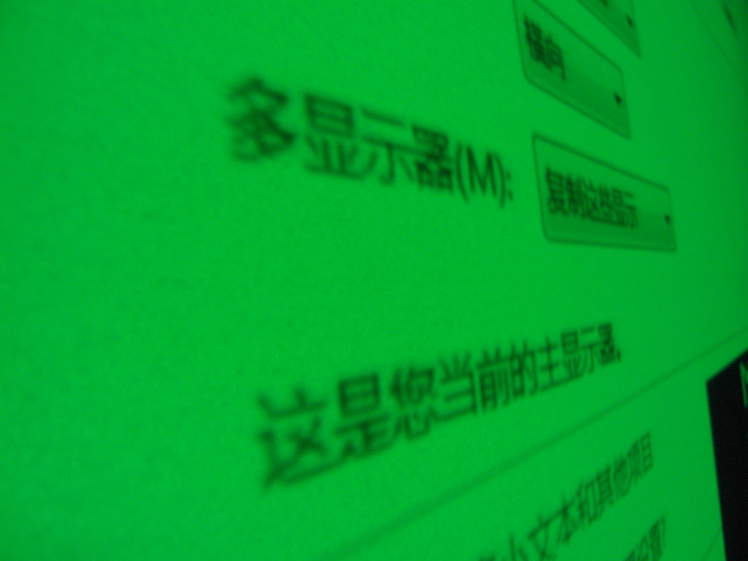

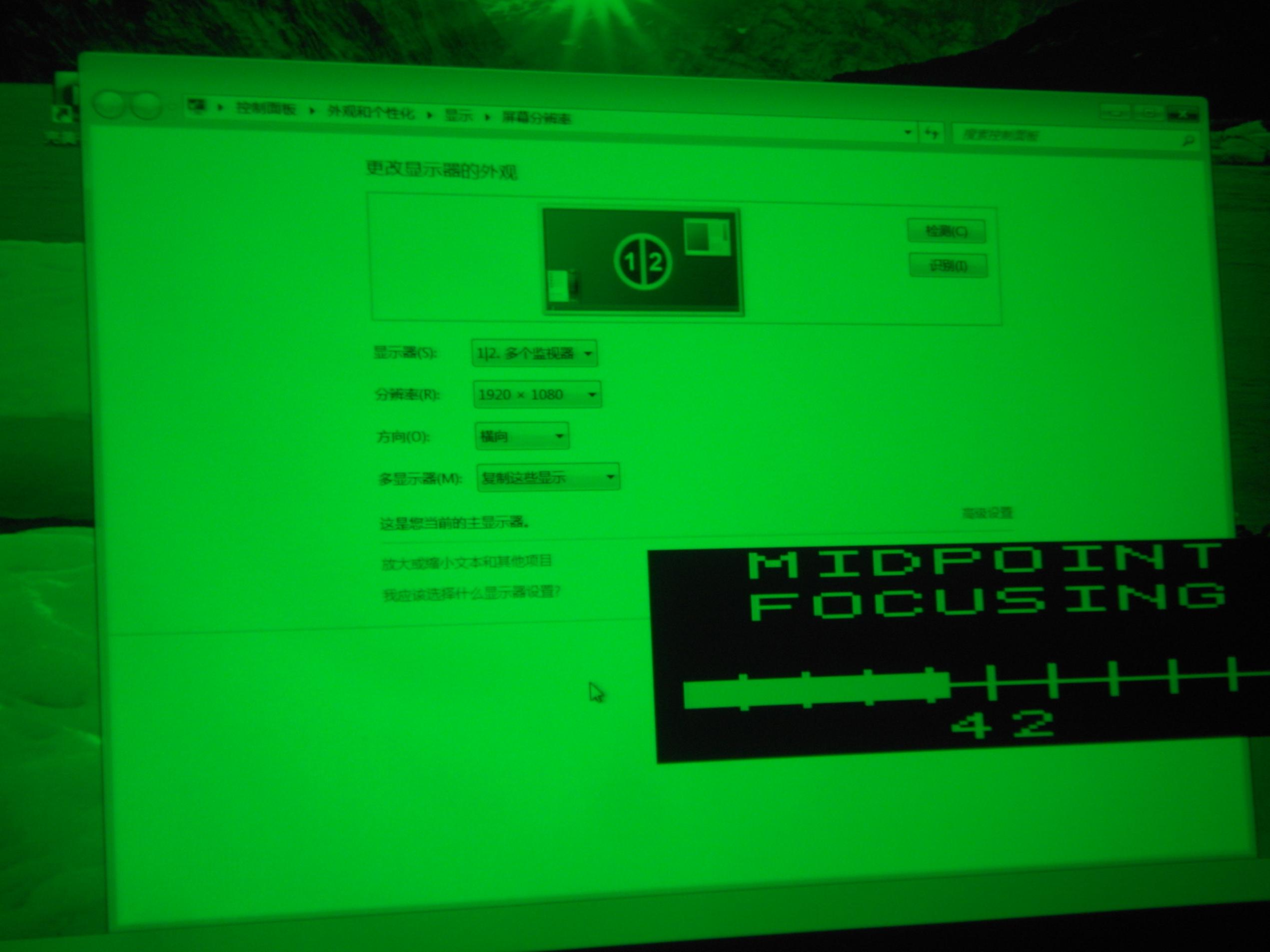

Finally after the transformation of image effects, 808S circuit P19LCP07 HD10GT17 this character has been unprecedented clarity. I saw the sharpest CRT Projector, Modified Green can see the scan lines, unmodified Barco 1209S is impossible to observe I've been using nominal 150MHZ bandwidth XG1352LC, the effect was not as good display characters tailgate after this transformation Barco
Shoot digital camera card Samsung tl34hd night mode conversion as a relatively clear shot to the loss of 30% of the actual
Modified Barco
 Filesize:  132.93 KB
 Viewed:  20875 Time(s)
The text effects WIN7 Desktop XG1352LC

Barco Green

VPA25H is hard to find, I have some VPA18. Can you explain your modification one more time

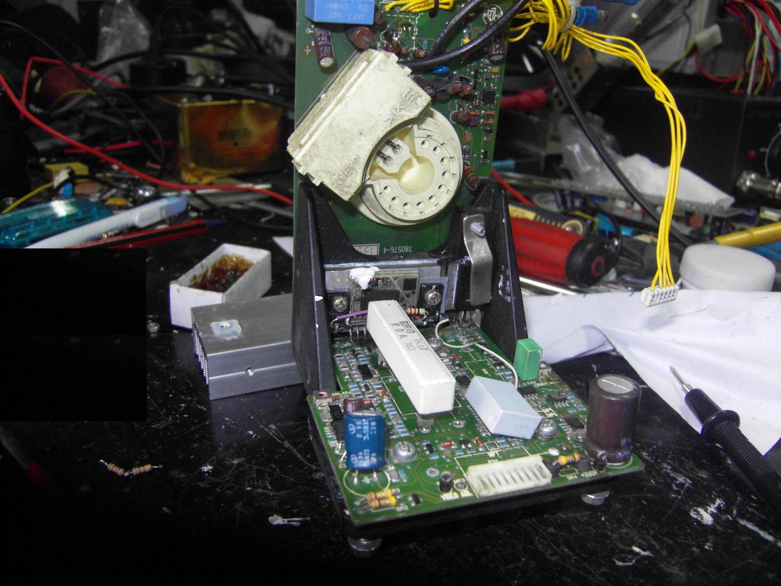

Some questions for knowledge: you have pulled VPH08 and replaced it with modified VPH06, is right?
But I see that you have removed two of the three big resistors (white) from PCB. Is right?

Modified pointless old Barco must electromagnetic focus, I've tried to modify VPA18 15 13 can work only VPH08 06

Yes, three big resistors (white), because 06.08 R4 using different values​​. VPH06 R4 is best to modify the built-in external 5W power resistors
