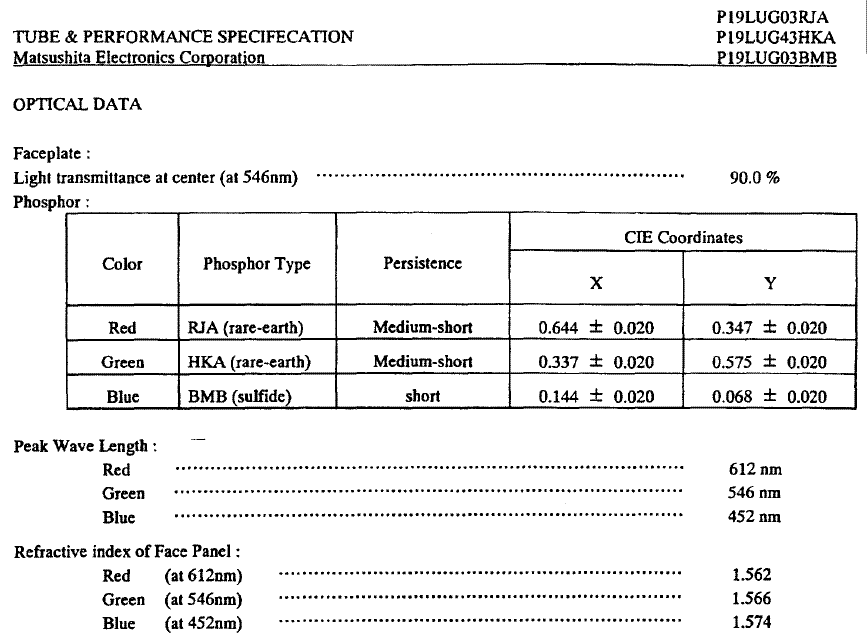

Don't have any experience of LUG's, but according to this HKA and BMP seem to have guite a difference in light output.

Posted: Fri Sep 20, 2013 6:47 am    Post subject:
Now i been looking around, and found this..
So the BMB HKA and so on is just the color code... Makes sence with the light output, like blue dont have a straight curv, and less output.
 Filesize:  26.38 KB
 Viewed:  20410 Time(s)

The P19LUG43HKA is a regular slow decay green phosphor. It's the same phosphor in the LCP, LQF, and LPB. In fact, it is an identical tube in every way to the P19LQF as found in the Sony G90.
The P19LUG has the highest resolution gun and can attain the tightest beam of any of the tubes out there. The P19LUG and P19LQF also have a "scatter grid" to supposedly help reduce noise and improve edge focus. Those are the only two tubes with the scatter grid.
The P19LUG green tube is not available in a P43 phosphor at all.
Any P19LUG tubes (red, blue, green) can be matched well with any other P19LUG or P19LQF tubes of any color. The P19LPB is also a good match for the P19LUG. The P19LPB has the same phosphor and high resolution gun as the LUG, but the LPB does not have the extra scatter grid.
If you are putting the P19LUG43HKA in a Marquee, it can also be used with LCP blue and red tubes, but the P19LUG43HKA will not be as bright in a Marquee as an LCP. You can increase brightness with an LUG in a Marquee with better focus coils (frankenyokes) because you will then be able to raise the contrast higher before blooming.
