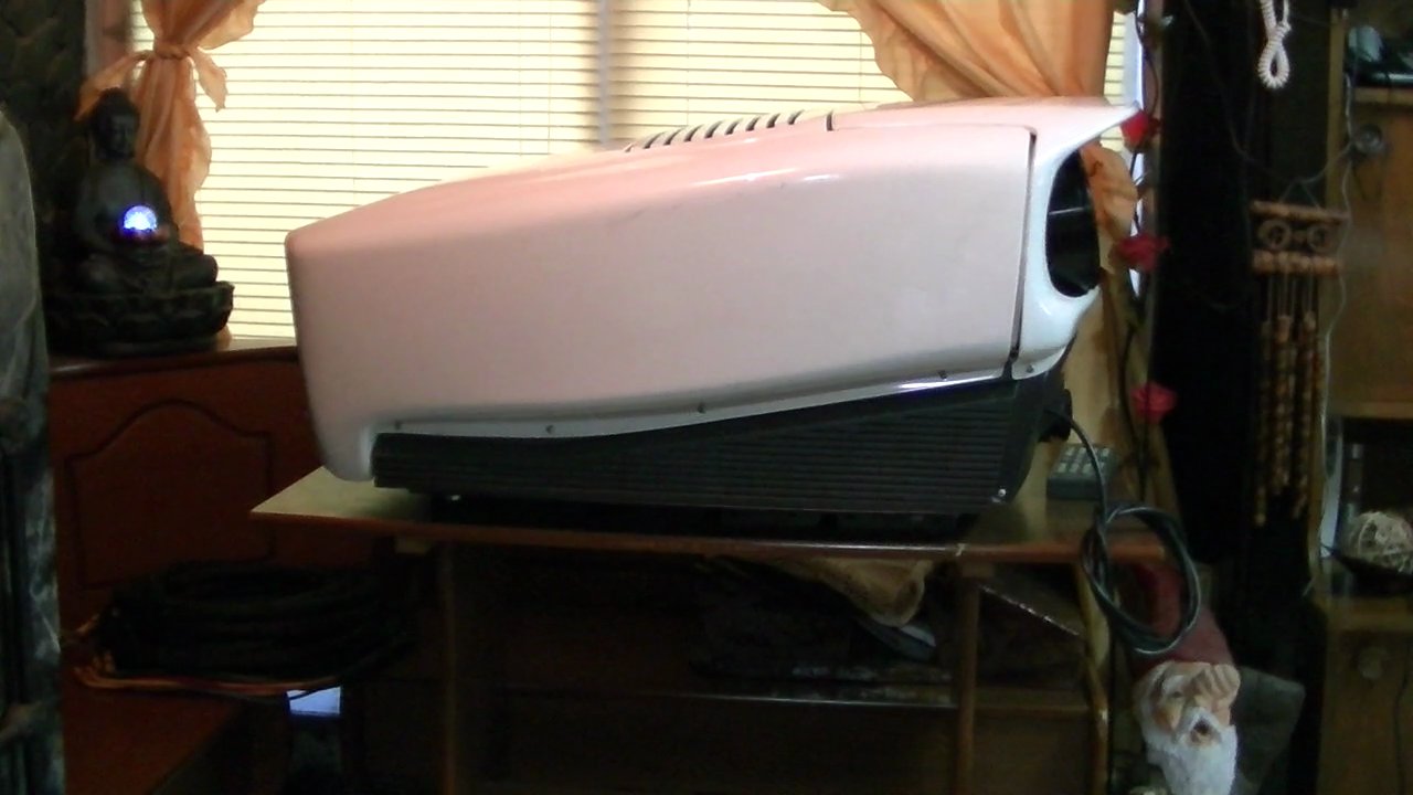

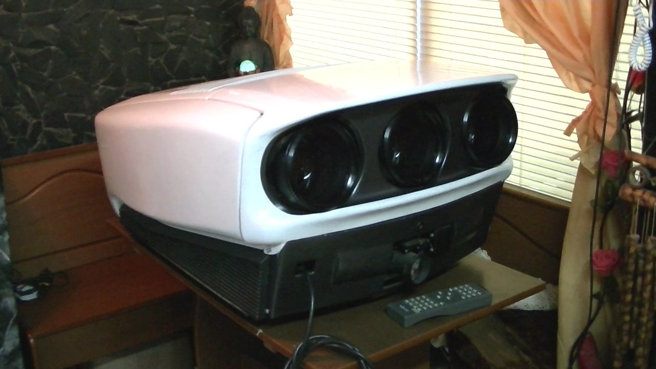

Hello everyone! I was able to buy a projector "Vidikron Vision One". But I failed to rotate the image 180 degrees. Was installed on a roof. Now I want to install it on a table. Anyone know how I can do? I'm pretty sure it can not be done from the setup menu. I think it should be done from inside the projector, with the hardware.
I searched the manual all over the net, but I have not found. Someone has it? I would be very grateful if someone helps me.

Posted: Sun Aug 18, 2013 9:43 pm    Post subject:
Hello
Unplug power, then take the top cover off. Locate three red/white/blue wire bundles on top of the tubes, these are the horizontal yoke harnesses. There is a coupler in each harness; unplug at the couplers one at a time and flip the plugs over so red faces red and blue faces blue, and reconnect.
On the rear heat sink locate three yellow/green harnesses for the vertical yokes (no coupler). Unplug these from the vertical board one at a time and flip them over, and reconnect carefully so they are square on the pins, not shifted sideways.
Power up and check your picture before putting the cover back on.

Posted: Mon Aug 19, 2013 12:12 am    Post subject:
Thanks Tim in Phoenix! Solved!

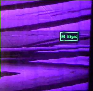

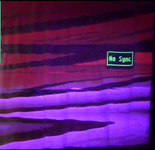

Now I have another problem that worries me more than the subject of this post.
When I turn on the projector displays the message: [No VSync]
I connected all the wires in the right place and you still receive this message: [VSync Out Of Range] or [HSync Out Of Range]
I tried connecting the composite sync and the same message appears.
I think maybe I should do another post.

Posted: Tue Aug 20, 2013 12:51 am    Post subject:
The composite sync is done on the h sync which is the one closest to the blue plug
Now if swapping around the connectors and if you have a computer try it if that don't work then the vim(video Input module) is bad

Posted: Tue Aug 20, 2013 1:09 am    Post subject:
Hello
For the sync problem we need to know what source device are you connecting

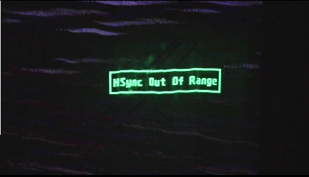

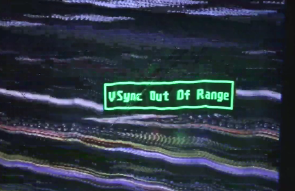

Posted: Tue Aug 20, 2013 1:41 am    Post subject:
I'm connecting the projector to the Faroudja VP 410 video processor, and in this, a DVD player.
the big E
Joined: 20 Apr 2013
Posts: 1928
Location: speedwell Tn.
Posted: Tue Aug 20, 2013 1:44 am    Post subject:
Is the processor on and working?

Posted: Tue Aug 20, 2013 2:07 am    Post subject:
the big E wrote:
Yes. In the function "Video". With the DVD player connected to the video input.
Also I connected the the composite sync, in the h sync, but it is the same.

Posted: Tue Aug 20, 2013 2:24 am    Post subject:
So from the VP are you running the RGBHV connectors to the same ones on the Projector's VIM( Video Input Module) ?
Here is the VP 401 manual I found online
http://www.biggerhammer.net/mediaroom/faroudja/VP401Man.pdf

Posted: Tue Aug 20, 2013 2:36 am    Post subject:
Try using a VGA to bnc cable and connect a pc to the set and see if it locks onto a signal if not then the vim(video input module) is bad

Posted: Tue Aug 20, 2013 2:47 am    Post subject:
I have reviewed each cable to its rightful place.
I tried with both cables Hsync and Vsync. and also with the compound attached to Hsync. And the result is almost the same.

Posted: Tue Aug 20, 2013 3:10 am    Post subject:
What is the frame rate for the DVD players output? Is it higher than 24hz? Also how are you connecting the DVD player to the VP? Composite? Component?
I tried to connect the computer through an adapter, VGA to RCA AV, S-Video. (http://www.ebay.com/itm/PC-Laptop-VGA-To-RCA-AV-Video-Composite-S-video-Converter-Adapter-/190888006697?pt=AU_Television_Accessories&hash=item2c71cfd429 ) And the result is the same.
[No VSync] o [No HSync] cuando conecto los cables de sincronización vertical y horizontal.
Tambien [Sync Out Of Range] cuando conecto el cable de sincronización compuesto.
In all cases, the picture looks bad.
It's like the projector does not detect sync cables. Sad

Posted: Tue Aug 20, 2013 3:13 am    Post subject:
Most likely the vim(video input module) with the rgb plugs is bad and needs replaced contact curt for a replacement as he has a lot of marquee parts and they will work with your set since it is a marquee in disquse
