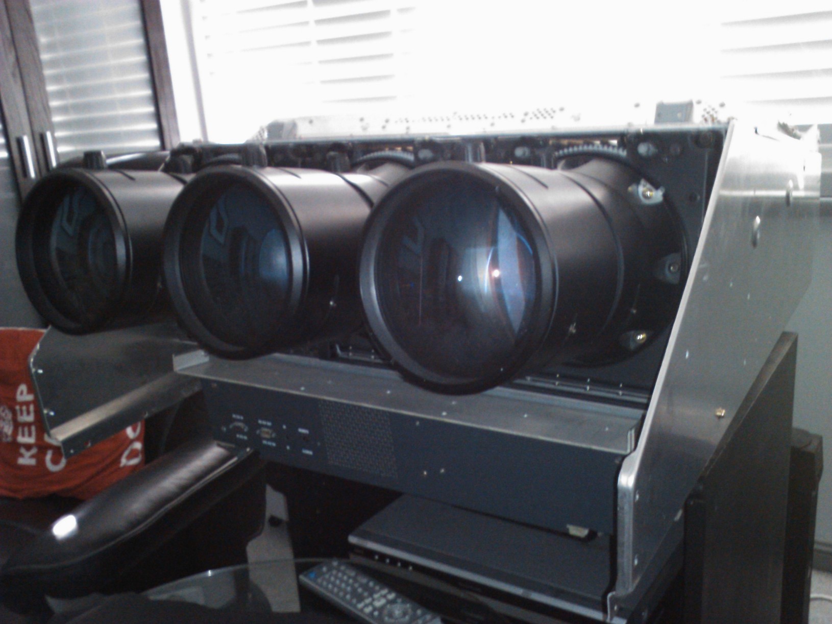

Posted: Wed Aug 21, 2013 1:45 am    Post subject:
Yes I looked at a number of LC systems and I would agree the G90 has the best system.
Thanks for the tips Thumbs Up

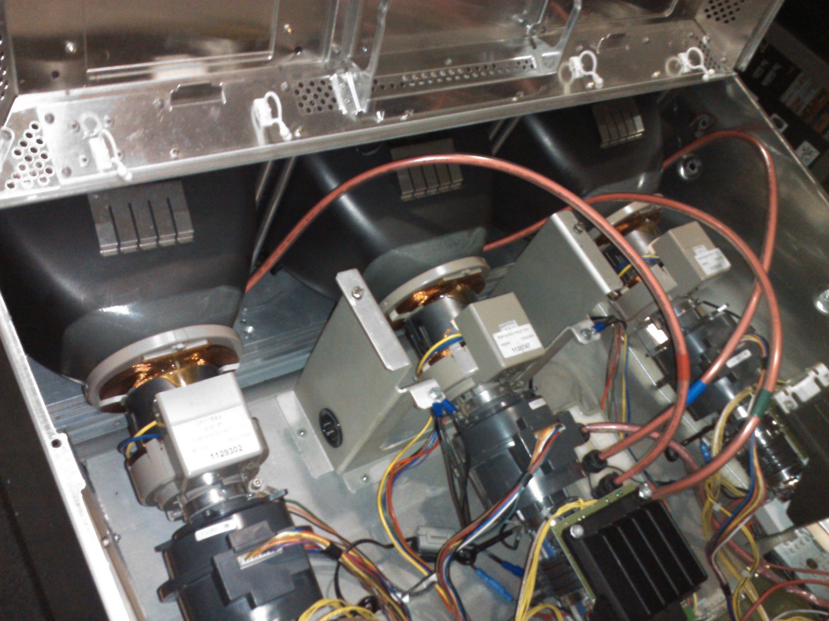

There is a picture attached to give you some idea what this looks like.
Barco 808s/G90

Posted: Wed Aug 21, 2013 1:29 pm    Post subject:
That's working out really well it seems. How have you mounted the tubes into the G90 hardware? Are you using 9" tubes?

Posted: Wed Aug 21, 2013 9:52 pm    Post subject:
Can you post a pic of the inside too?
craigr
I will post more pictures soon
Yes 9" Sony tubes I have 09MEX2 tubes in there at the moment. I have mounted them upside down that is the HT lead is at the bottom which of course doesn't matter. You have to do that to mount the RGB Amp the right way up. The Sony tubes fit nicely into those G90 LC tanks.

Posted: Thu Aug 22, 2013 8:34 am    Post subject:
Picture added above. Inside shot.

Posted: Thu Aug 22, 2013 9:10 am    Post subject:
This looks amazing, could you supply more pictures? Smile

Posted: Thu Aug 22, 2013 2:11 pm    Post subject:
Looks really cool and your work looks quite nice too.
It is just funny to see; looks like a G90 on the outside and a Barco on the inside.

Posted: Fri Aug 23, 2013 12:51 am    Post subject:
craigr
Thanks Craig. The 808 electronics are reliable and the G90 LC setup is the best and I have 10F lenses off a G90. The LC setup allows me to use either Sony or Panasonic tubes. Right now I have Sony tubes and they throw a really great picture with good colour depth.

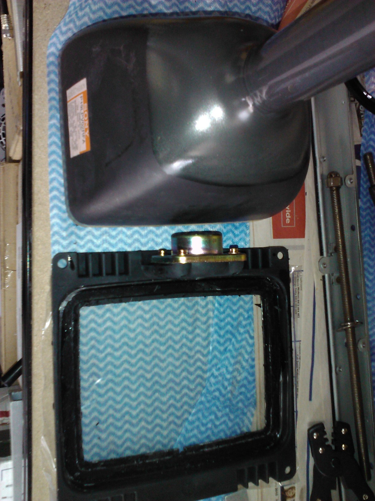

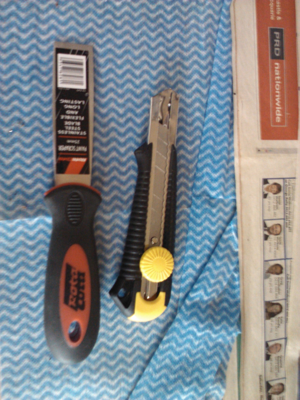

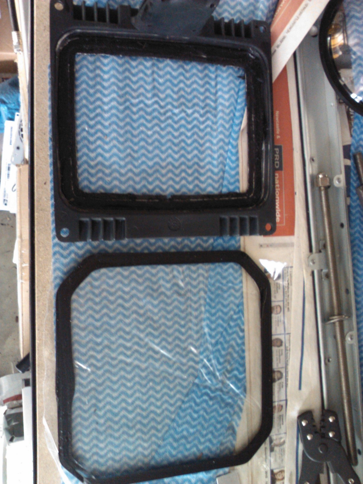

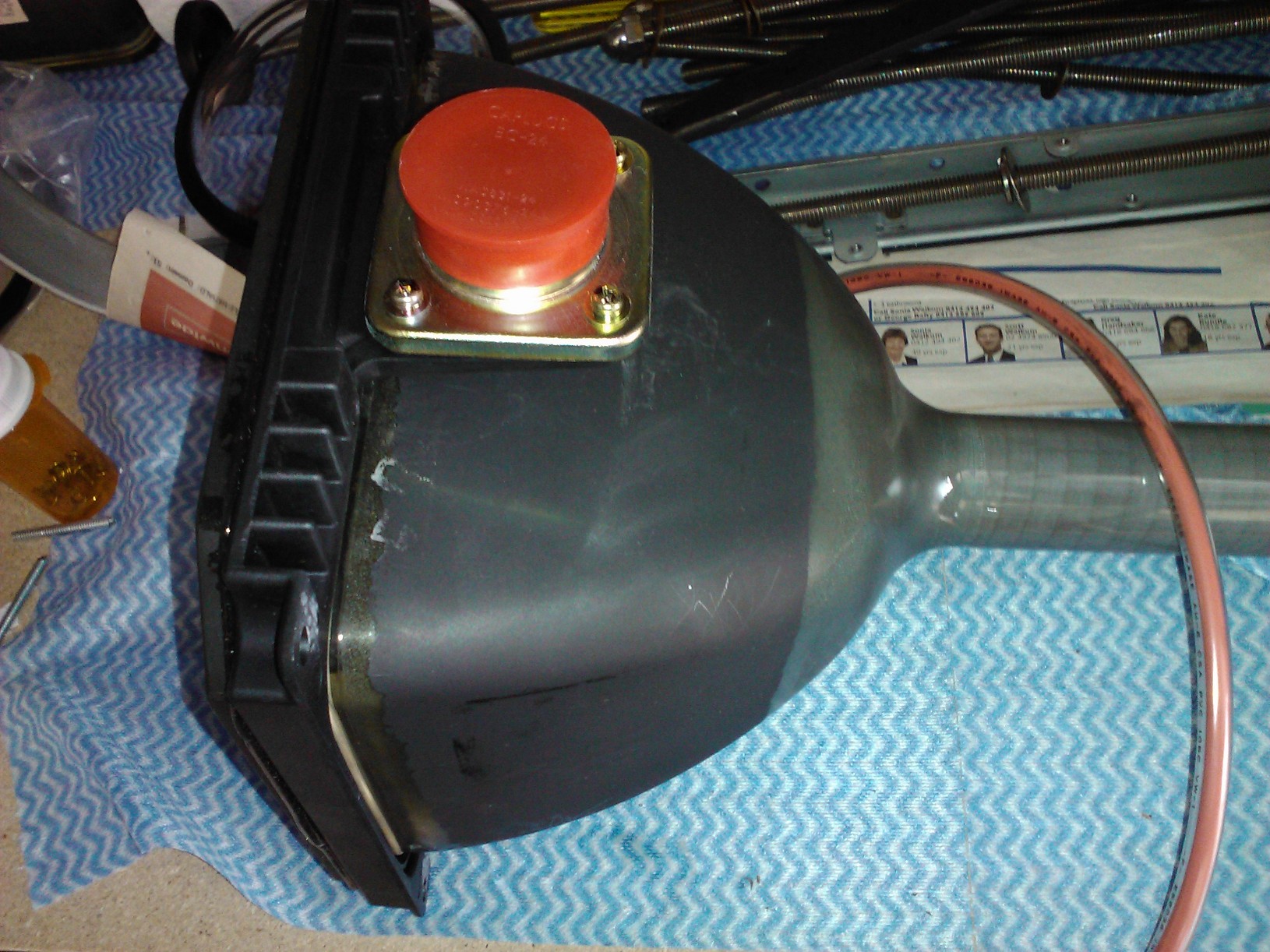

Posted: Sat Aug 31, 2013 6:23 am    Post subject:
Ok I have had some requests for a little more detail on AC Tubes and whats involved in separating the tank from the tube so here are some pictures.
You use the knife to separate the glass from the AC tank by simply cutting around the outside of the AC tank between the tank and the glass. Then use a combination of the knife and flat blade to work around the the metal part of the tank from the inside which you can now get to because you have removed the glass front. Just be careful not to scratch the tube face. Of course drain the glycol first through the drain screw.
Tools to do the job
 Filesize:  427.03 KB

Front Glass removed from AC Tank
 Filesize:  420.27 KB
 Viewed:  9668 Time(s)
AC tank removed from Tube
 Filesize:  412.73 KB
Tube as it comes with AC tank attached
 Filesize:  490.42 KB
 Viewed:  8630 Time(s)
