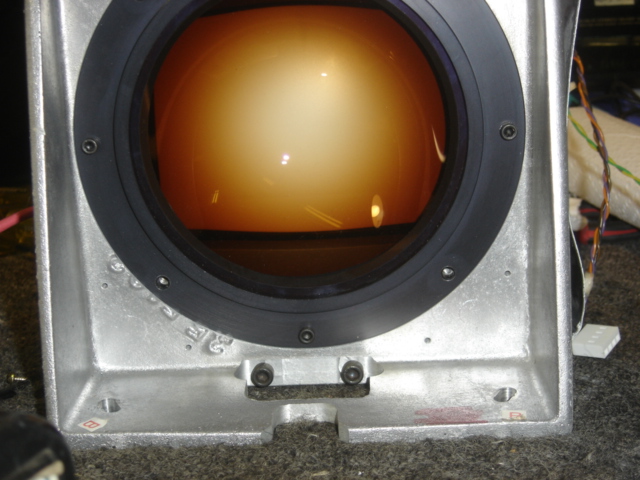

Wow, check out this cool new phosphor color I've discovered!
Posted: Fri Aug 09, 2013 8:45 pm    Post subject: Wow, check out this cool new phosphor color I've discovered!
Earth tones will look fabulous! Mr. Green
 Filesize:  154.14 KB
 Viewed:  1771 Time(s)
Posted: Fri Aug 09, 2013 8:47 pm    Post subject:
No joke, all three tubes looked like this from the set that was stored in a garage for 10+ years. The discoloration came from the rubber washers that went all soft in the fill holes at the top of the tubes... or that's what I figure. Each tube was under massive pressure, although the green tube somehow vented and dumped glycol into the set. Strangely, once it vented, the bellows were just fine.
Posted: Fri Aug 09, 2013 9:07 pm    Post subject:
Wow. So something leached out of the washers and/or bellows and turned the glycol brown. Interesting.
One thing... It does illustrate perfectly why you can't tint the coolant in an LC chamber for color filtering.
Posted: Fri Aug 09, 2013 9:10 pm    Post subject:
Yes and yes. Like some reel to reel drive belts, there was only goo left in the rubber. I cleaned them all up, changed the bellows in the red and blue tubes as they ripped as I was removing the C element (green remained intact and leak free), and am checking them for leaks now for 24 hours at 1/4 amount of glycol before I fill them completely.

Curt I am going the same thing on the vision 3 I got from mike should I vent the other tubes while I have the machine apart?
