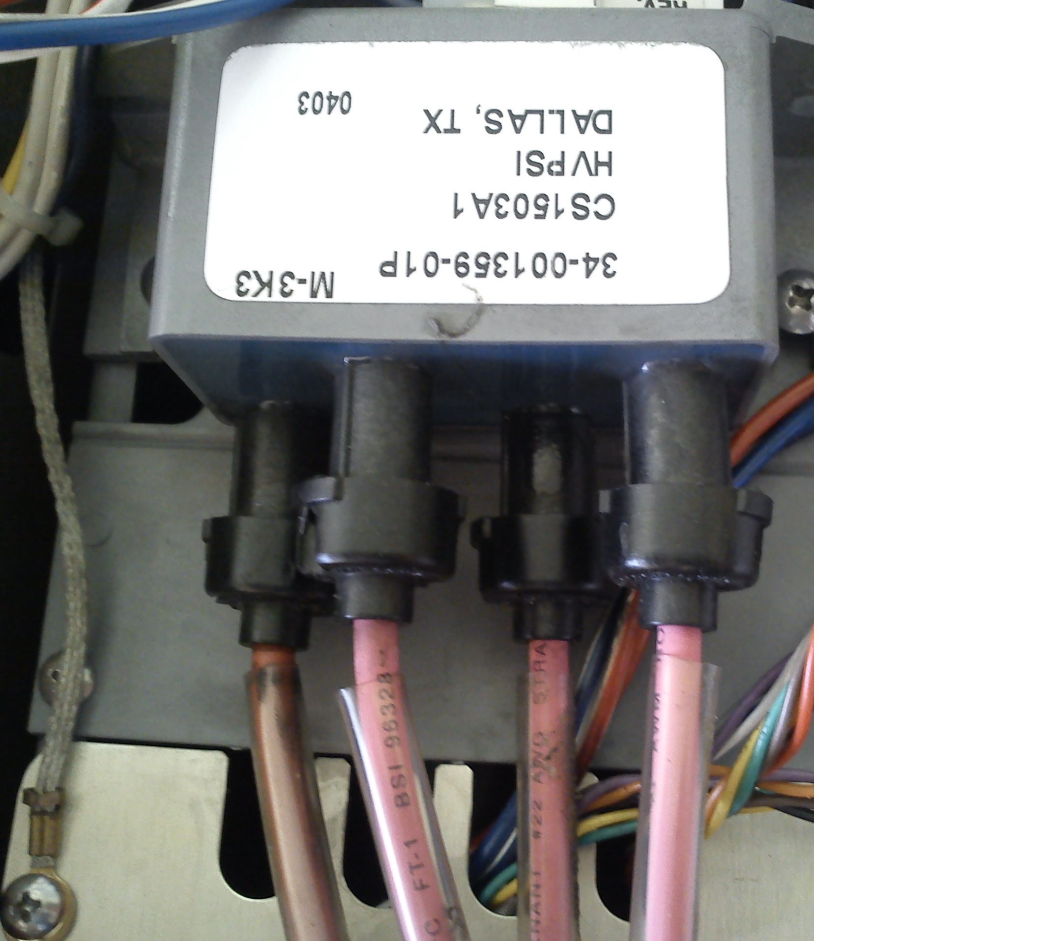

Hi Folks,
the squeak irregular noins is coming from the area where the Splitter is mounted.
Maybe from the Splitter maybe below..
And a lead is able to cause that noise?
Kai

Hello
With the projector OFF, confirm that each anode lead is secure in the splitter; you should feel the connector click into lock like a bnc plug; use long needlenose pliers like a wrench in the indents on each plug. The splitter itself could be leaking, check it for pinholes.
The anode leads or the plugs can also leak.

I cleaned up each lead with chemical contact spray but one plug is broken.
after cleaning the noise was almost gone
i think i need a set of new one.
Kai

Posted: Tue Oct 08, 2013 2:56 pm    Post subject:
Yes, it is. Smile
I cleaned up all leads again but thoroughly and the noise was gone.
The boards should be all clean.
