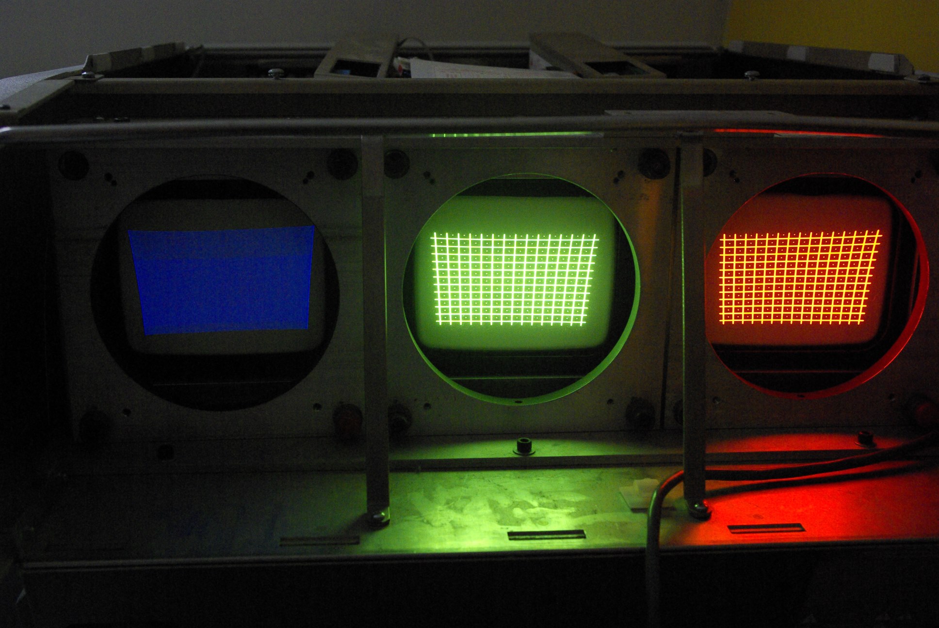

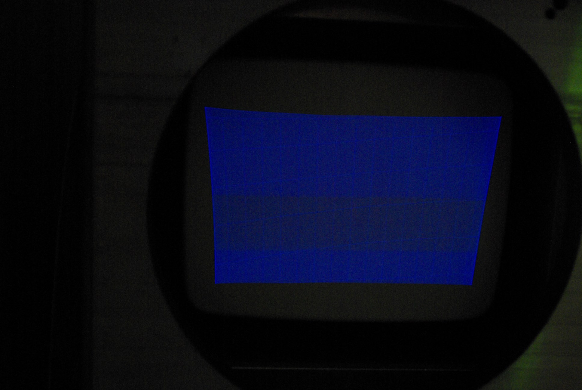

I just installed "new" tubes in this Marquee 8500. The tubes were complete, with all of the magnetics mounted so it was supposed to be a drop-in replacement for some dead tubes (killed by P14 overvoltage). The issue looks like magnetics or deflection related, but short of me randomly poking around I would like to ask the experts: what could be wrong with this? The G2/drive adjustments seem to behave different on the blue tube than the other tubes, which may not be related to the faint skewed pattern shown attached to this post.

Without the G2 set this high, I was not able to get any image - the entire raster is lit with a faint skewed image or it's just black.

Adjust the center line H skew in the convergence...
Turn the G2 down...
Turn the white level up on the blue.
Have you got the yoke connections the correct way around?

Before working on the electronic controls, I would suggest tuning in the mechanical components first. The less work You leave to geometry/convergence circuits the less heat they will produce and therefore less drift.
It is not uncommon that a replacement tube could show a slightly tilted picture. After all, the factory pre-alignment often is long ago and external environment conditions (e.g. magnetic field of earth) and deflection settings (e.g. reversed vs. normal) have an influence too.

It doesnt really look like a yoke rotation issue though, the horizontal lines are tilted within the raster

Thanks for the responses! I'll give those things a try in the next few days.
| CasetheCorvetteman wrote: |
Have you got the yoke connections the correct way around? |
Based on the colors of the wires/and the pinouts yes...but it's a distant possibility that the yoke connections are flipped on the manetics themselves, so I'll verify that as well. It is curious that the raster is being scanned correctly...so I'll work under the assumption that the magnetics are actually ok.

The g2 is higher then it needs to be for sure on the blue tube(turn it down)
Look over the info curt has on here(under the marquee section) and find out what needs to be adjusted to get the blue tube back to regular brightness with the g2 at a normal level

Ok, I've got the G2 adjusted correctly based on the raster...but I am unable to get the brightness back. The original problem has disappeared - the image is aligned correctly (no skew) but is extremely faint at 100% brightness and 100% drive. Could the video level from the VIM or the CLM be too low? Could I swap the video lines (at the rear of the tubes) between the green and blue tubes for test purposes?
If necessary, I could measure the video inputs with an oscilloscope.
I haven't tried an external video source with projector yet - only using internal test patterns.
P.S. I couldn't find any tips on returning the brightness back to normal levels.
Thanks!

Sounds like the tube heaters are not working or have burned up in the blue tube(it will cause this issue) try swapping around the neck boards and if the problem follows then its the neck board if not its the tube
Sorry I can't help otherwise given the tube heater voltage is normal
