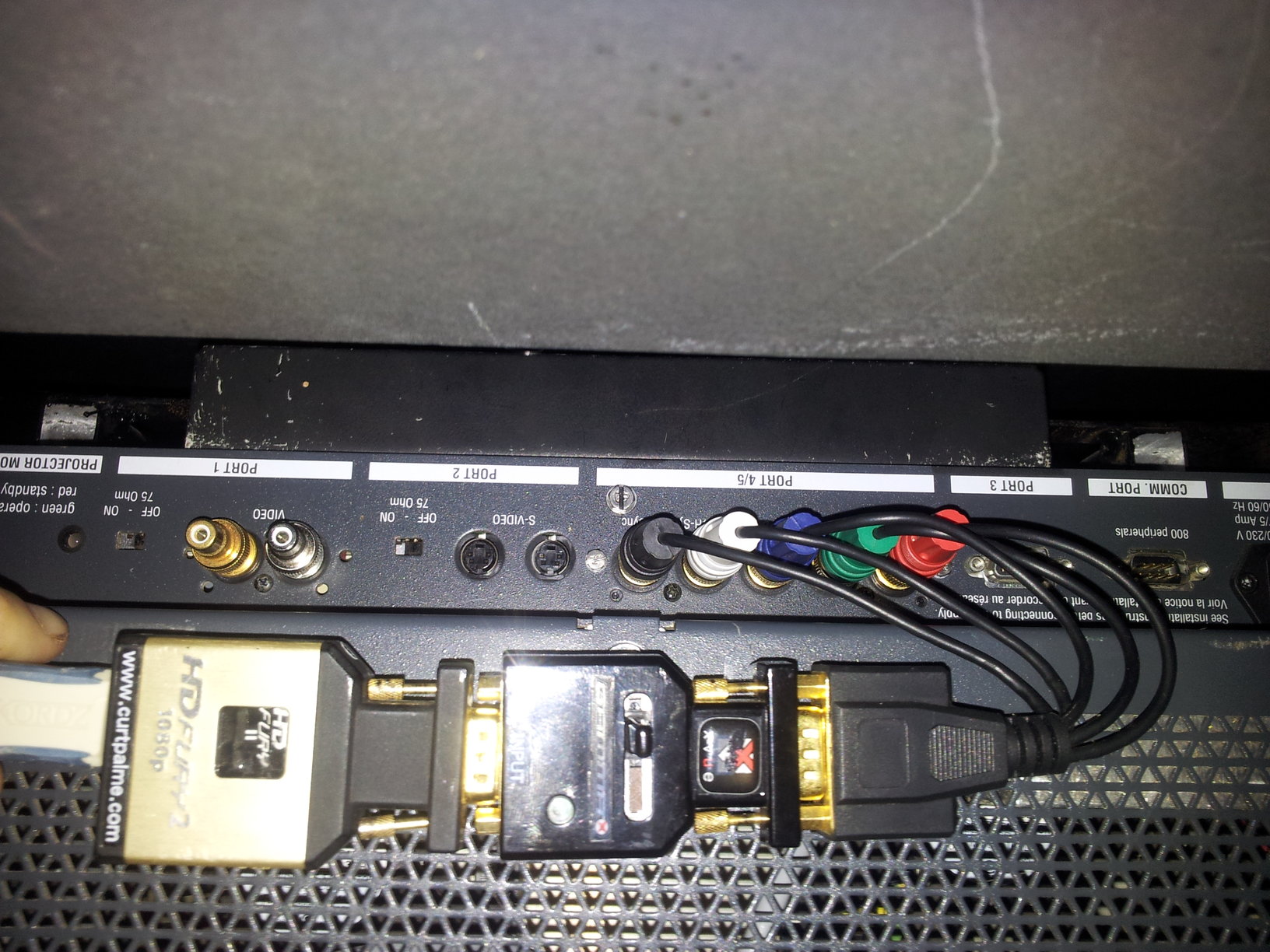

on the back of the projector the rgb port is 4/5 that's the one it is pluged into like I said the bloody thing was working sweet I havnt changed any thing and all off a sudden now I cant get a good signal from the dvd threw the hd fury
back of pj barco 808

Do you have the cable for the HD Fury to Port 3? It is also RGB, and that is what i use on my Cine 9
damian
Joined: 13 Jul 2013
Posts: 25
Location: geraldton western australia
Posted: Mon Jul 15, 2013 7:41 am    Post subject:
no but my old man mite have one I will have to go c him I thought that was a rs32 port

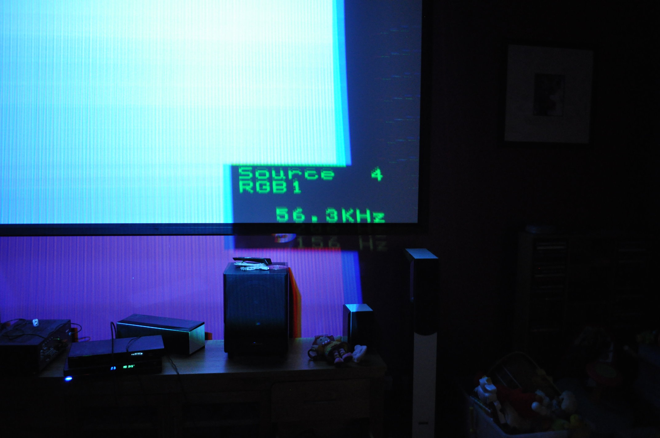

here us some pics I took just now 2 with dvd player and 1 with laptop every thing the same but the source
 Filename:  rsz_dsc_3427.jpg
 Filesize:  321.78 KB
 Downloaded:  382 Time(s)

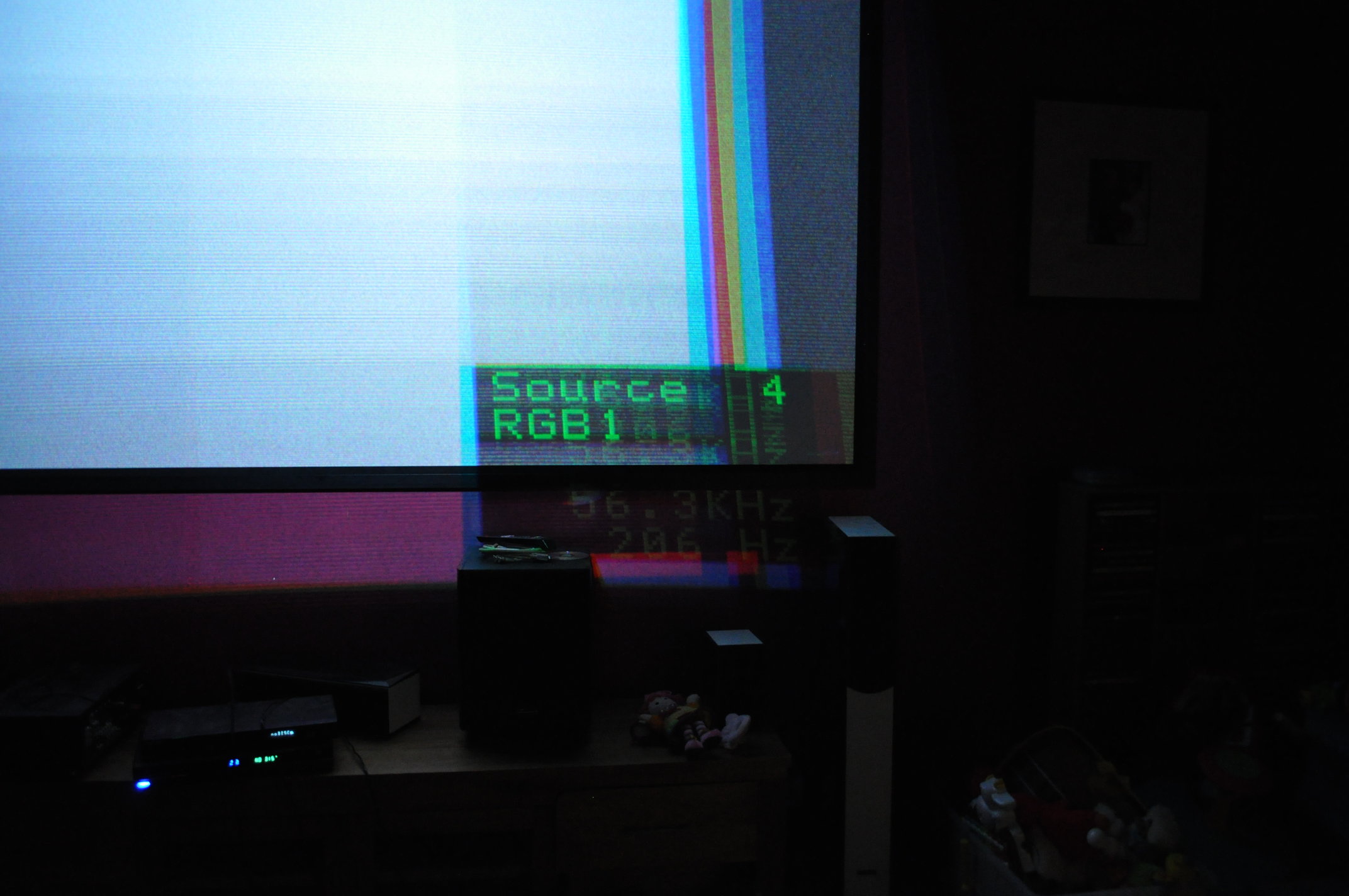

damian
Joined: 13 Jul 2013
Posts: 25
Posted: Mon Jul 15, 2013 1:40 pm    Post subject:
pic 2
 Filename:  rsz_dsc_3428.jpg
 Filesize:  338.91 KB
 Downloaded:  394 Time(s)
