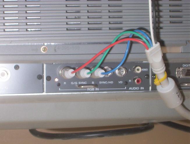

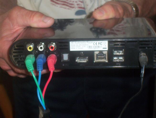

Thanks for the responses. I realize my question was given poorly, so I will try again with pictures.
I have a Zinwell media player I have hooked up from its component out to the video input card on the Sony projector. As far as I know the video input card does sync-on-green.
The resulting picture is all green, and some videos I try to play have a scrambled picture. Are there jumpers that need to be reset in the Sony video input card? Or does something else have to be done?
I could not find an answer in the manual for the Sony.
Here are pictures of the back of both.
Thanks.

Posted: Fri Jun 28, 2013 9:14 pm    Post subject:
Hello
The picture says everything. Component is Not RGB, a transcoder from YPrPb to RGB will be needed.
Posted: Sat Jun 29, 2013 2:04 am    Post subject:
Hold on, i think you may find the 1271 has component input....
Posted: Sat Jun 29, 2013 2:06 am    Post subject:
Really?
Posted: Sat Jun 29, 2013 2:18 am    Post subject:
Really?
Apparently according to Curt's list of specs in the Sony section, i just checked and it is alleged that they all do except the 1270, im sure i read somewhere there is a change you need to make inside it somewhere.
Posted: Sat Jun 29, 2013 2:21 am    Post subject:
Sync on green is not component either Daveb859, different.

Posted: Sat Jun 29, 2013 4:50 am    Post subject:
i have a digital projector that does sync on green and it works with component video via component to vga adaptor
crt king of black
Posted: Sat Jun 29, 2013 5:41 am    Post subject:
At the risk of repeating myself...
Sync on green is not component Big E, different.
Posted: Sat Jun 29, 2013 6:28 am    Post subject:
Really?
No. Component input on a 12xx is only possible with an IFB-12 card. The poster has an IFB-10 or IFB-11 card, which was the typical card in a 12xx and RGB-only.
Further, I had (still have, actually) an IFB-12, and I was never able to get HD component to display on my 1271. Dicked with every dipswitch setting I could on the IFB-12, and never could get it to work.
If you really want to use analog, there should be some Kimcoders kicking around for not much money. Personally, I'd rather go HDMI via HD Fury for something more flexible in the future.
Posted: Sat Jun 29, 2013 6:42 am    Post subject:
Thanks Crabb, i knew i had read about how it was done many years ago, but i couldnt remember much about it. The list does say component but its in brackets, maybe for the very reason you state above.
