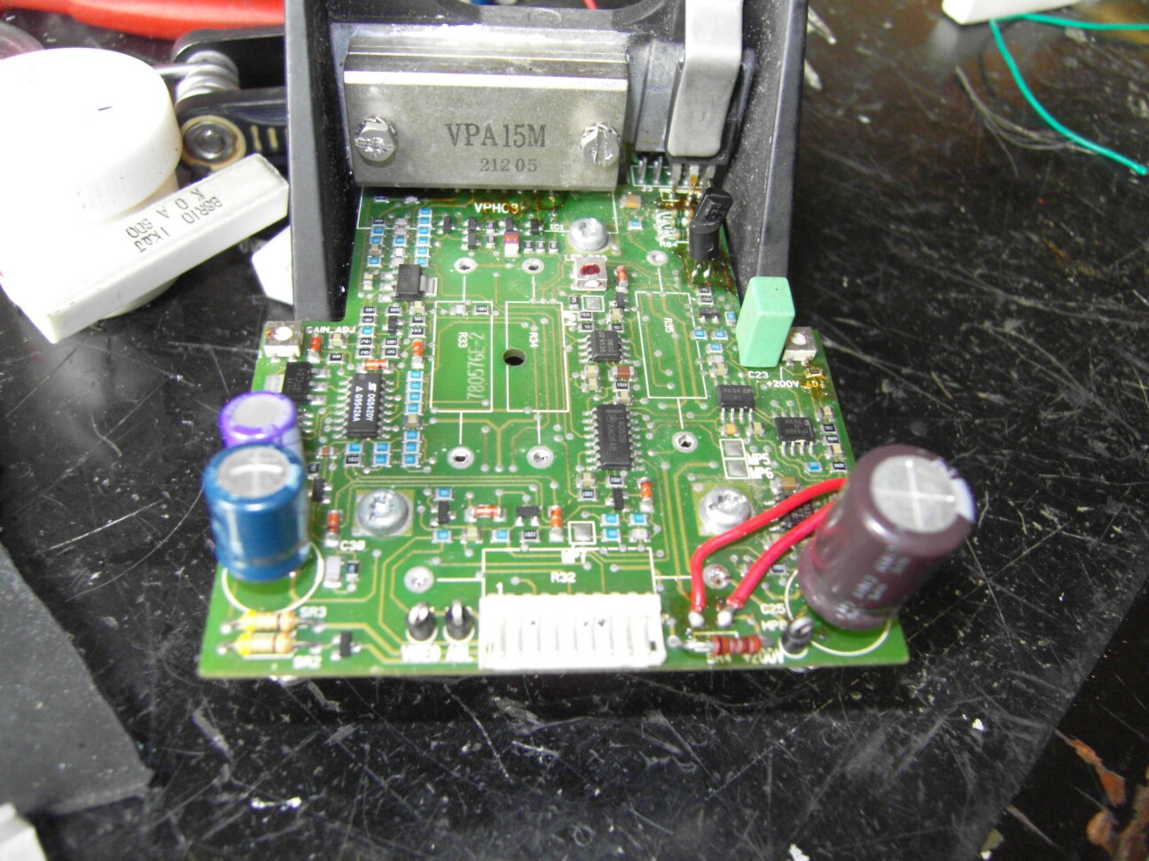

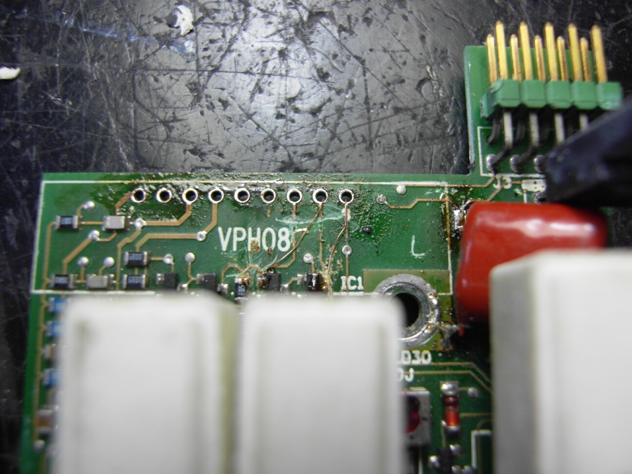

Barco barco crt sockets board Using VPH08, insufficient bandwidth of the IC,Replace the VPA15 bandwidth 150MHZ or 180MHZ or 250MHZ's VPA25 of VPA18

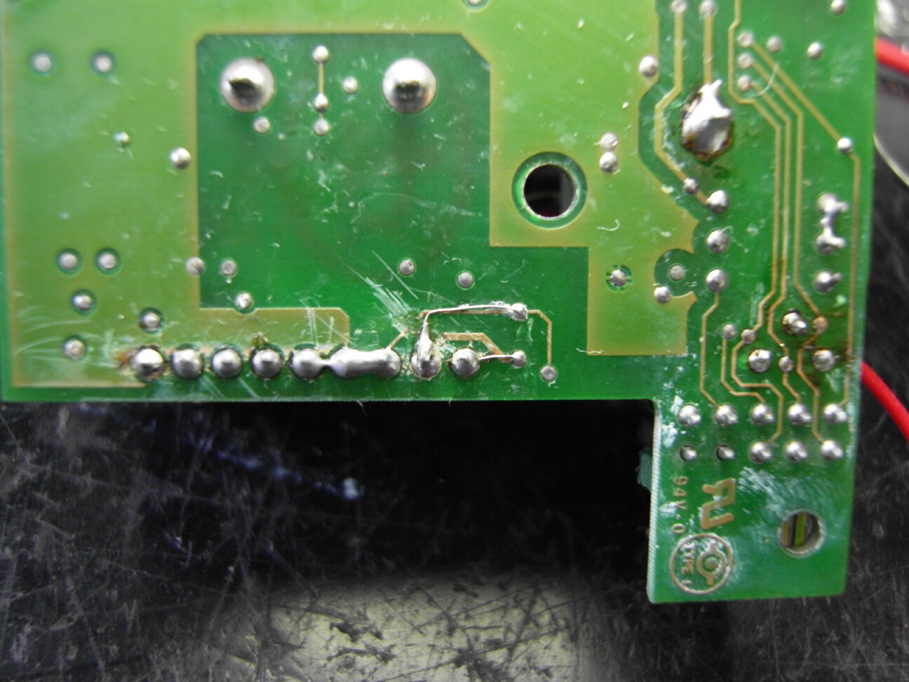

First, before the change to understand the difference between direct VPH08 and VPA15 first pin differentiated VPH08 7 feet 9 feet is a constant current output pin is connected to the supply voltage 8. VPA13.15.18.25 ground is 7 feet 8 feet 9 feet then the power output. So to change the pin order, the original plate 789 Tiaoduan 7 Ground 8 changes to the original seven positions 9 and 8 are connected. Specific methods see picture
 Filesize:  236.7 KB
 Viewed:  5787 Time(s)
The original plate 789 Tiaoduan 7 Ground 8 changes to the original seven positions 9 and 8 are connected

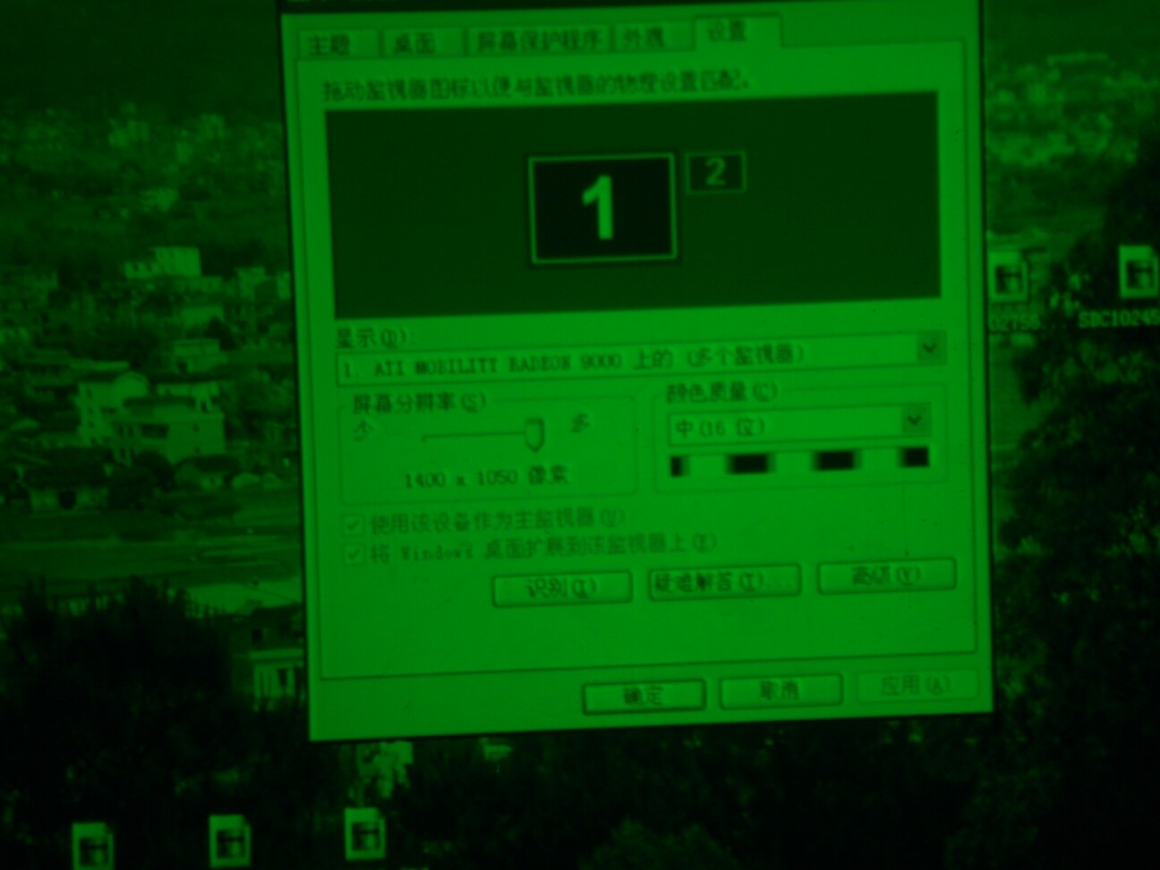

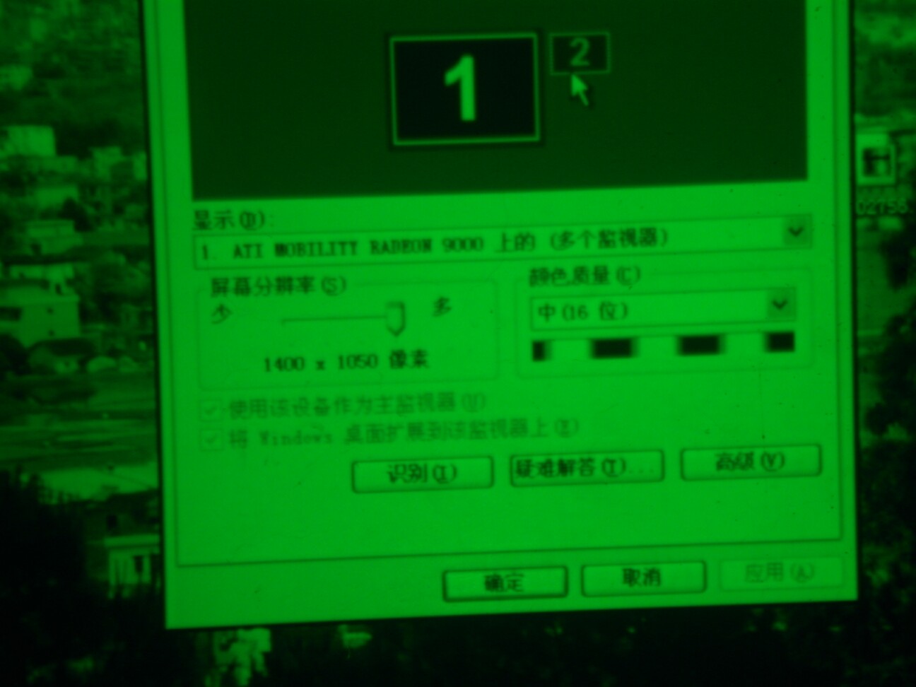

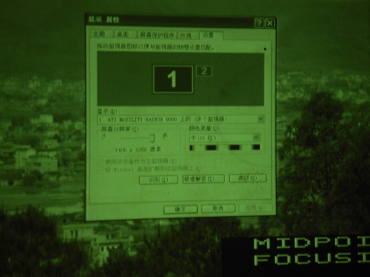

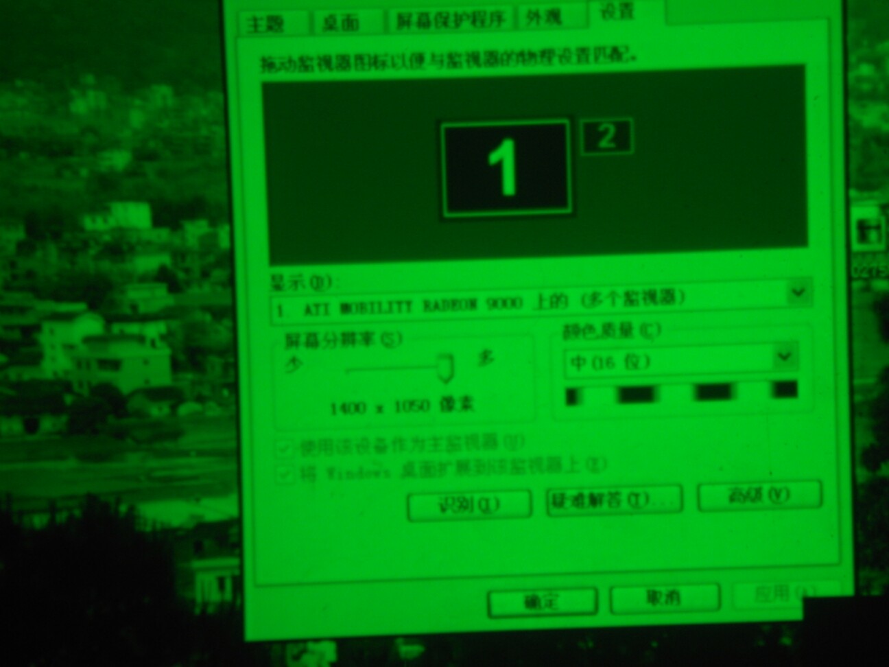

Mainly to see the changes in the resolution of the word G2 adjustment, so I do not go to the reference dark detail and brightness
 Filesize:  150.04 KB
vpa15
 Filesize:  150.17 KB
VPA15
 Filesize:  121.83 KB
VPH08
 Filesize:  119.47 KB
VPH08
 Filesize:  129.27 KB

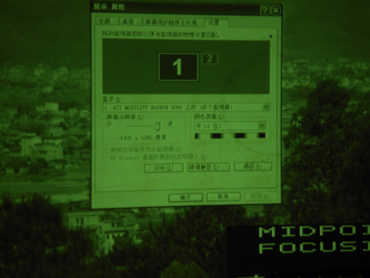

808S used for testing the lens with P19LCP07 + HD10

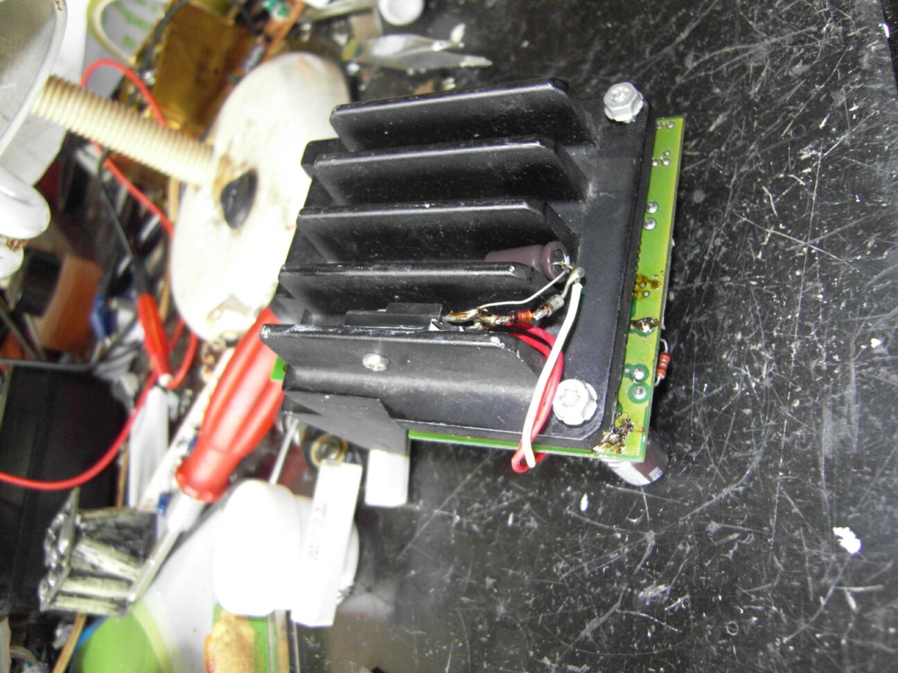

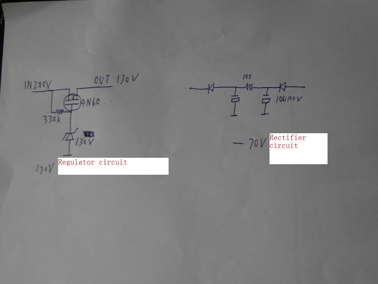

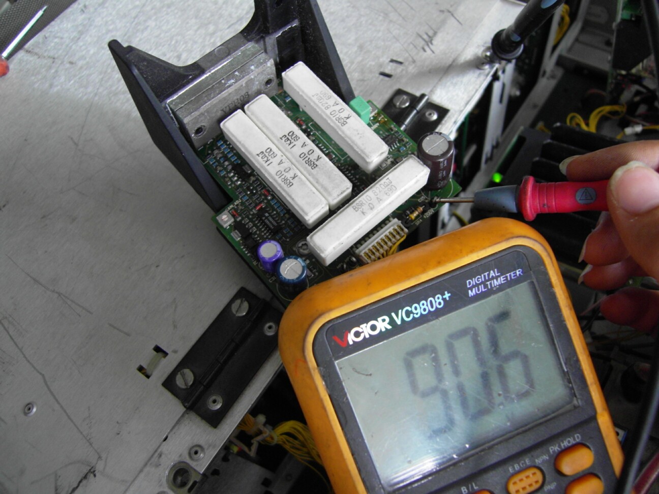

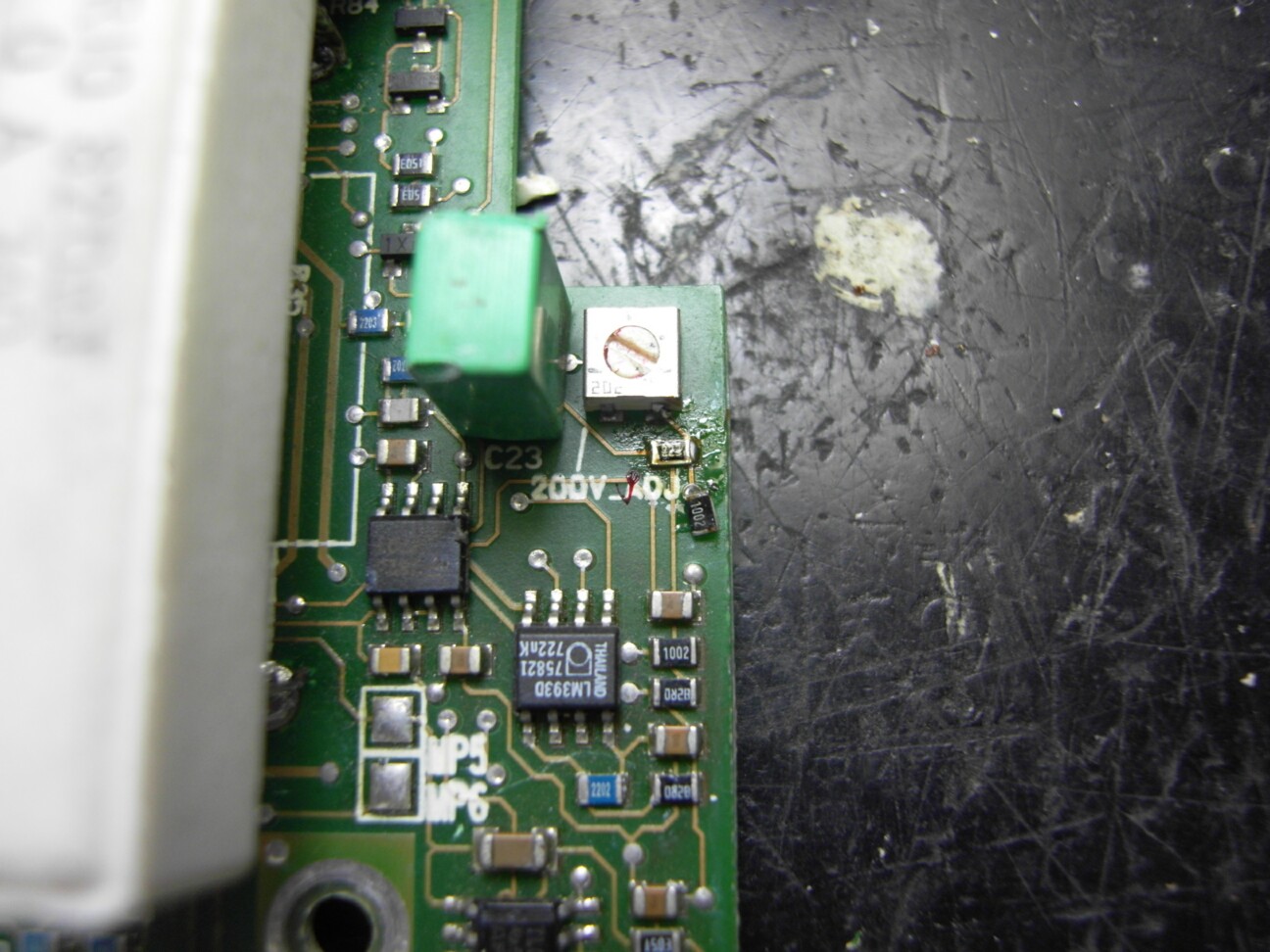

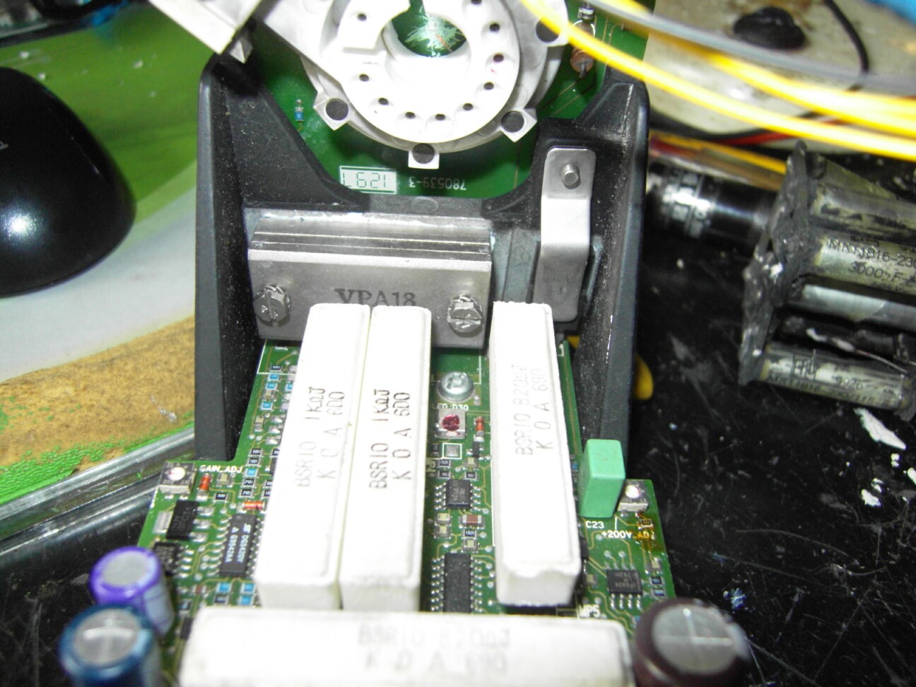

VPH08 and VPA15 there is a big difference between the input voltage is different, VPH08 is connected to 200V voltage is 90V voltage VPA15 Barco S tail board has a voltage regulator circuit 200V-ADJ potentiometer near obtain VPA15 need to change the required 90V voltage. First, modify the circuit board R92 resistor value, this adjustment potentiometer resistor 200V side is easy to find, is a 1002 chip resistor is 10K. Replaced with a 223 chip resistors, and the original 200V potentiometer clockwise transferred obtained at the end of output voltage of 90V, but this circuit can not withstand the high voltage difference, that is, the input can easily burn 90V 200V output voltage regulation components. So I created a simple step-down circuit, using a reference picture 130V regulator and a common 4N60 FET available and a 330K resistor, capacitor can do without it is just to make the output voltage ripple is smaller settings.
Replacement Chip Resistor location

IC supply voltage test points

The method is the same installation VPA18

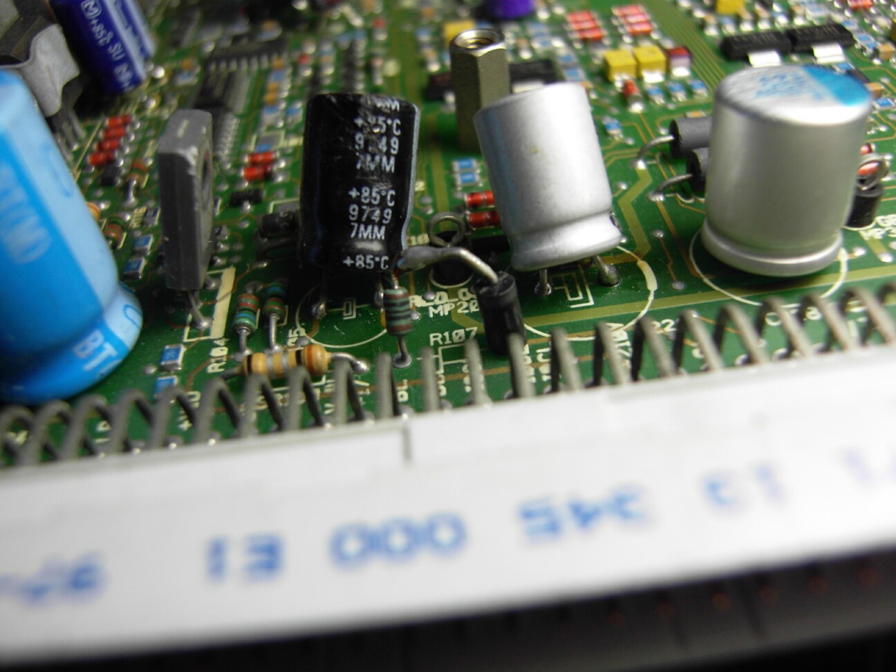

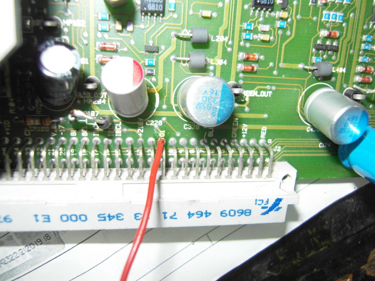

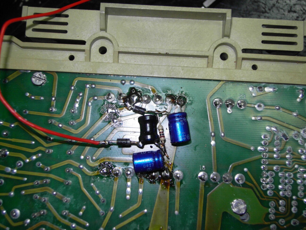

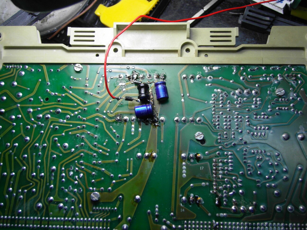

Normal test machine after installation, but the lower half of the electricity VPA15 k resulting voltage is too low. The whole picture becomes very bright bottom ash can not be extinguished, the cathode voltage is too low will cause the image brightness at the trailing issue. This problem is solved in order to achieve practical state of the machine, in fact, to provide an approximately-70V G1 voltage can solve this problem. First find the location of the power 30V rectifier circuit a simple one-way diode and capacitor Jieshangqu you can get more negative about 70V, I use a filter can make DC more pure. G1 requires little current, no special requirements just diode switching power supply for the job if the recommended RF4007. Connected with a line connected to the rear side of the G1 input board feet, in order not to affect the G1 shutdown circuit must eliminate highlights position in the R107 series with a diode. As long as this is the rectifying diode can be, must not mistake the other polarity is not required.
Modify the position of the power board
 Filesize:  307.82 KB
 Viewed:  5776 Time(s)
 Filesize:  283.42 KB
The position of the access-70V R762720
 Filesize:  261.38 KB
Intrusion prevention-70V diode
 Filesize:  194.54 KB
Schematics produced
