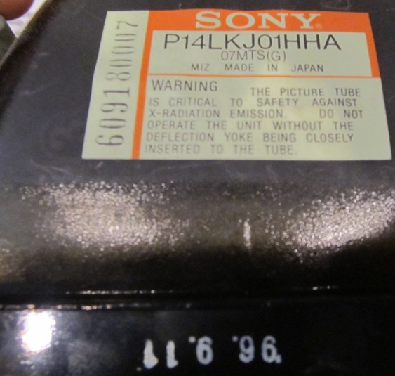

Posted: Sat Jun 08, 2013 2:35 pm    Post subject:
The 07MTS came right after the 07MS (I think) and were used in the late model ECP4500s. Here is a link to a thread where Curt discussed this all a little (as well as softness issues). I actually bought the machine mentioned in that thread. Anyway, below is a picture of the tube in question and it shows that the 07MTS (late 07MS) tubes ARE P14 tubes.
Curt points out that getting the D50 tubes into a ECP can't be done b/c the metal housing bonded to the tube faces are different. Removing the metal rings are what I want to try to do chemically. Curt tried mechanically and came to the conclusion it was a futile effort.
cheers,
Matt
Picture showing a P14 tube installed in an ECP - I believe at the factory. It is an 07MTS which was a late improvement to the 07MS and uses same form factor and pins. Perhaps a different phosphor mix or electrode material, etc.

I thought certain ecps was listed with that tube I wonder if it would work in mine(I would love the extra lumens)
