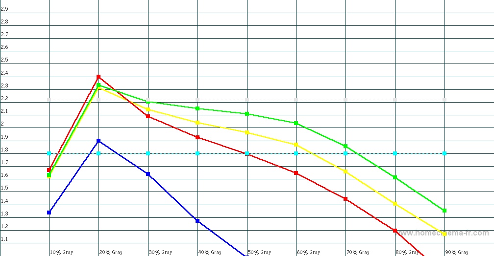

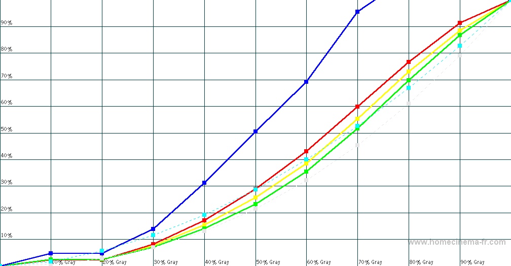

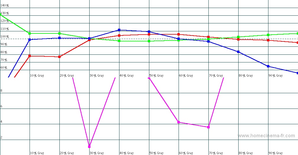

I performed Kal's greyscale for dummies calibration last night. I'm trying to interpurt my results and make adjustments. My results are attached. I had to defocus the blue too much to make the blue levels get closeer to the red and green levels. I also ran out of RGB Highend adjustment on the blue and still couldn't get the 70 IRE levels balanced. I was about 100% on Red and Green but 60% or so on Blue.
I have a gamma x attached to the computer feed from my HDFury. I turned the Gamma X all the way down. Based on the results it doesn't even look like boosting the gamma would help. The gamma is low on most IRE levels. Question is how should I fix these issues? I was playing around with the G2 levels and I don't think I have that right. Looks like I need to turn up the Blue G2? Is this a good assesment?
Also, when adjusting the G2, I ignored the Barco 808 graphics RGB lights on the green and instead try to get the green, blue, and red to all light up at the same time when increasing the brightness. Contrast was set at 60%. I had to turn the green g2 down and the green tube face is still lite up when the red and blue are off. I see the whole face of the green phoshere lite up with strange diagonal lines in all directions. These lines never show up on the screen but I don't get the same effect on the blue and red. Is this normal? I'm guessing my issues with calibration are impoper G2 levels. Looking for recommendations for adjustments based on the attached graphs
I'm also using a Monaco Optix XR Pro meter, Color HCFR and AVH CD

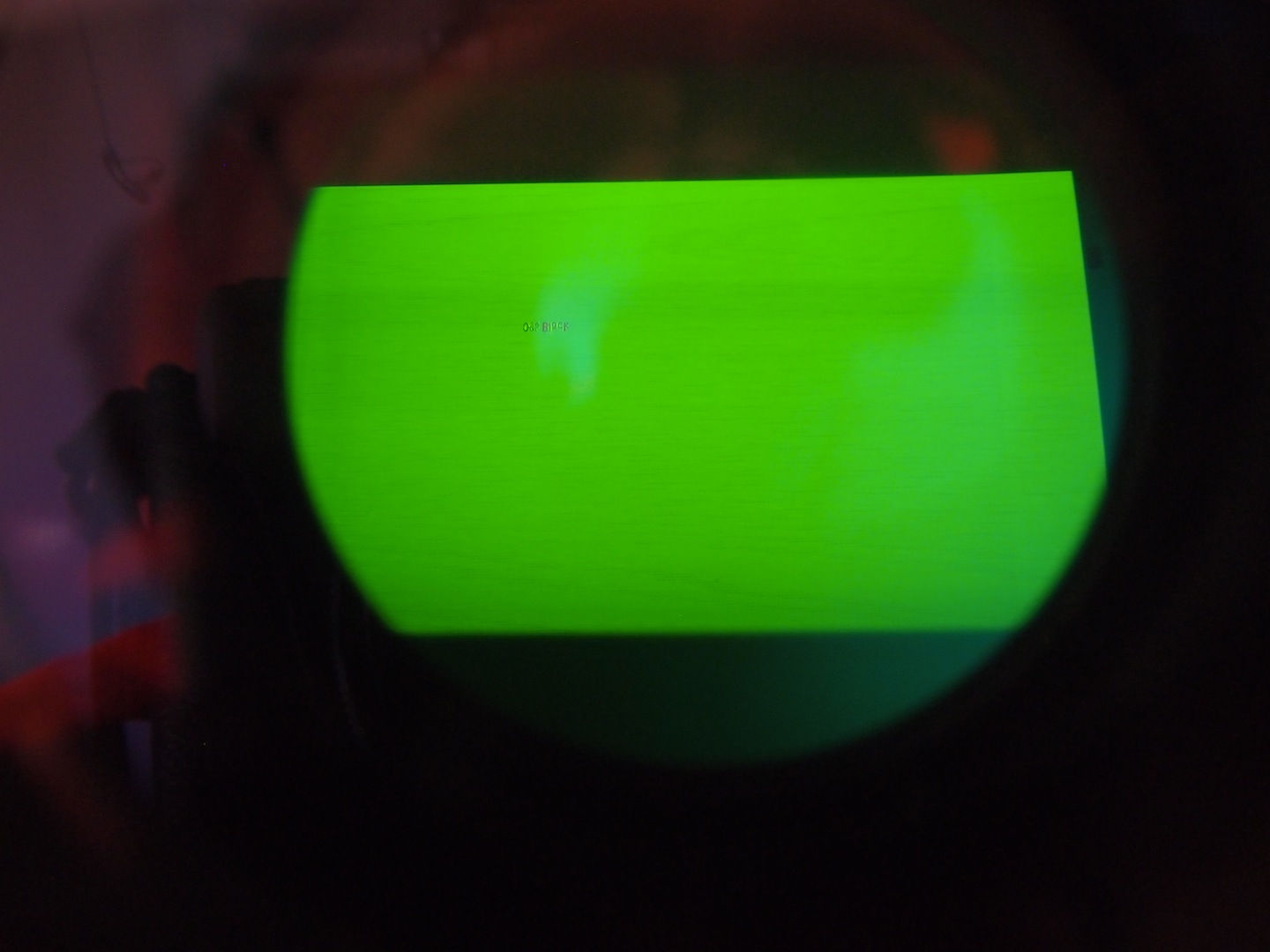

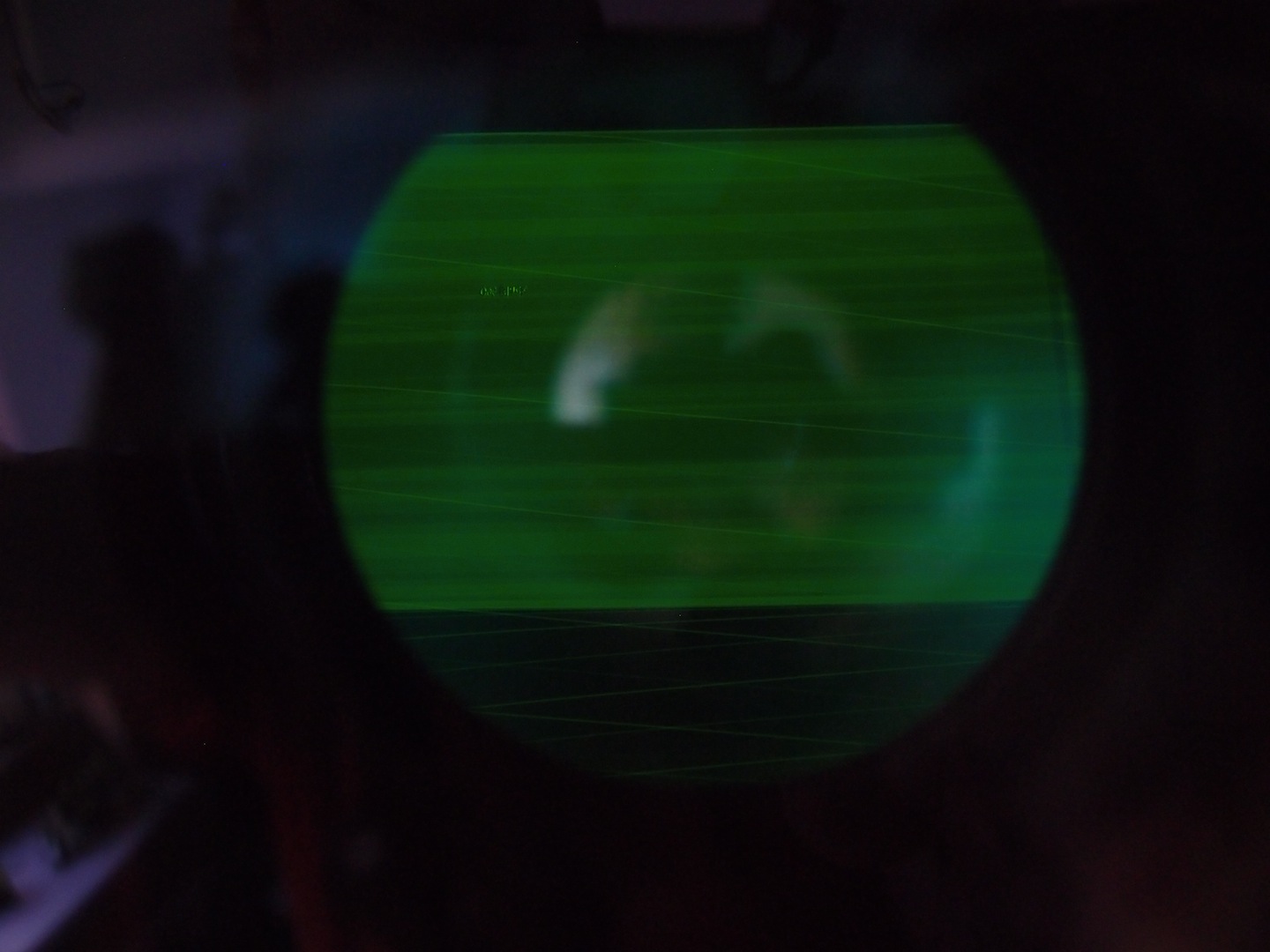

I turned the g2 down further on the green. When showing 0 IRE, The lines went away and raster disappeared unless I blast the brightness to 100% and it not as noticeable as what it once was. See attached photos for before and after G2 adjustment. When I turned the g2 on the green down so it is barely lite, the blue and red are super bright at 100% brightness. This seems to indicate to me that my g2's are way out of adjustment. You can't trust the Barco LED's!! Does this make sense? Sounds like I need to lower the green, blue, and red with the blue and red turned down much more than the green. Is there a recommended brightness and contrast settings when using the 0 IRE to adjust the G2 just until you can see the rasters?
I don't think I should defocus the blue anymore. I actually need to focus it. It's so unfocused that the width of a blue line that is normally 1/4" wide is about 3/4" wide. I can't converge the image well with the blue so out of focus. I get several blue highlights popping out when watching an image.
Green tube after G2 adjustment, g2 fully lowered, 100% brightness with 0 IRE

Green tube before G2 adjustment, 32% brightness with 0 IRE.

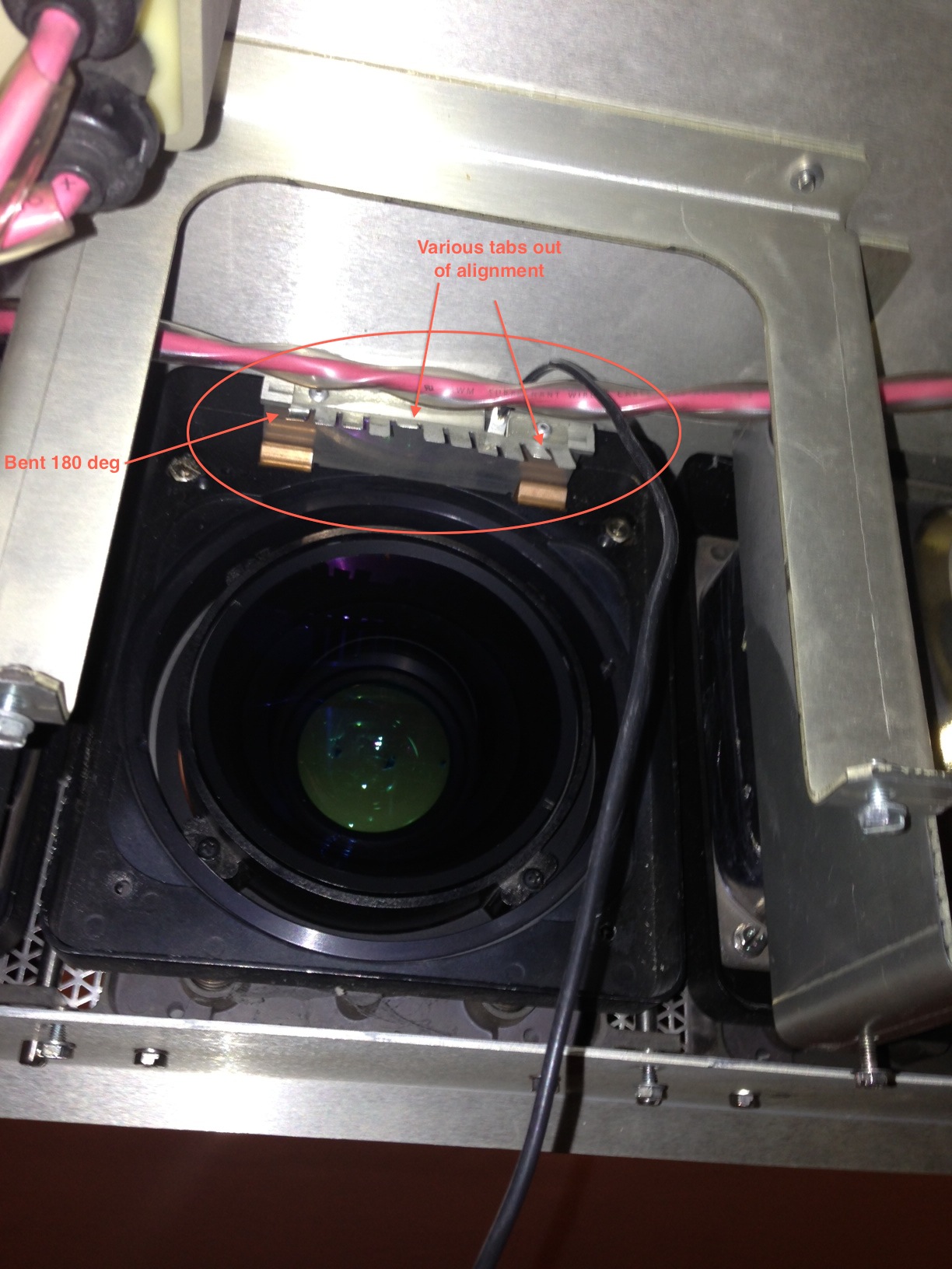

So... I've been living with the poor greyscale for quite some time. I'm planning to see Craig this week to test with the CR7000 as well as do a few other things for me. Anyhow, after removing the tube, I notice the metal fingered clip which rests on the bowl of the CRT is totally bent (see photo). The finger on the far left is totally bent 180 degrees. The rest of them don't align and are bent at various angles. How important is it that these rest on the back bowl of the CRT? Could this be causing my issues?

That grounded clamp is the aquadag of the picture tube ( drives the electrostatic fields away ) and should have nothing to do with your problem.
Craig rocks and will solve your issue.
By the way, to prevent scratching the lenses or tube faces, it is always safer to remove the lenses before removing the tubes.
Or at least extend the back barrel of the lens with the center focus knob to its maximum.
Just a hint...
