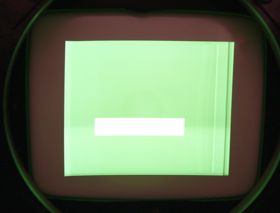

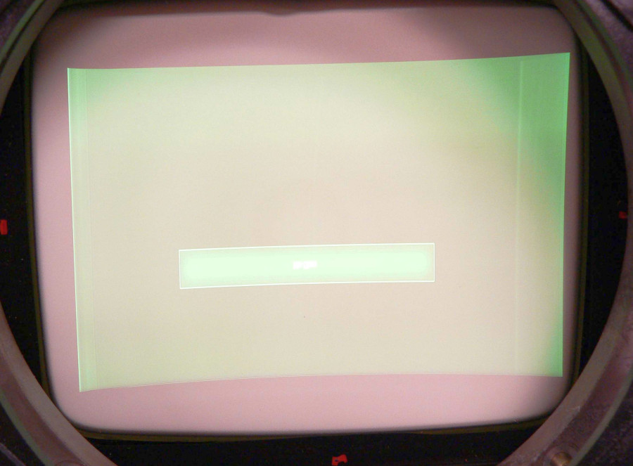

In 720p, the amplitude adjustment hits a wall at -70%. Nothing above that changes the width at all (including the internal width pot). At 1080i, it hits the wall at +30%, but it has plenty of width. I've attached images showing the maximum raster sizes for 1080i, and 720p. I also tried a PC at 800x600, 1024x768, and 1280x1024. 800x600 is the only one that comes close to filling the screen, and even that's borderline.

Ok, just to be clear, those pictures are of the raster, not the active video (it looks bright because of the exposure). The width pot has no effect beyond what I can get through the menu. I can't get an acceptable picture at 720p.
I just turned it back on to check something, and it's worse than before. Now at 720p the menu width has no effect at all, and it only works in the bottom 10% at 1080i. I pulled the power supply, and there are some leaking caps in there. Hopefully that will take care of it. I'll post back either way.

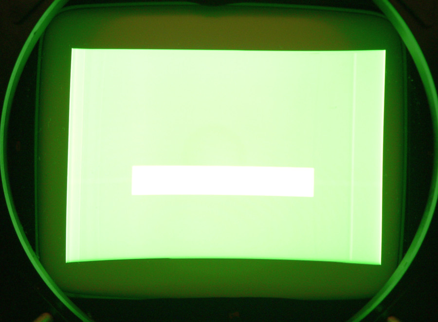

Things are looking a lot better after replacing the power supply caps. I can now get a good sized raster at 720p.
There were a lot of leaking caps in the power supply (most of them). They're good quality (Rubycon) caps, and they haven't lead a hard life in this particular projector. I guess NEC bought a bad batch of caps in the early 90's.
I strongly advise checking for leaking caps on any NEC from this era before powering it up. I almost killed the CRTs the first time I powered it up because it lost vertical deflection, and didn't go into protection. Fortunately, I pulled the plug before a line was burned in the CRTs.
I haven't replaced the big 200v caps on the deflection board. They weren't leaking, and they're a different type so I suspect they will be fine.

Posted: Sun May 05, 2013 11:37 am    Post subject:
Looks like wrapping there...
andy2000
Joined: 03 May 2013
Posts: 32
Posted: Sun May 05, 2013 3:02 pm    Post subject:
No, the lines near the edges are just the edges of the active video. I can move the image around within the raster with no problems.
Posted: Sun May 05, 2013 9:46 pm    Post subject:
Youre way too large for a PG there in my opinion.

I know, I was illustrating that the maximum raster size is now more than big enough.

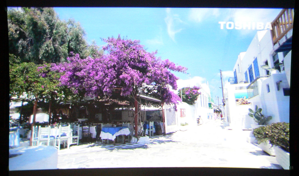

Here's a quick screen shot after doing a rough convergence. Sorry, it's not the best photo (over exposed). The only problem is that now my Epson 8500UB in the main setup doesn't look as good as it did last week...
If anyone has an extra video input board, I would like to add it for the rare occasion when I might want to give it composite, or S-video directly.
Also, I'm using a Sony PC-1271 switcher with it. I have a Moome DVI card, 3 RGB cards, and an IFB-3000 line doubler in it. So far, I haven't been able to get the line doubler to work at all. It's installed in slots 5-8, the fan runs, and the lights come on when one of its inputs is selected, but the projector doesn't even get sync. Are there any tricks to making an IFB-3000 work? Does anyone have a service, or operating manual for it?
