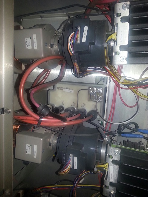

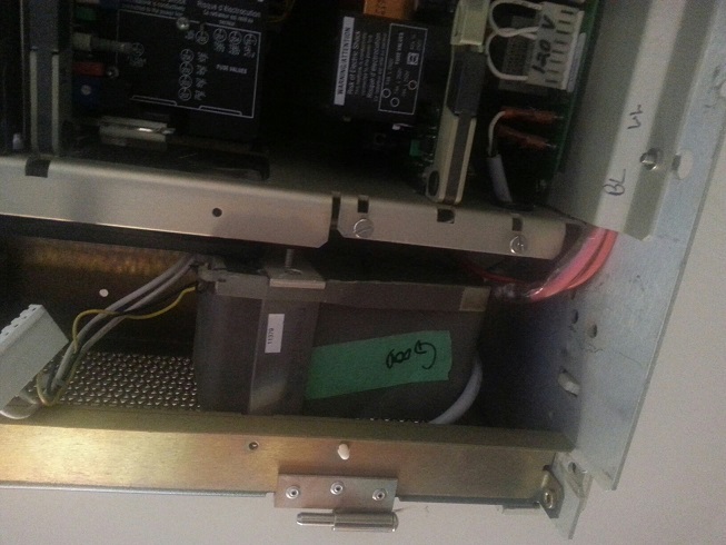

Adding pics to make sure I'm looking at the right things. The pj is ceiling mounted making oh so much fun...
The grey thing with "good" on it is the quadrupiler? That's what I've figured out from the info on your site, I think...

Posted: Sun Apr 21, 2013 4:27 pm    Post subject:
Yes, that's it. Make sure you unsolder both points on the white wire on the splitter. DO NOT cut it. It's Teflon coated, and is a bitch to splice.
