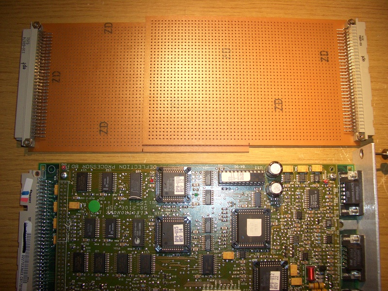

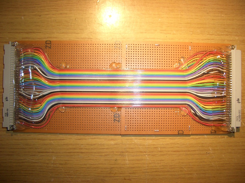

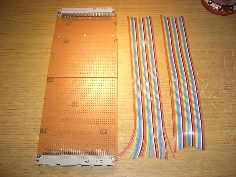

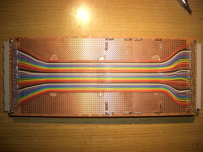

It is possible to build them long enough without need for expensive boards:
