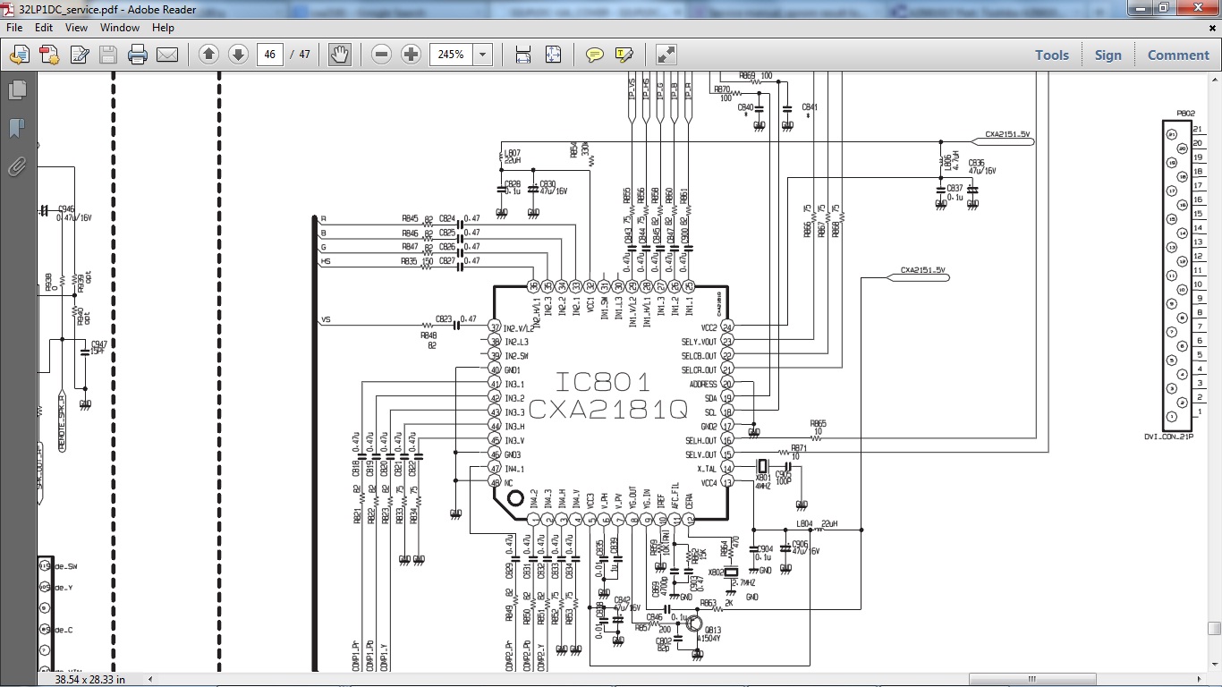

Posted: Sat Mar 09, 2013 2:38 pm    Post subject:

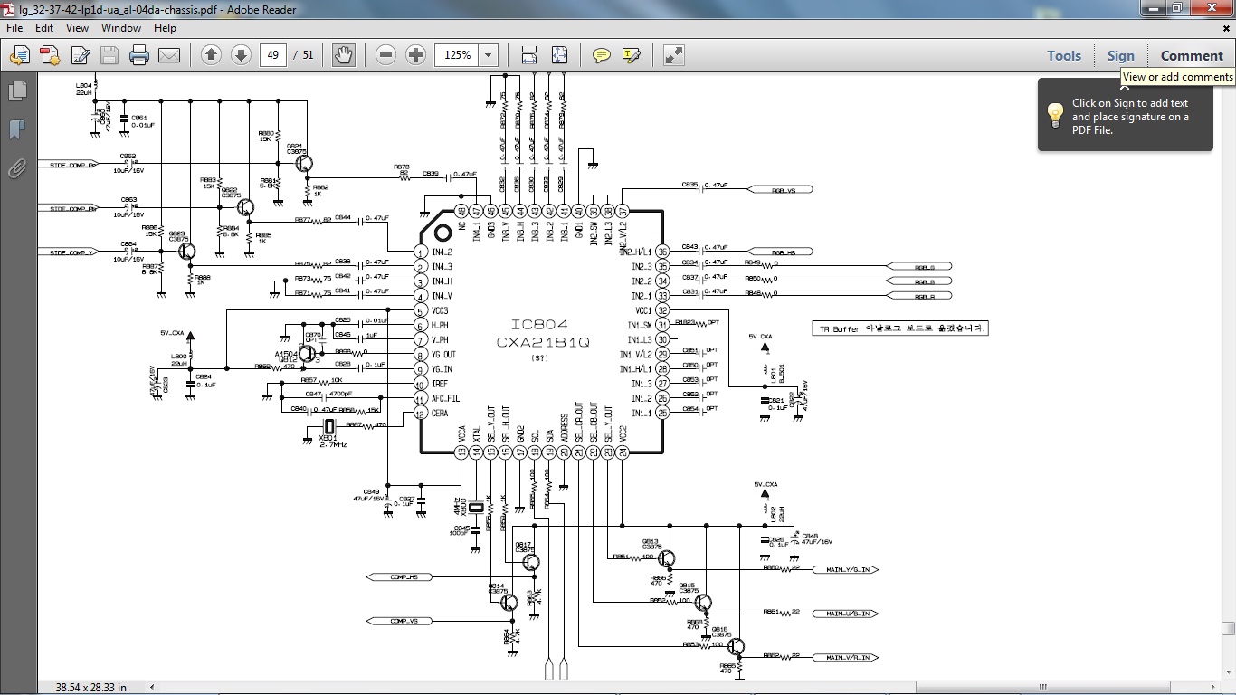

Posted: Sat Mar 09, 2013 3:06 pm    Post subject:
Another version. Note orientation.
 Filesize:  221.38 KB
 Viewed:  12 Time(s)
barclay66
Joined: 27 Jun 2011
Posts: 1304
Posted: Sat Mar 09, 2013 4:00 pm    Post subject:
OK, so basically it is an input selector (4 inputs) and sync processng circuit, controlled via I2C bus...
