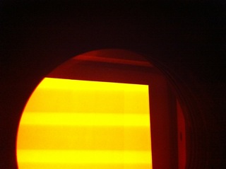

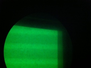

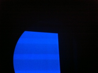

I'm setting up a Marquee 9500LC with HT10GT30 lenses. It looks like the liquid in the green lens coupling has gone cloudy. I did mechanical set up, geometry and convergence and it looked fine. About 2 hours later I went back and the image looked totally fuzzy. The green lens looks cloudy, red and blue are fine - see photos. How difficult is this to repair? Do I need to replace the lens?

The Glycol wouldn't all of a sudden become cloudy over a period of 2 hours would it?
Is this an Electromagnetic focus issue? Or did the lens itself have some fluid in it which steamed up the lens internally?
I think you need to take the lens off and see whether it's the the lens itself, the Glycol, or the tube face
sumac
Joined: 23 May 2012
Posts: 18
Posted: Thu Mar 14, 2013 12:55 pm    Post subject:
Yes, the glycol did turn cloudy over a few hours. So we had it changed but now I'm face with another problem. The tubes seem to be really bright and black is a light grey colour but if I turn down the brightness or adjust the G2 I lose all the detail in the dark areas. Colours are also not right.
