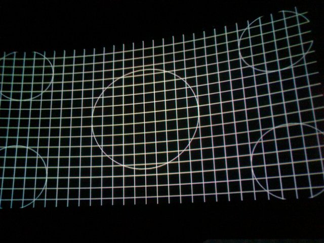

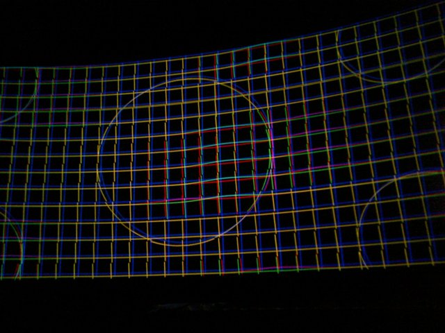

Dear all,
this is about my 10PG, where all boards had been swapped with a 6PGplus. Only the point convergence board is the original one as the donating unit did not have one. The 10PGplus is projecting on a curved screen for a good 2000 h now. Most of the time excessive point convergence correction was applied to green and red. Due to the curved picture geometry and the projector position not beeing optimal I used a compromise resulting in mediocre optical focus throughout the whole screen at maxed out bow and pin balance settings. Point convergence was abused to further extend the downward bow setting.
Those of you who don't go curved probably can't follow and this not about "With good mechanical alignment only very minor electronic correction needs to be applied". I know that.

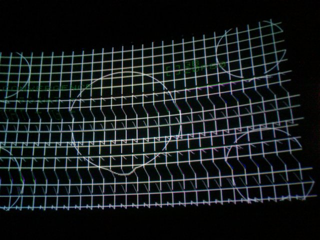

Since a couple of weeks the picture is flipping when point settings are touched (see attached pic). I found a similar picture on avs also related to excessive point correction. With the point board disabled or settings normalized the picture is stable. This sensitivity of point correction seems to be getting worse. Unfortunately it is not reversible so that now, even at very minor point correction, the flipping occurs. With a cold machine directly after start up it could be okay but after warm up point board is unusable. The system board cage does not have an extra fan (yet) and gets a little warm so I figure the chips inside are really hot.
Okay, so I installed the point board from my spare 10PG unit. Two years ago or so the whole projector had been working okay. But the 10PGplus with the swapped point board still is failing. The picture disturbance looks quite different but with the point board disabled everything is okay again.
So I guess that a broken (overheated abused) original point convergence board ist not the only issue. Right? Of course both point boards could be broken and having different defects. However, I think this is rather unlikely and some other electronics went bad too. None of the point boards has visual defects (leaks) or burn smell.
Any advice where else to look for?
original point board with awkward picture distortion, bended zones, flipping when settings are changed

Posted: Fri Mar 01, 2013 2:01 pm    Post subject:
Nice screen! Smile
LEaking caps on the point board, and I'll bet the other boards in teh CPU cage aren't far behind. Chances are there's some traces on the point board that have been eaten away. THere's about a 50% chance you can fix it if you're good at soldering. I personally won't look at it as there's no guarantee that the board won't fail again shortly.
I think I do have a good board here that I'd sell at $100 plus shipping if you can't get that one going.

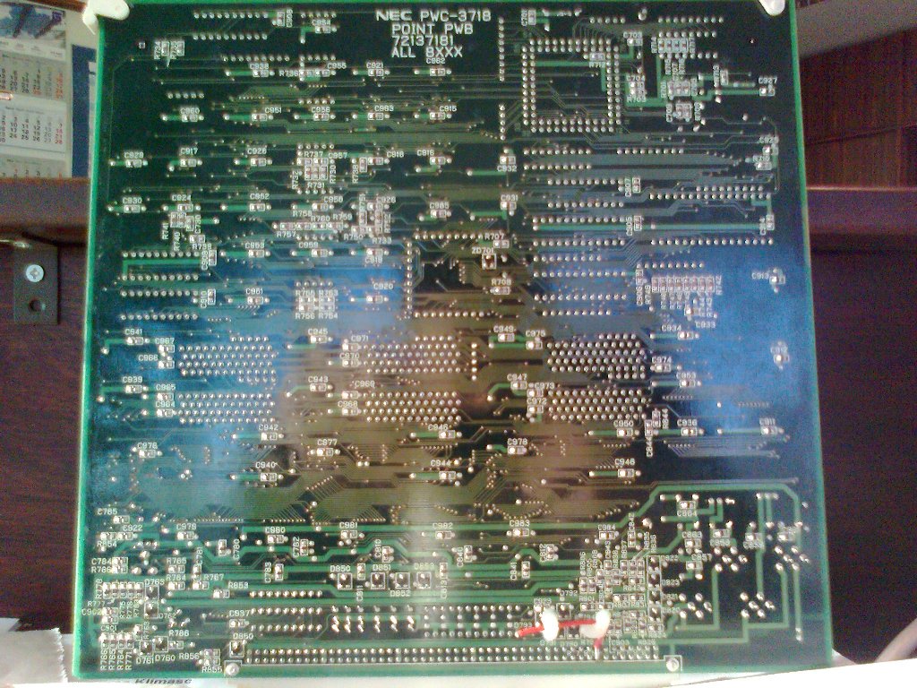

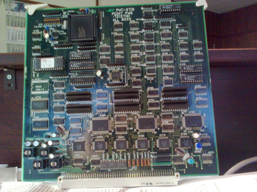

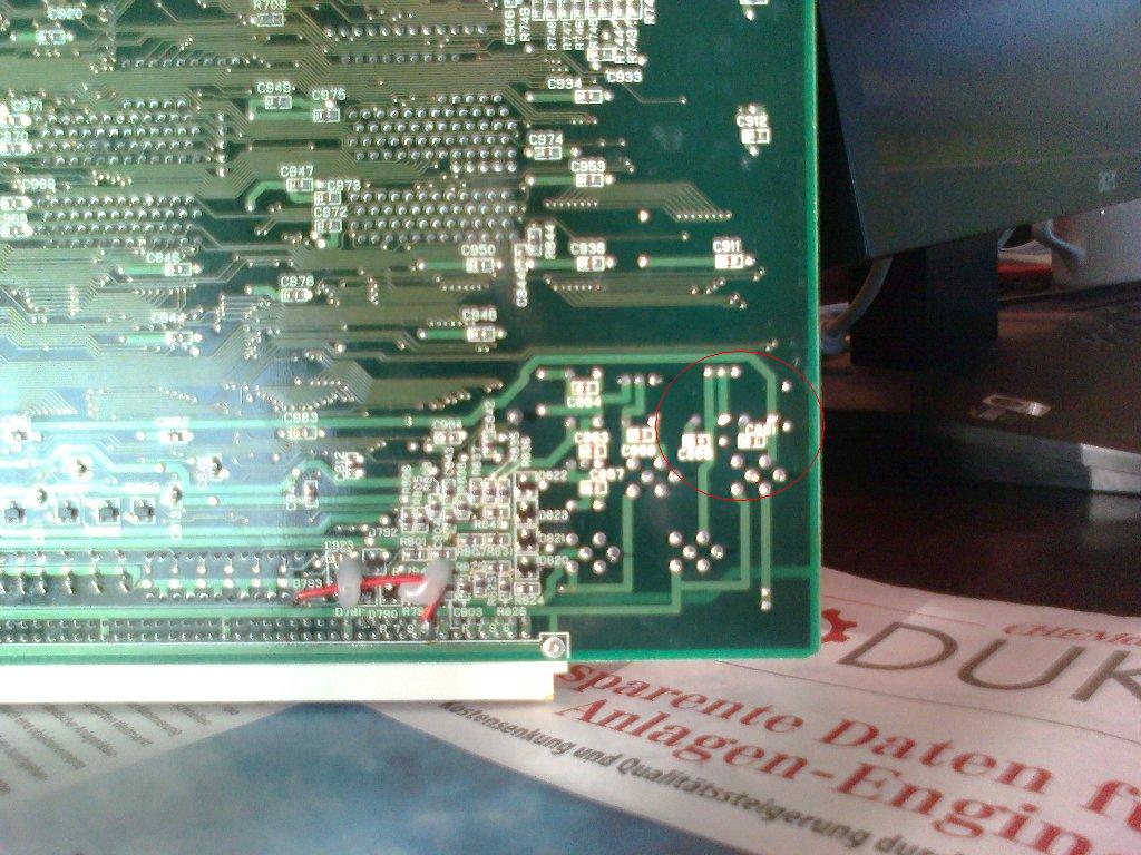

Guy,

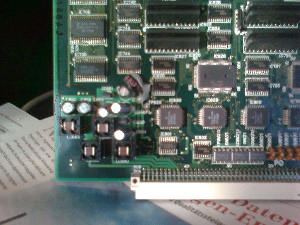

this is my PWC-3718. In zhe close up pics I have circled the two caps that were a little wet. On the front they are labled C862 and C856, on the back that's C861 and C859.
At least those two seem to be doable, even for a double lefty like me. Would be good to have a parts list for the whole board though.

Posted: Tue Mar 05, 2013 11:18 am    Post subject:
As you can see only a dozen electrolytics caps on the board, no list needed, just replace the caps with a same new one. On this board it is highly suggested that cut the bad caps off and solder the new caps on the old caps' legs, because the 4 layer PCB is very sensitive and hard to solder without a good equipment.
