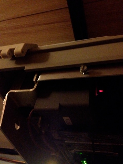

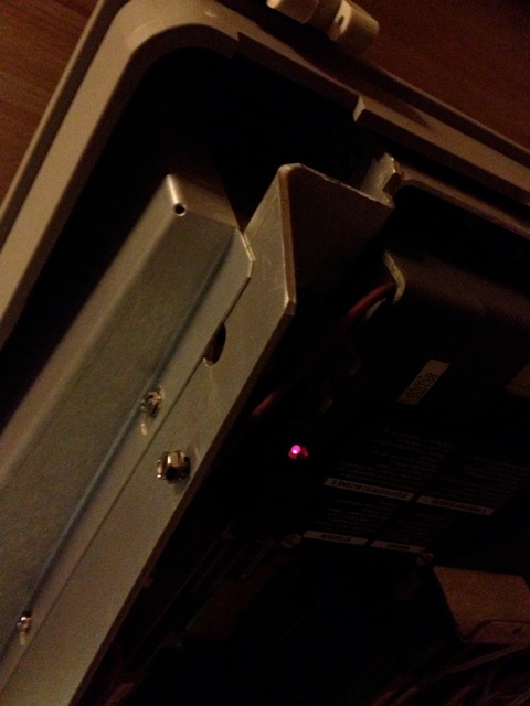

Yesterday, when I was running the 1208 (S/E 1998) the picture suddenly disappeared ... there has earliere been some warnings where the picture looked like collapsing horisontly just for a split second and then recovered.
When the picture disapeared the pitch (noice) from the PS (powersupply) changed.
Now, the Barco turns on, all lights are green and fans are running but no picture. After approx 5 secound 2 lights turn on red on the EHT board (pictures attached) and the pitch from the PS changes (sounds more relaxed). Everything else looks normal and all other lights are green. (Changing source don't help)
Any ideas are much appriciated.
Flemming, Denmark

Posted: Mon Feb 04, 2013 7:32 pm    Post subject:
Bad HV quadrupler, EHT board or HV splitter. No way to tell which one is bad without substitution. If you have access to another Barco you can swap the parts to narrow it down, or send them to me for testing, repair or replacement.
