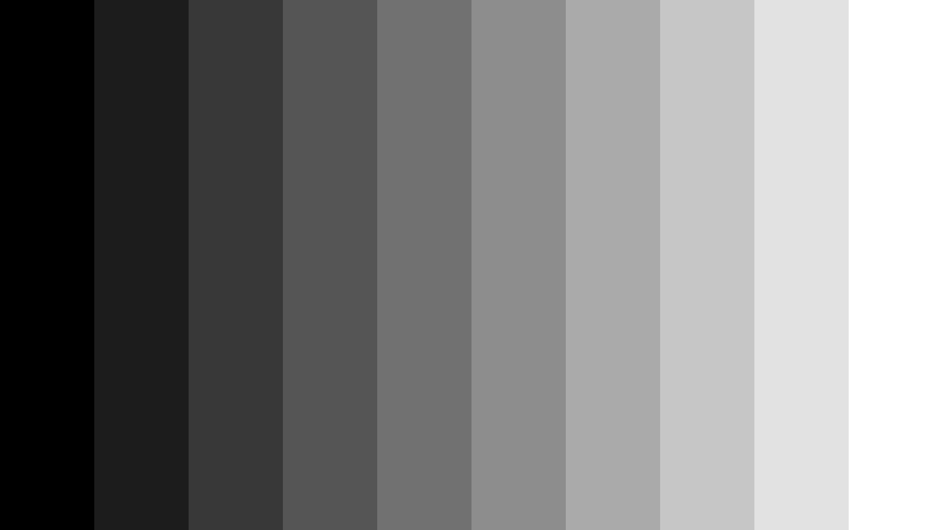

Posted: Sun Feb 03, 2013 9:21 pm    Post subject:
Use this Colorbar for the set up procedure . Use a Lap top or PC with the cable Mike showed.
