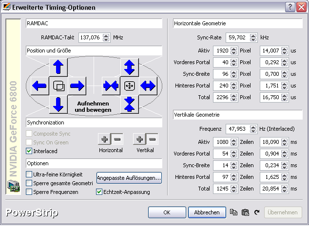

video card is a Geforce 6800 AGP
driver version: 93.71
Windows XP MCE (should be identical to XP Pro wrt video)
Asus A8V mainboard
AMD Athlon X2 3800+ running at 2.65 GHz
I never had ANY success with custom timings in the Nvidia display driver, so I always stuck with Powerstrip.
In Powerstrip I was now able to use the exact same timings I used for VGA out for DVI out into the Moome ISS-HD.
I did proceed as follows:
in powerstrip, go to advanced timings, custom resolutions, add settings for your custom resolution on the right.
in my case:
1920 1080
60 48
40 54
96 14
240 97
negative negative
interlaced
any
then click add resolution
The new resolution should now be added under custom resolutions on the left.
Select it there and apply.
you should now be back to the custom timings panel.
Apply the final tweaks there.
in my case the settings are as follows:
NOTE: Updated timings available on the next page
powerstrip timings for 1080i96
 Filesize:  24.21 KB
 Viewed:  19328 Time(s)

Mark_A_W
Joined: 15 Mar 2006
Posts: 3068
Posted: Sun Dec 31, 2006 11:26 am    Post subject:
My setup is much the same, but the timings which work fine for VGA give me 540p for interlaced res's, and corrupt windows fonts.
I'll try newer drivers.
BTW, you have big porches, what happens if you reduce them?
Happy New Year!
kschmit2
Posts: 1141
Location: Heidelberg, Germany
Posted: Sun Dec 31, 2006 2:12 pm    Post subject:
Actually I'm happy I found these timings that allow me to perfectly fit the image in my screen with zero overscan.
any lower porches didn't allow me to do that, so I'll leave it at that Smile
