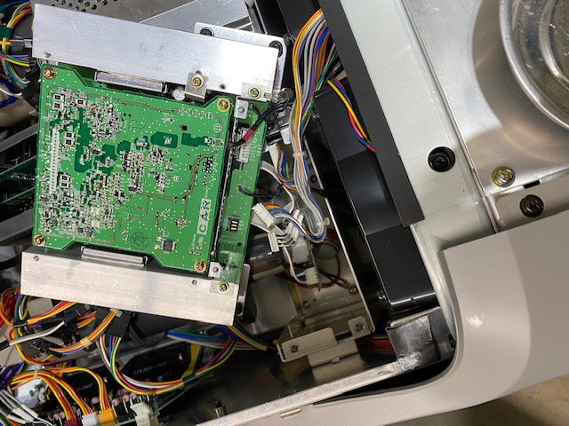

Curt I had disconnected the red and green metal neck board boxes yesterday but did not power the projector. After your suggestion I started putting everything back together. however when I was reconnecting the CAR card I could not find the male board connector apparently it came off the board with the female connector as shown in the attached photo It is the 1-671-252-11 connector we are going to try and solder it back on the board Could this be my problem?

helfriwj
Joined: 29 Oct 2006
Posts: 51
Location: Pittsburgh,PA
Posted: Wed Jan 11, 2023 2:11 am    Post subject:
If you look at the picture it is the connector with the multi colored wires. we did solder the connector back to the board and fired the projector with all the neck boards attached. Only the green tube fired full brightness. Removed the green neck board blue tube very dim. Removed the blue neck board red tube very dim. any suggestions Thanks
Posted: Wed Jan 11, 2023 2:51 am    Post subject:
Sorry, no idea at this point. I am out of CRT projectors, and have no parts or test chassis left, sorry!
