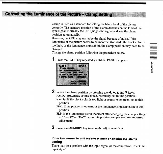

Could it be a clamp setting?

I'm not sure what that means or how to check. I tried googling it.
Posted: Sat Jan 12, 2013 10:54 pm    Post subject:
In the menu, there's a video clamp setting. You can cycle through ( if I remember ) 3 settings.
Page 87 (E) of the install manual:
