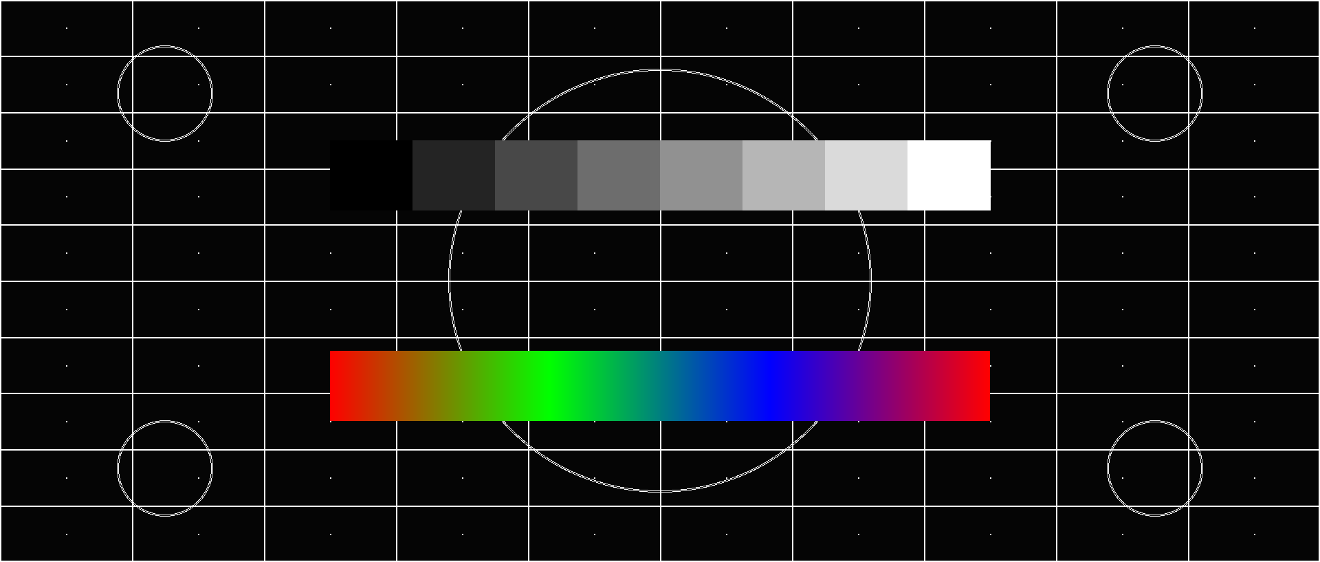

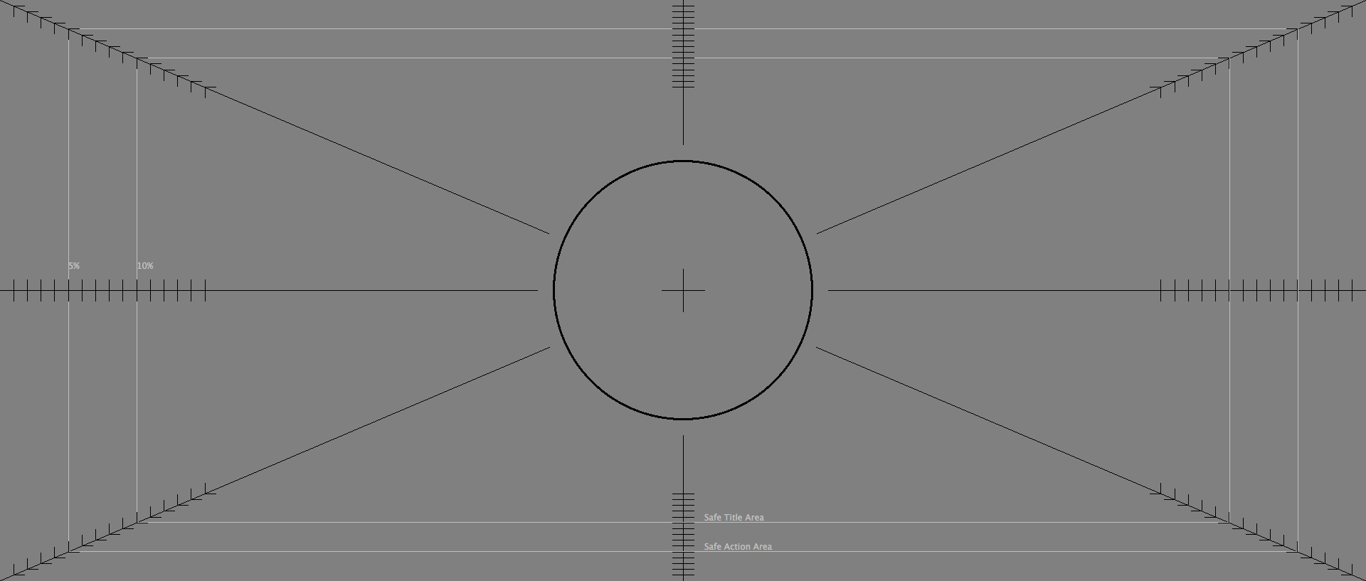

First look at the actual Image. you'll need a pattern that you can see the overscan.
You might be cutting off some of the image.
Here is a 2.35 aspect Image of the overscan pattern
These will also help you set up geometry a little for 2.35.
I have some more if you want them.

That overscan shot shows only up til 10 % on width and only up til first visable line upwards. Took a screenshot showing it. Still looks cropped some how, yes?
Posted: Sat Jan 05, 2013 2:26 am    Post subject:
Yes very cropped, now do it with short retrace.

Hi again and thanks for all the help. It's working now. Both your images are showing correctly now and I'm using 1920x816@72 Hz. Will write this down for futhure references. Retrate is set to Long and total pixel was reduces to 2460 and then it seemed to work.
