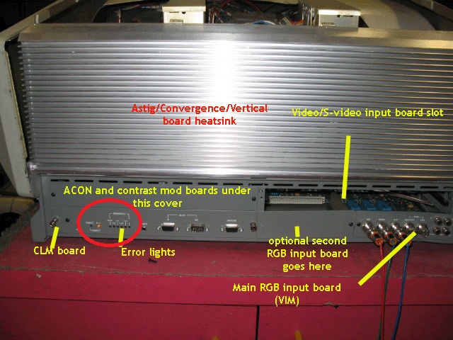

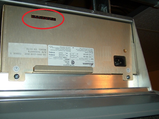

in order to power on/off You'll need to keep pressed the "Power" button on the internal/external remote for some seconds.
Check the LEDs on the LVPS. They'll indicate if a supply voltage is missing.
And check the error LEDs on the CLM.
Please report back on Your findings.
Regards,
barclay66
P.S.: The LVPS picture is from the AVS Forum (member: Energeezer), the back side picture is from here (member: Nashou66)
