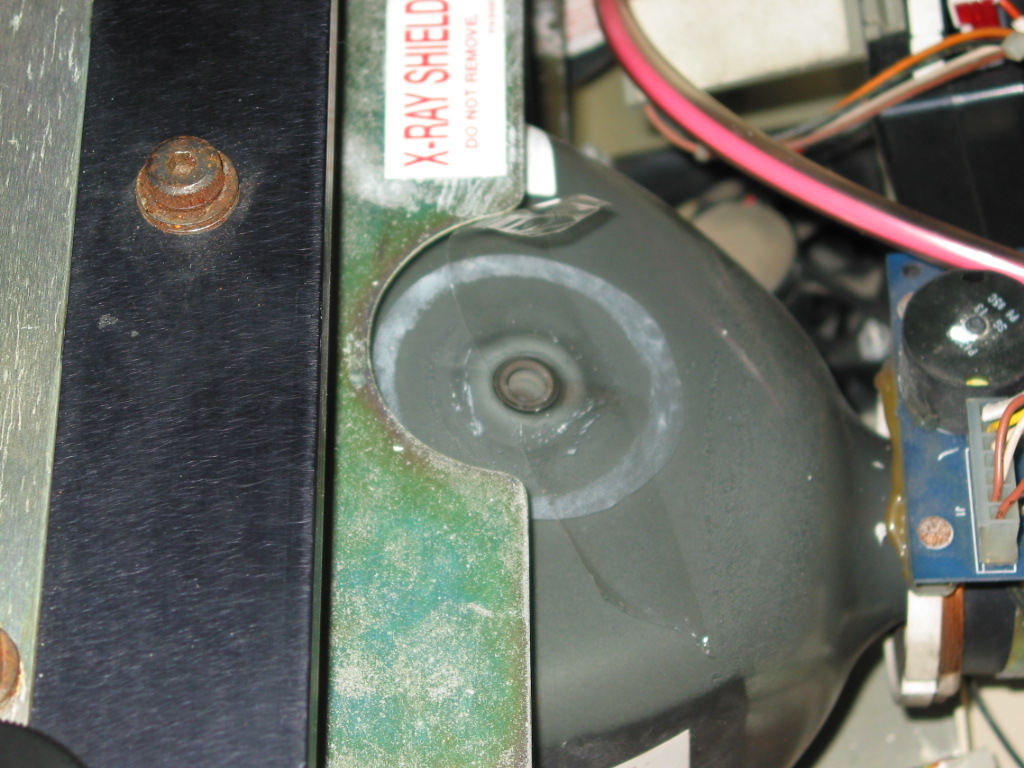

Posted: Tue Dec 18, 2012 5:08 pm    Post subject:
Here. Have an in focus picture Wink

dvh99
Joined: 25 Dec 2009
Posts: 2158
Location: nederland
Posted: Tue Dec 18, 2012 5:53 pm    Post subject:
i was focussing on the towel Twisted Evil .
