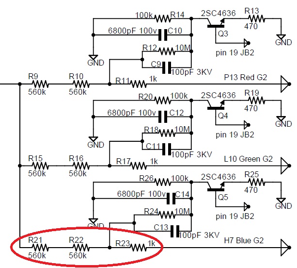

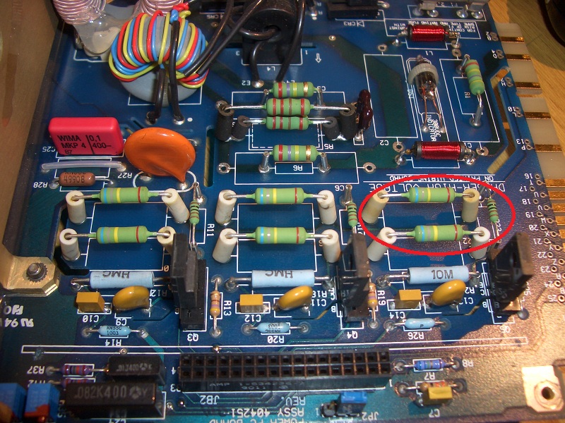

barclay66
Joined: 27 Jun 2011
Posts: 1304
Posted: Wed Dec 19, 2012 3:29 pm    Post subject:
If only the blue G2 line is dead I would first check the resistors R21, R22 and R23. I've put a red circle around them in the picture and in the schematics...

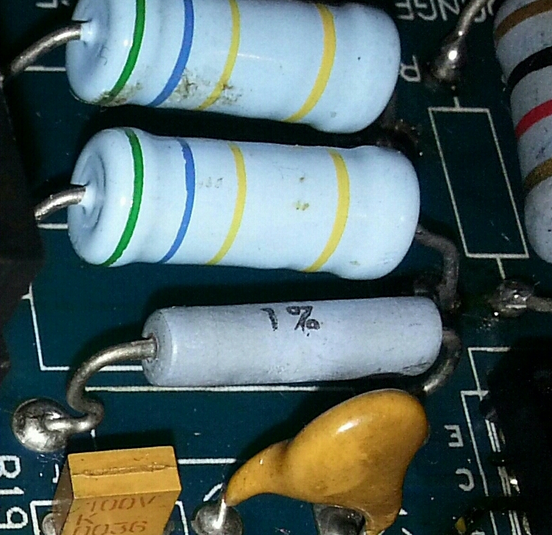

You're the guy! At first I tried changing r23 only but the blue tube still doesn't fire until I changed r21 & 22 and now the blue tube fire up!!!! Thank you!!!

hiareez, make sure the new resistors are at least 1 watt and not wire wound. That gives of magnetic field. Ceramic or Carbon Film, and even a high quality metal Film that are rated up to at least 700 volts, 1000 volts is even better.

Posted: Thu Dec 20, 2012 4:09 pm    Post subject:
Hi Nashou,
I have attached photo of new resistor.
