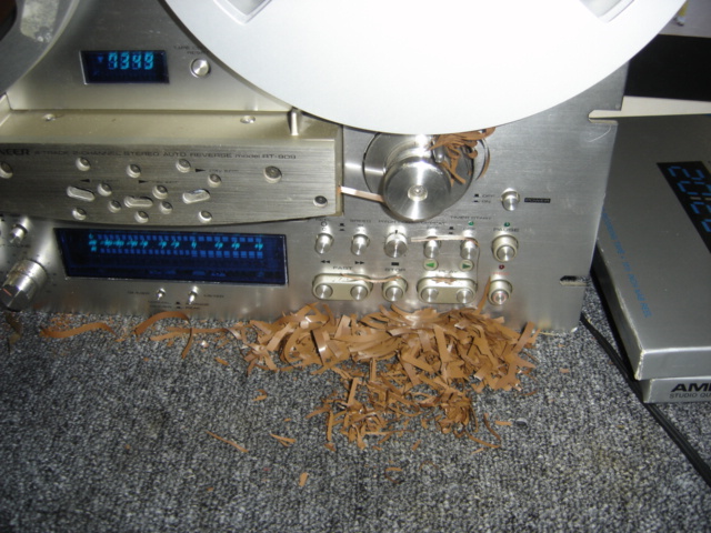

We were talking in another thread about tape baking and oxide shedding. See below. This is(was) a new old stock Ampex 20/20+ tape that I bought last weekend. Tape ran fine until about the last 1/3 of the reel, then the tape started shedding, and I decided to let it run. THe pix is about 1/2 the tape that flaked off. The binder towards the centre of the reel gave way. Almost guaranteed that tape baking will solve this. I'll find out on the weekend.

Curt, what are you using to do your baking, and how well is it working? I don't want any of my tapes to look like your picture does. That really sucks, I hope it wasn't a valuable tape!

This is what I use. Various techs have said various baking times, but I throw a tape(s) in usually for 8-12 hours, and it comes out fine. Haven't tried that tape above yet, but I will.

Which is why I don't... use an actual oven. An oven's thermostat isn't accurate, but the low radiant heat of the Ronco (or other brand) is perfect.
Trust me, it works. That 2" 24 track machine I was working on.. 1973 master tapes were being played on it, and they all needed baking. The engineer's junk test tape caused attenuated high frequencies after a mere 5 minutes of play.
