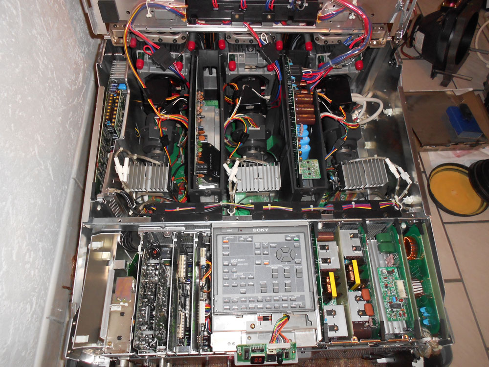

Hello, I have two SonyG70, one does not function.
The other G70 already hangs in the cinema.'Very Happy'
The SonyG70 had first Error 27 and one more Error.
(Button of the cable cover is on top on it OK)
The G70 has got afterwards the old software with G2 setting.
The original software has no manual G2 setting.
The private trader had by this contribution in the link the idea with the Zeropower-SRAM exchange and hard Reset:
http:// www.avsforum.com/t/1193903/sony-g70-error-code-23-24-29-36
I have bought this:
http:// Www.ebay.de/itm/1-St-Zeropower-SRAM-M48Z128Y-70PM1-/360423969391
Another big German trader (Josef) said of the old SRAM, is not mainly guilty in the mistake.
Can the old ZeropowerSRAM release / indicate an Error?
Is one necessary with new ZeropowerSRAM, hard Reset?
Can a Hard Reset release other mistakes? Oscilloscope and new attitude needed?
Is hard Reset 10 seconds of Reset button on the board properly press
Before the turning on already press???
Is soft reset on press button on the Remute ?
Factory Reset = Soft reset or Factory reset = Hard Reset ?
1.
I have inserted the new ZeroPowerSRAM.
2.
I have pressed the Reset counter the board and have switched on the G70 (main switch)
= First Error88
= G70 switched off and anew Reset.
= G70 switched on and no Error. Smile
= The G70 has got high voltage and has remained switched on.
= The green tube has easily shone???
= No menu Function no test picture.Neutral
3.
The G70 has high voltage, however, no menu Picture and the green tube Shining on the whole surface???
= I have operated the brightness counter
= G70 is switched off with Error36.
4.
Topically I have Error36 only with operate of the On key.
= the G70 switches off itself after 1 second with Error36.
Is it to be tested sensibly the V-Board E-Board and Y board?
Is it able to do yours the old Error 27 now is only invisible because error 36 is quicker?
Can I damage functioning E- Board / V-Boards from another G70 for test ?
Greetings
Sebastian from Dortmund
Edit 25.11.2012
I had. Always error 36, even before the SRAM replacement and hard reset
Not Error 27... The seller was on tour and knew more precisely what error was previously available.
I had no more in remembrance.
I think it was never a problem with the SRAM.

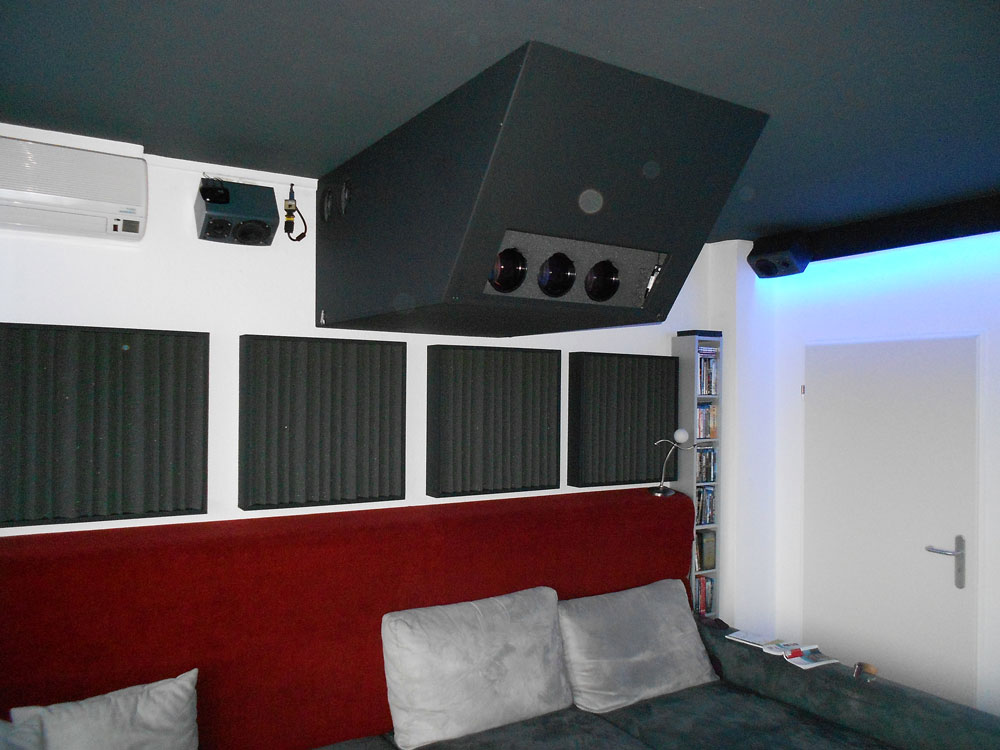

Nice room! Smile

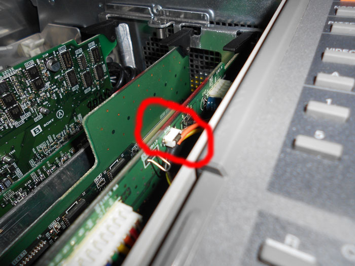

Check the V switch under the cover where the H yoke connectors are. I've never had a Ya or Yb board cause random errors, but I guess it's possible. Worst case, find another G70 to put your Ya or Yb boards into to test, or send them to me, and I can check them here. Also make sure that the focus/V board is seated correctly.

The V-button under the cover are OK, I know there can be also released Error 27.

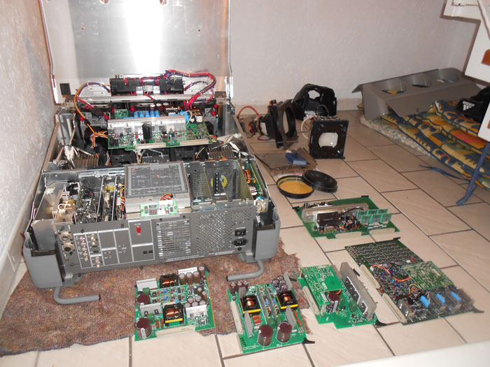

I will try to procure the G70-Boards and a Board exchange make.
Do I need for other substitute Boards oscilloscopes for the adaptation? or is this not mostly necessary?
Would you take for the test the Boards from the functioning G70 from the home cinema, or is this a risk?

There is a Barco CRT next to the Sony that's why it doesn't work! Very Happy

Curt, you will have to say whether he can try the other YA board without damage or not.

The G70 had yesterday by three days as no electricity. (3 days no standby)
1
Today I connected the G70 with the power cable into the power and turned on the big main switch on the device.
== As always, no error.
2
Then I have the G70 on switched ON button.
== All tubes have bright light on the whole area, for 5 seconds. Neutral
3
After five seconds, the G70 has automatically shuts down with error 10 .....i pressed no button...
((I had thought in the past week that the G70 finished with error when I pressed the brightness button.
That was just a coincidence ))
4
At restart, there was, as always, Error 36 after 1 second.
The same has happened in the last week once.
Co .. amazing fast ..
Whom the G70 has no electricity for several days (3 days no standby) then:
== G70 Starts with bright tubes for 5 seconds
== G70 gets from even a Error10 (no Error 36)
== Reboot comes in as only Error 36 after 1 second.
What is Error 10?
I once something moves the Y board and katte short Error .. 20 21 22 60.
but only individually never simultaneously.
((This error only when I move the Y board somewhat))
I think the Y board then has no contact at all connectors at the bottom.
I think these three errors are unimportant because they endstehen only movement on the Y board. (20/22/60)
best Regards
Sebastian
