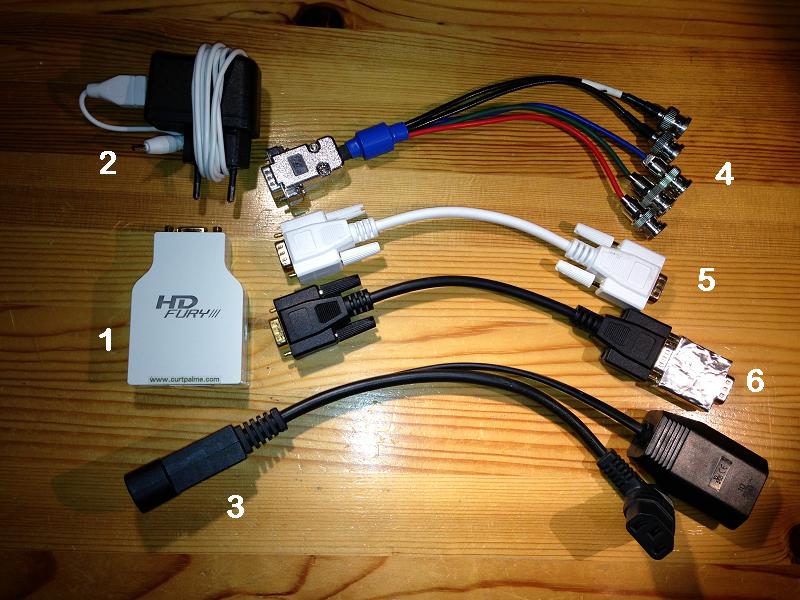

Sorry that it took me so long. Too many projects at work going on. And I didn't find the Port 3 adapter anymore. So I built a new one. Please see the picture below. This is what will be in Your box:
1 - HDFury III
2 - Power Adapter
3 - Y Power cable (I powered on my Barco remotely and with this cable the HDFury got powered too)
4 - VGA to 5 * BNC (RGBHV for Port 4/5)
5 - VGA cable (for devices with VGA input)
6 - VGA to Port 3 adapter
I fired up my trusted Barco Graphics 801s and have tested that everything works. In my opinion the picture quality on Port 4/5 is best. Please tell me via PM where and when to ship...
