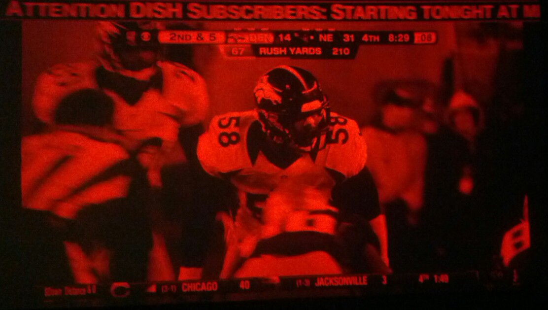

Posted: Sun Oct 07, 2012 11:34 pm    Post subject:
I'm in night-mode Smile

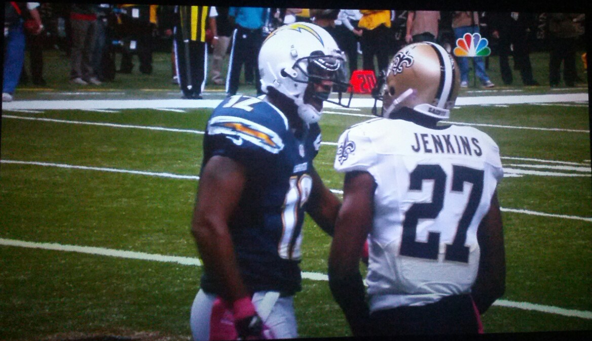

Posted: Mon Oct 08, 2012 1:04 am    Post subject:
Gave each tube at least an hour and no issues. Running all three tubes again for SNF and no problems in the first 30-45 minutes...maybe it's fixed, but I don't trust it. I hate intermittent problems!
