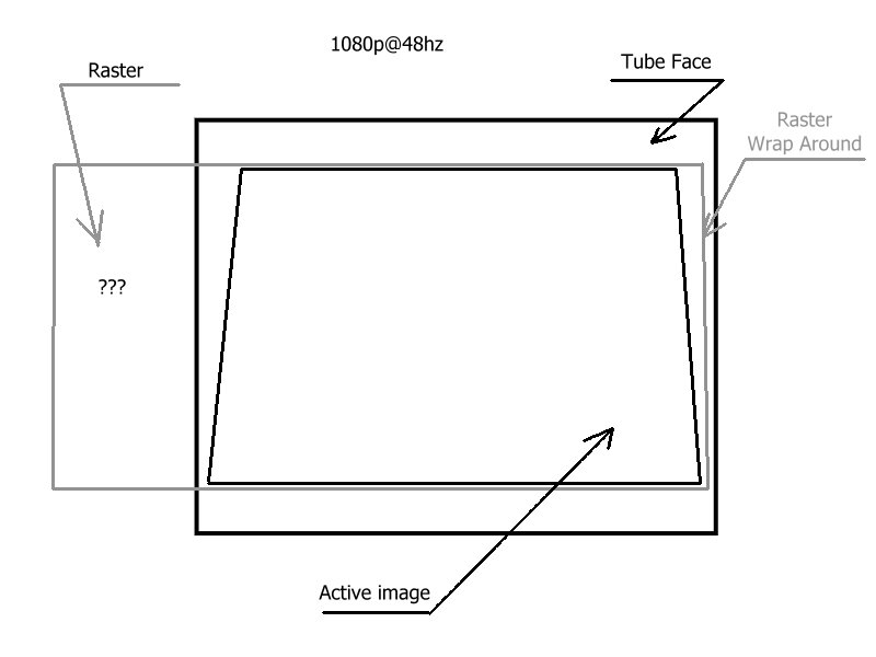

This is the schematic for explain of my projector issue.
 Filesize:  35.92 KB
 Viewed:  10280 Time(s)
Domenico (Barco fan!)

Then raster centering.
Unused raster will be shot to out side of face plate like in your drawing, it doesn't matter.

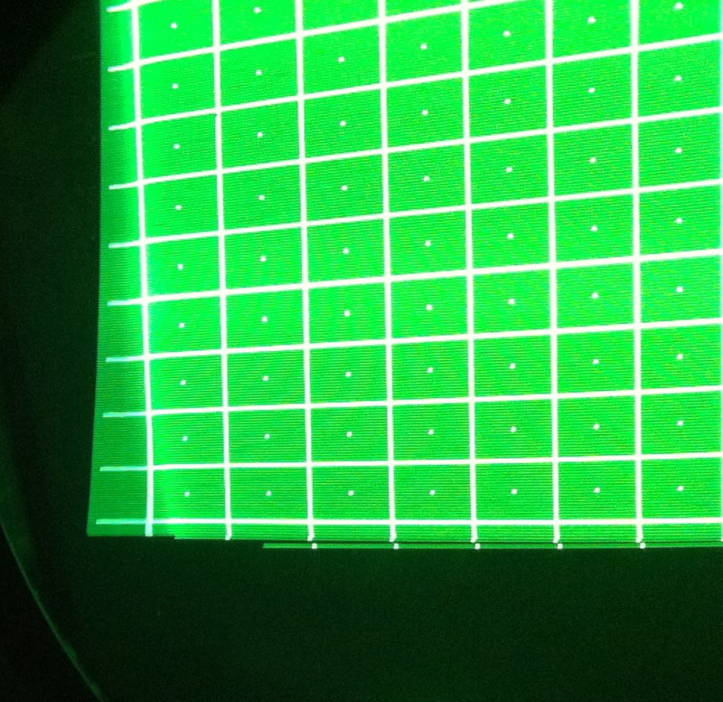

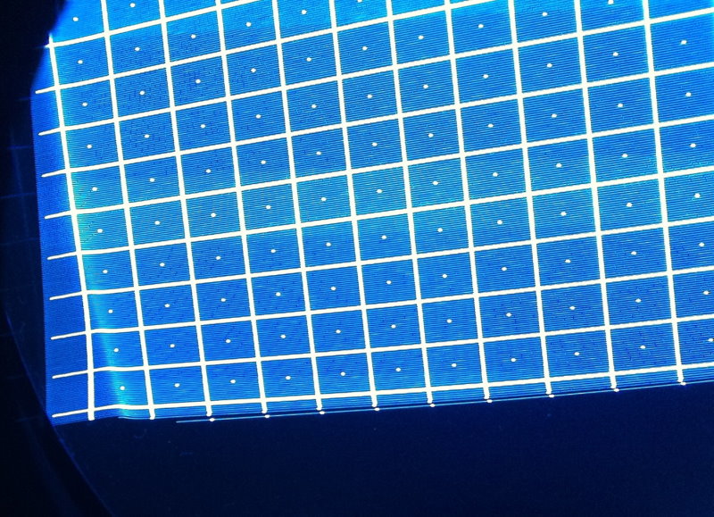

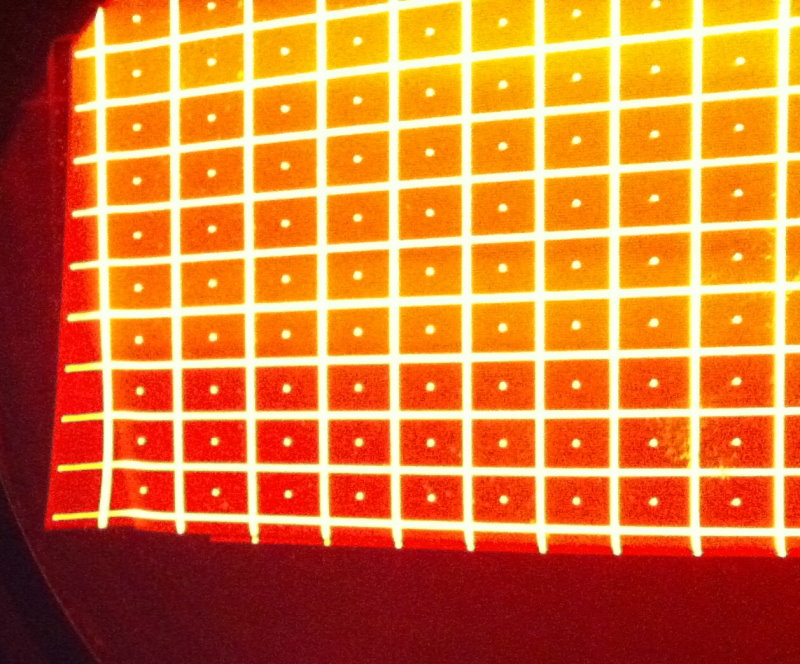

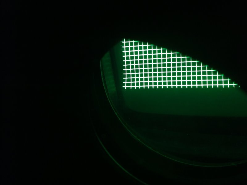

Posted: Mon Oct 08, 2012 8:51 am    Post subject:
Ile wrote:
What kind of distortion?
see pictures
(the stains, especially in red tube, are a strange effect of the photos, do not exist in reality)
 Filesize:  67.99 KB
 Viewed:  10115 Time(s)
 Filesize:  62 KB
 Filesize:  34.04 KB

Posted: Mon Oct 08, 2012 9:48 am    Post subject:
Well then I'd guess this is rather a convergence problem since the grid is distorted in both vertical and horizontal direction.
Decibel
Joined: 31 May 2007
Posts: 904
Location: Roma - Italia
Posted: Mon Oct 08, 2012 10:01 am    Post subject:
I already tried to swap the convergence driver board. I will try to swap the convergence output board.

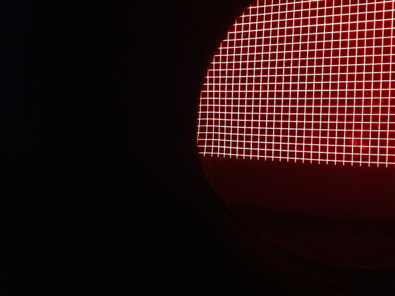

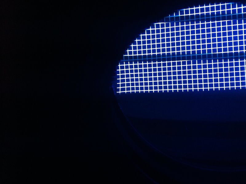

Posted: Mon Oct 08, 2012 2:39 pm    Post subject:
Tried to swap focus board and Hdefl board. No fix Embarassed
Below other pictures, no source connected, internal pattern 15khz.
I put low contrast and high brightness to reveal the raster
The problem can be seen very clearly.
 Filesize:  137.05 KB
 Viewed:  10075 Time(s)
 Filesize:  156.41 KB
 Filesize:  166.43 KB

Posted: Tue Oct 09, 2012 6:38 am    Post subject:
Does it chance when you move raster or make it smaller.
you might need to go into the secrete service menu and adjust the convergence timing.
No such thing in Barco.
Only 6 pots in convergence driver board, it can't be done without extension board and good scope.

Posted: Tue Oct 09, 2012 9:10 am    Post subject:
I think I partially* solved the problem.
This morning I tried to replace the entire tray of the convergence (so all three internal boards) but without resolving anything.
Then I changed only the board of convergence driver (R762518) with the old model (BG808).
Now I do not have any raster distortion at left corner and finally I can set the image almost coincident with the raster Smile
*:I've got errors when I try to use the controls "left adjustment" and "seagull" because the old board of the convergence does not have the chip needed for these functions.
I tried two different newest model of convergence driver boards, it's impossible that both are faulty.
I think that in some place could be some incompatibility.
This projector was modded from BG808 to BG808s (swap newest boards and firmware).
Any advice?
Boards swapped (modded BG808-->BG808s):
SMPS (tried to swap with old model, no fix)
Vert.defl (tried to swap with old model, no fix)
RGB input
RGB Driver
Convergence driver (tried to swap with old model and solved).
