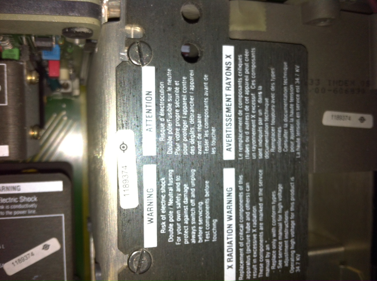

I installed my projector on the celing, and it's pretty close to the rear wall, but i was able to see a red light come on towards the rear of the pj when the pix went out. Also, I can see a red led come on behind the cover in the attatched pic. Both leds extinguish once I cycle the pj off then on. If it is the board you mentioned earlier, how much will it cost to replace? Thanks.
