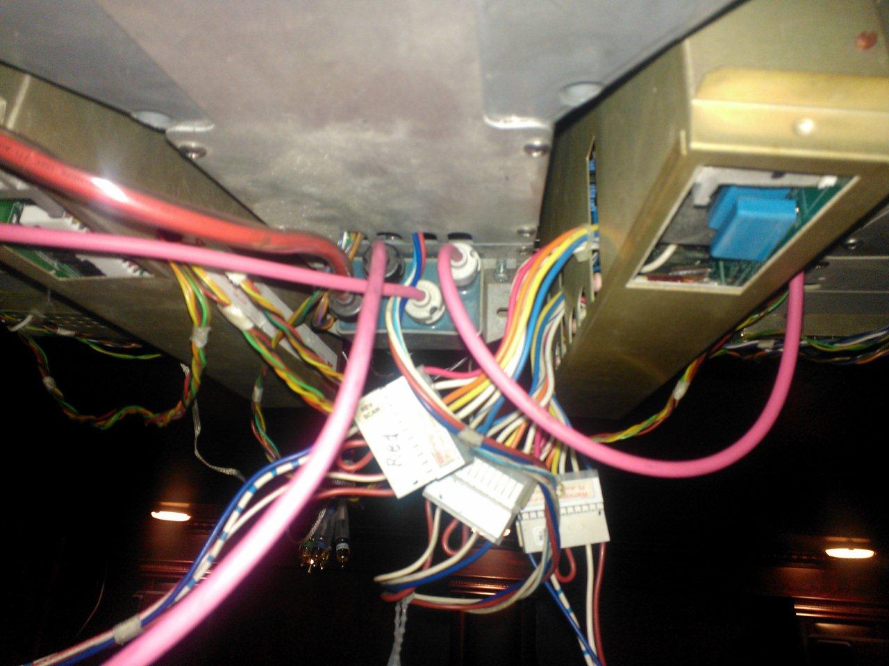

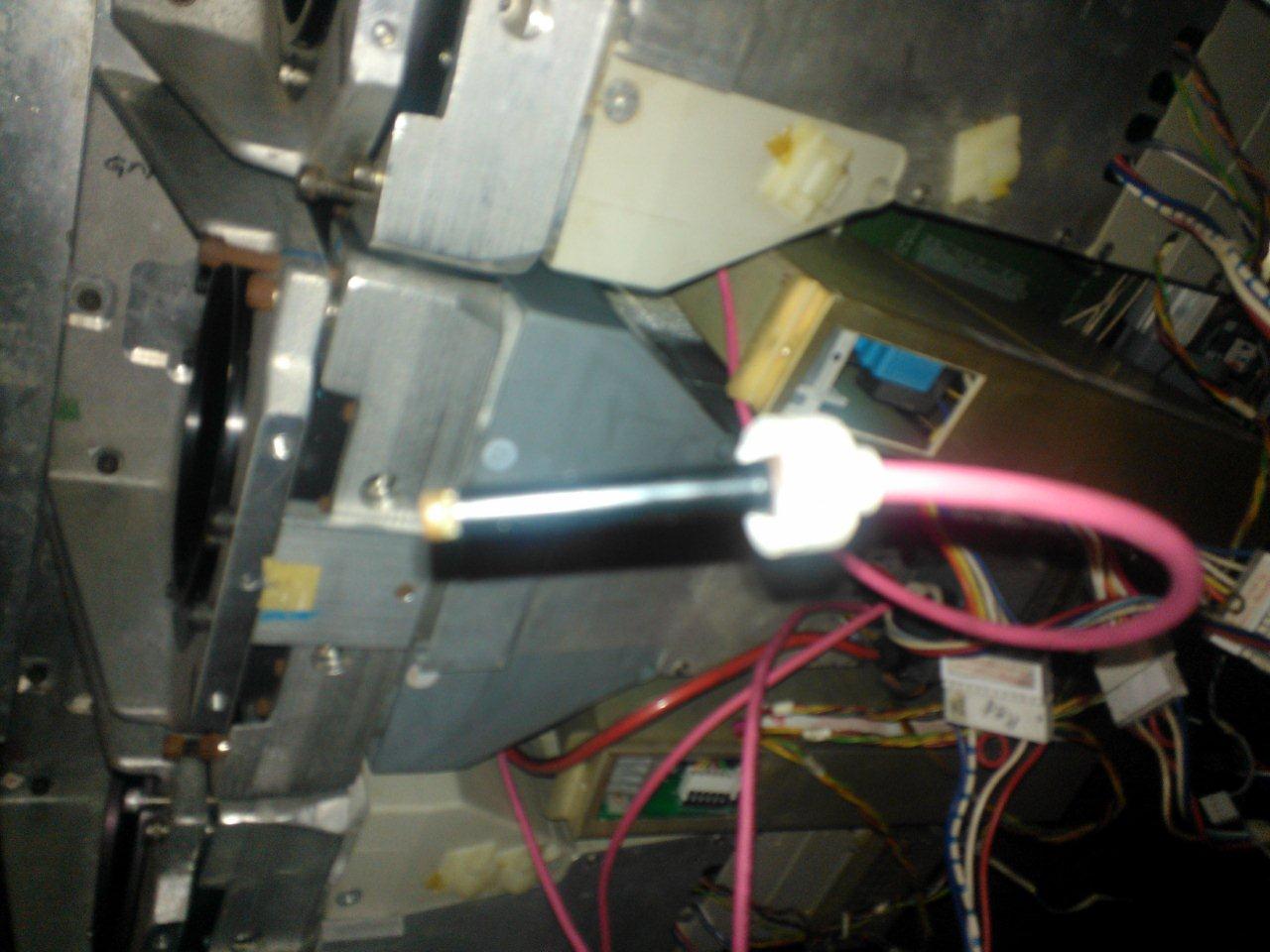

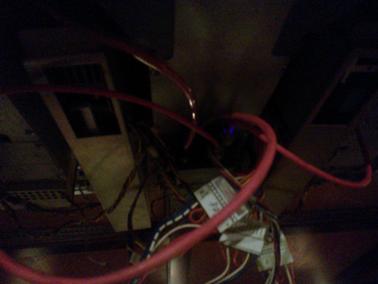

I was having a loud popping problem so I replaced the HV lines to each of my tubes following the instructions on curtpalme.com (new silicone etc). I did them one at a time. I just installed the blue tube, turned it on and there is tremendous blue arcing from the end of the Hobson connector. I turned it off immediately and swapped the HV splitter with a spare, same thing. Is this something I did when replacing the HV line? Might the new Hobson connector be bad? It looks just like the other ones. I still have another new HV connector I bought from Curt, should I cut off the new one I just installed and try again?

Hello
Was the Hobson tightened until it clicked? Post a picture of the entire connector.
Posted: Sat Sep 15, 2012 2:04 am    Post subject:
That's kind of unusual. Is the installed one from me as well? If so, I'll replace it, but yes, I'd put on a new lead.

Posted: Sat Sep 15, 2012 2:06 am    Post subject:
Yes the connection is very tight. So tight that the click is not as noticable as the other wires. It does turn the full amount though. I will post some pictures.
