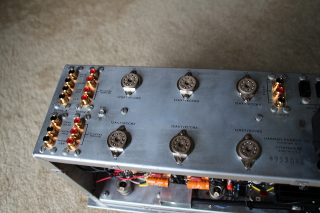

6 - Replace the old steel RCA jacks with high quality gold plated new ones. I used a thick double sided blank circuit board (2oz. copper) to mount them on. It also became part of the new grounding system.

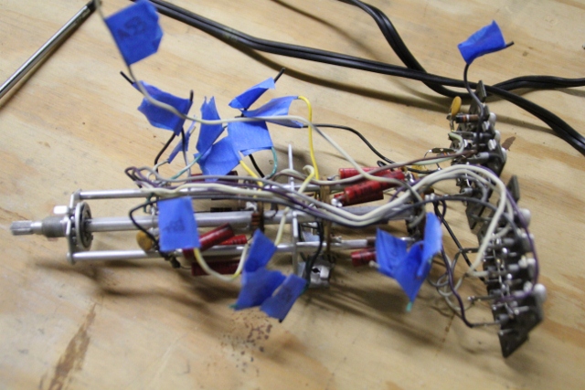

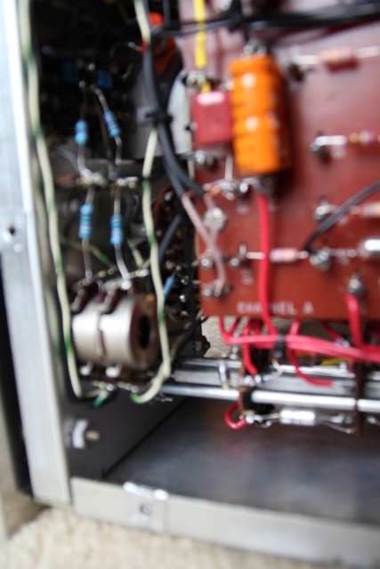

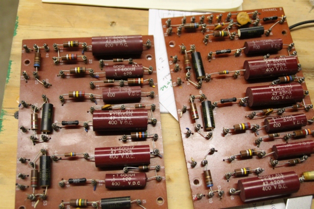

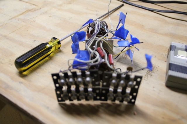

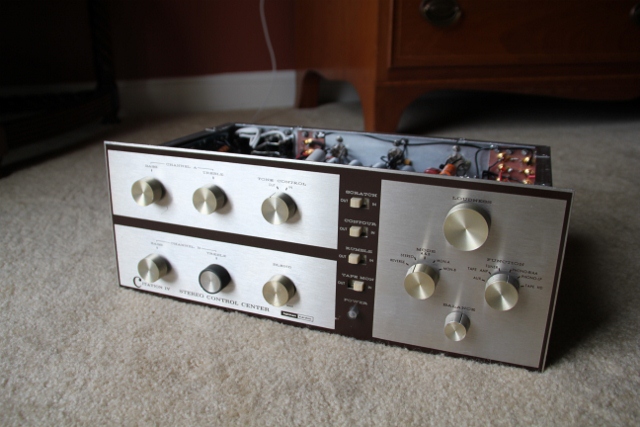

Now, for the "before" and "during" pictures:

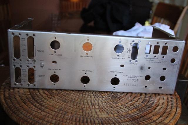

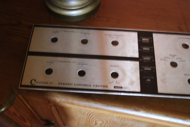

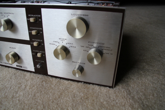

Here are the rest of the before/during pic's:

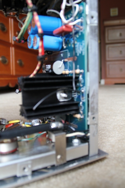

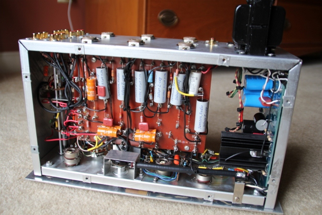

Ok - Here are the "after" pic's. The circuit board that you see is the voltage regulator for the 280 volt B+ supply. It took the space that the old power supply was and just barely fit inside the side of the chassis.
