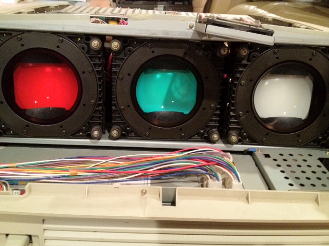

I was always under the assumption that the hour meter on crt projectors gave you 2 readings.
one for total hours on the chassis and the second reading for hours on the tubes.
I just picked up an NEC XG 135lc projector[img][/img]
The meter tells me the projector has 9300 hours on it and the tubes say 9300 also, but the tube faces show no where near the wear for the number of hours.
I have a 6pg xtra that tells me over 5000 hours on both, but the tube faces are pristine.
Am I wrong in my assumption or is the meter reading faulty?

Just found out the tubes were changed, so that explains it.
