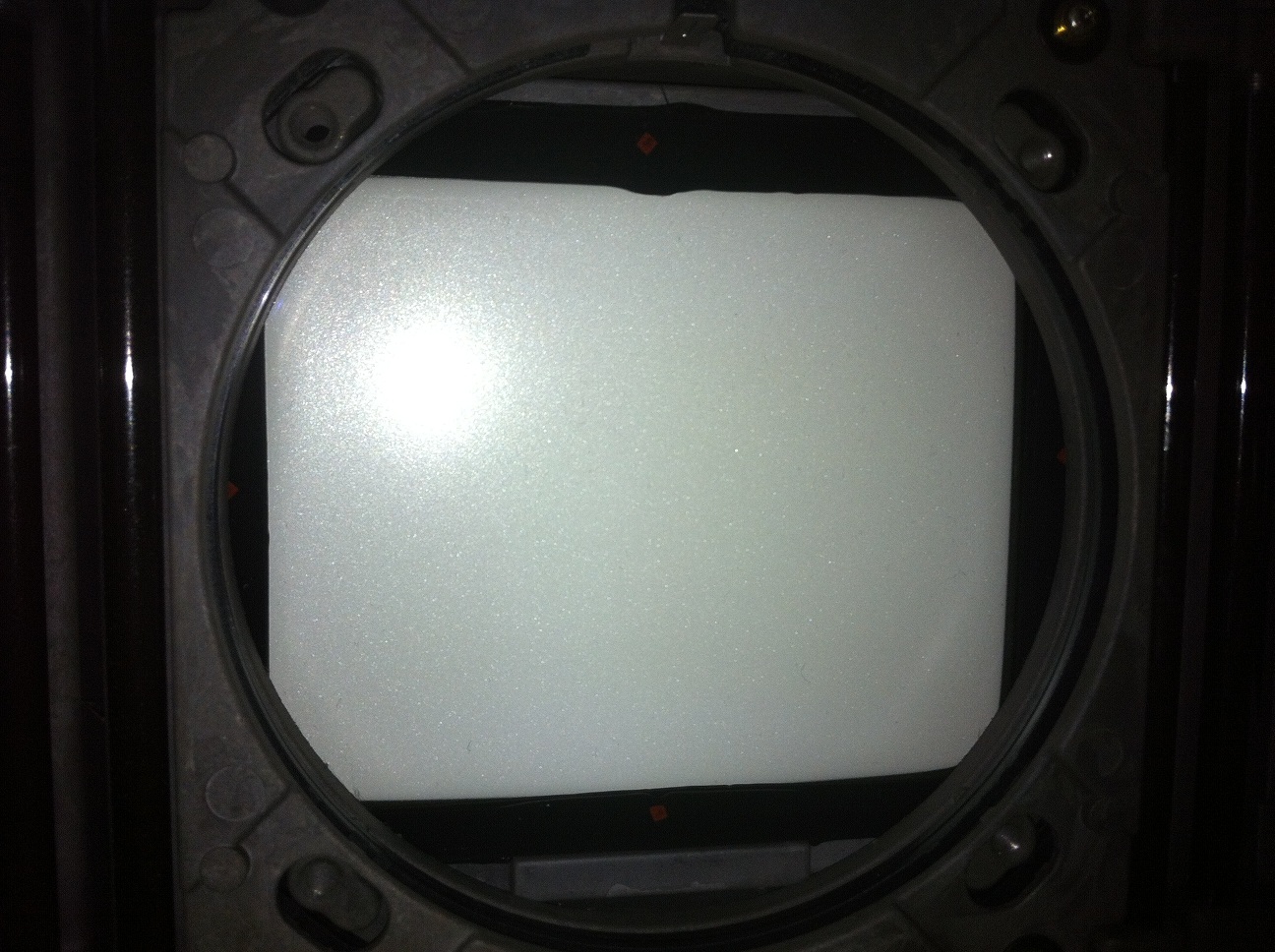

I'm new to this board but have been on the site quite a bit over the last 2 weeks going through the wealth of knowledge here. I've owned my 9PG (with service remote) for 12 years now (1300hours total on it). My projector hasn't seen much use in the last 7 years as the room it was installed in was converted to better suit my recording needs and it was kind of ignored. I moved recently and of course the 9PG came with me. I decided it was time to fire up the projector and came across this site , not having set it up in a while and being a little rusty, the wealth of knowledge and tutorials where of great help! It wasn't long before i had it up and running beautifully and asking myself why in the hell did i ever stop using it? I've been using it daily for the last 2 weeks. Last night i think i did a bad thing. Being a tweaker and never satisfied i measured the screen size with a tape measure and found it not to be perfect 16x9 so i widened the picture to make things perfect. I did check inside through the lens and it appeared to be centered and lots of room to the edge.

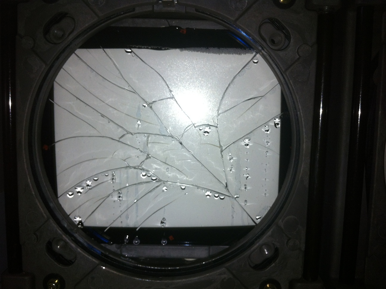

Last night was the most use it has seen in 12 years. I had it set up at 1600x900 @70Hz and was very happy with the picture quality for regular dvd as well as Blue Ray. I left the room to refill my beverage and upon my return i noticed the red was bleeding on screen. I promptly looked into the lens and saw that it had shattered, I immediately shut it down.
Today i took off the red and green lens to have a look and take pics which are attached. Mainly i was looking for the required air bubble i've been reading about on the site here on the green crt but don't see one. Do i need to bleed it? I am in need of a replacement red CRTat a reasonable price. I've checked Curt's how to and i think it's within my skill level to change out.

Attached are pics of my broken tube as well as the green one to show the condition. I'm not an expert but i can see no wear at all on any of the tubes.

The Green

The red one :(

I've got lots, from brand new to good used. Looks like your green is mint, so no need to change the green or blue. Lucky you. Smile

Thanks Curt, I think considering the condition of the green and blue tubes, a new red one would only make sense. I'm still curious as to why it shattered. Was it me pushing the width too far or just one of those random things?

The CRT is actually fine. What you have there is breaking of the front glass from glycol over pressure. This happens to most NEC tubes after many years. The red one is cheaper and easier to get from Curt, but your blue and green should be bled before they, too, break.
Read up on this, it's been discussed many times. But you do have to pull the tubes out to get to the bleeder screws.
