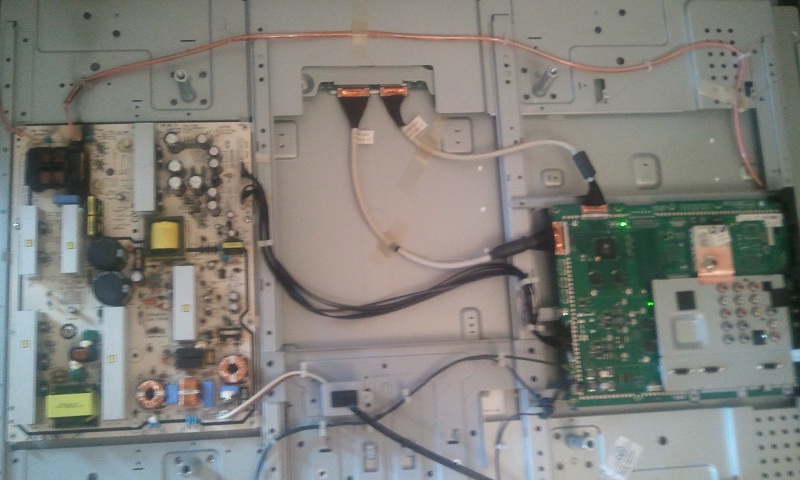

I've fixed several LCD's in the past couple years, but none have been this difficult in diagnosing. Any help is appreciated!
When I first pulled off the back panel, I noticed the power board was charred (upper left near the backlight connectors). The main board has two green LEDs which still lit up when the tv is plugged in and turned on. I figured it would be a simple power board swap so I bought a set of boards that included power board, main board and TCON. I switched out the power supply and it would not give the same relay clicks, nor did the LED's on the main board light up.
With the new power board in, I proceeded to then swap the main board and still no LED's. I also put the new TCON in and no change. When I put all the original boards back in, the LEDs come on, but the tv won't work due to the burnt power board.
Is this a good indication that the backlight(s) are shorted as I fear? Are the new boards going into a protective mode which prohibit the set from powering up?
In the attached picture you can see the main board LEDs lit and also where the power board caught fire...

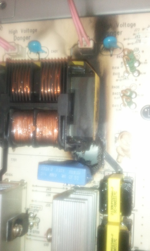

Posted: Tue Jul 31, 2012 12:34 am    Post subject:
Hard to tell from your pictures. Is the burnt part right on that connector?

Posted: Tue Jul 31, 2012 5:47 am    Post subject:
Nope, it's below that. Right above that blue relay. Here's a close up

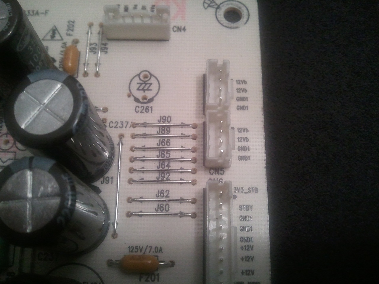

I'm really stumped on this one. I have 3.3V at 3v3 STB on both power boards with all plugs disconnected (except wall outlet). Also about 2.6V on STBY on both boards with nothing else plugged in.
What could be preventing the main board from turning on with the newer power supply board in?

Posted: Tue Aug 28, 2012 1:56 pm    Post subject:
In your picture you have CN6, 3v3_stb. You say you have that 3.3v, correct. Now monitor the pin below that "stby". When the power button is pressed you should have 3.3v to 5v on that pin. Do you?
Yes that is correct about the CN6 3v3 having 3.3v. I checked the STBY and if I remember correctly it was at 2.6v on the new AND original boards. I'll double check though and post back.

Posted: Sun Sep 02, 2012 2:07 pm    Post subject:
You need to test the power supply outputs with your different combination of boards. After hitting the power button test for voltage at connectors cn6 and cn7.
Fill in the blanks:
CN6:
1.
2.
3. Use this for ground when testing 1 through 8.
6.
7.
8.
9.
10. Use this for ground when testing 9 and 11
11.
CN7:
1.
2.
3. Use this for ground when testing 1 and 2.
5.
6.
7.
8. Use this for ground when testing 5 through 7.
