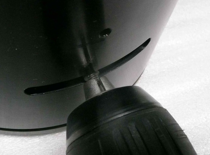

The only thing you want to take apart is the outer shell. Remove the two pins the knobs screw onto. Their square on top so you can carefully use a pair of pliers.

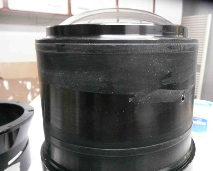

I've made pictures but they will come tomorrow. it didn't work by the way. I can still hardly move the center focus. I wander if the previous owner didn't drop the lens and that it's slightly oval now. I don't want to grind to much because then the nice black finnish will be gone. I've used 600 waterproof sanding paper.

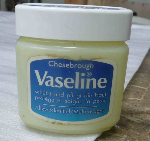

I've put in some grease (vaseline) But it doesn't help much. I can move the lens by moving the corner focus ring to it's end and then the center focus will turn aswell. Maybe I'll give it another try.
As promised some pictures.
Maybe the grease I've used is not so good
the grease that i've used for

the outer barrel taken of before cleaning and sanding
how i took out the screws
 Filesize:  71.87 KB
