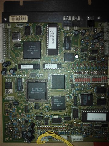

Thanks I will check the voltage. This is with my existing controller when I install the one you sent the projector cycles on and off repeatedly and does not respond to the remote at all. I figured this was likely a projector issue.

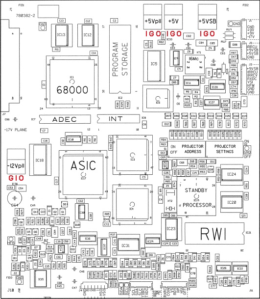

I looked up the controller schematics and I found that there is indeed a watchdog circuitry present. So lock up issues caused by software errors (e.g. infinite loops) shouldn't occur.
In addition I could see that the main supply voltages are generated on board with voltage regulators. Please refer to the picture attached where I've added their pinout in red (I=Input, G=Ground, O=Output).
Regarding the board that I've sent: This controller was pulled from a working PJ with worn tubes. So it was working with its original software (V6.2 if I recall correctly). I plugged in the newer Software and RWI EPROMs that I purchased from a company in Germany but I wasn't able to test this configuration as I never came around assembling the parts into a new PJ. You could check if I did something wrong when changing the EPROMS (i.e. bent pin) although I was very careful when I did the swap.
Another try could be taking the EPROMs from Your controller and using them in the one I've sent.

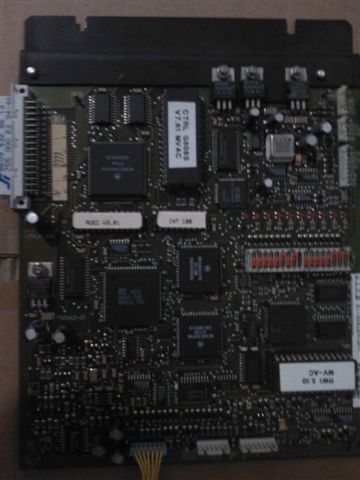

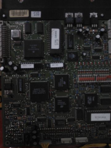

Here are some pictures of three different boards each is a little different but the part number is the same.

As far as my research went there are at least two or three revisions. Not only the location of the crystal oscillator (the part with the metal case) changes but its value too. You might find 32MHz and 16MHz respectively.
I compared the controller schematics from a BG1209s (from 1997, oscillator to the left, 16MHz) and a BD808 (from 1994, oscillator to the right, 16MHz) and so far I haven't found any differences in EPROM types and addressing between these two. I'd like to verify this against the BG808s schematics but I haven't been able to locate a copy. I'll be able to verify against the Cine8 schematics which I have a hardcopy of but this will be some time later...
