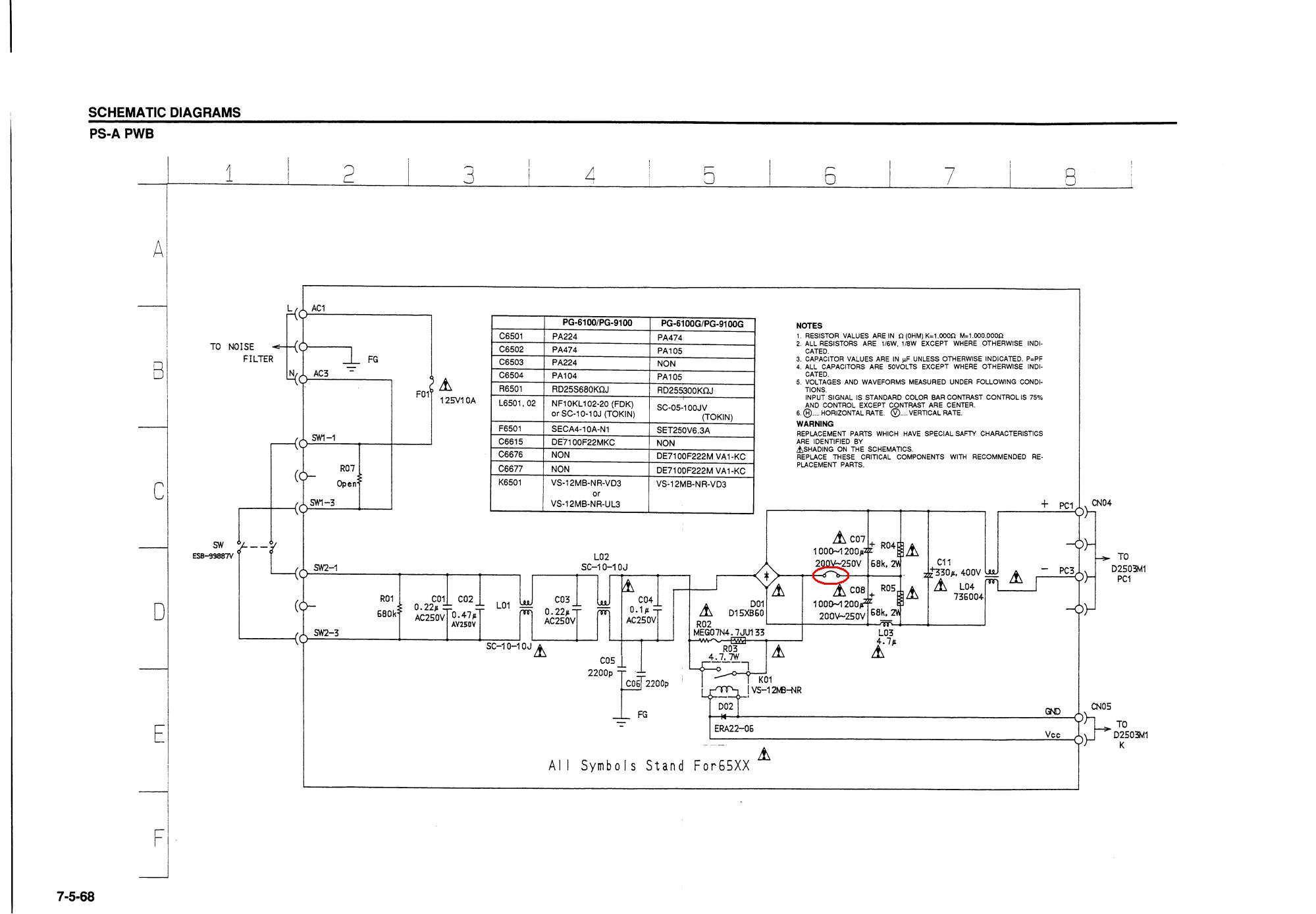

Posted: Wed Jun 27, 2012 2:32 pm    Post subject:
Yes, there is a jumper inside, and some other components should be changed, the picture is for PG plus, but I think it is basically the same as plain PG.

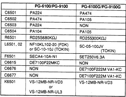

Posted: Wed Jun 27, 2012 2:38 pm    Post subject:
I have PG xtra which is very different, but if you don't mind I attached the corresponding page from the PG+ SM, I circled the jumper which should be altered.
