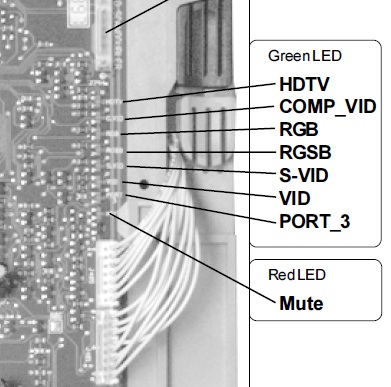

Please take a look at the picture attached. It shows the LEDs on Your RGB input & switching board. As long as the red LED is lit You won't get any picture. The LED only shuts off if a valid input signal is present. Such can be a RGB video signal with separate sync signal(s) or a combined video input signal (Video or S-Video).
For processing a combined video signal You will need an additional Decoder Board mounted on the backside of the RGB input & switching board. If it isn't present You only will get a picture when feeding a RGB source.
Do You get any messages displayed when You press a button on the remote?
Try pressing the "Text" button. The PJ could be in Pause mode (picture mute). Try the "Pause" button.
To answer these questions
1/ the picture, that is the led in question
2/ i now have a valid input signal and the red led has shut off
3/ there is an additional Decoder Board mounted on the backside of the RGB input & switching board.
I am still not getting any light from the lenses at all, no test patern,no picture,no menu i hope this informaition helps.
