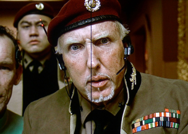

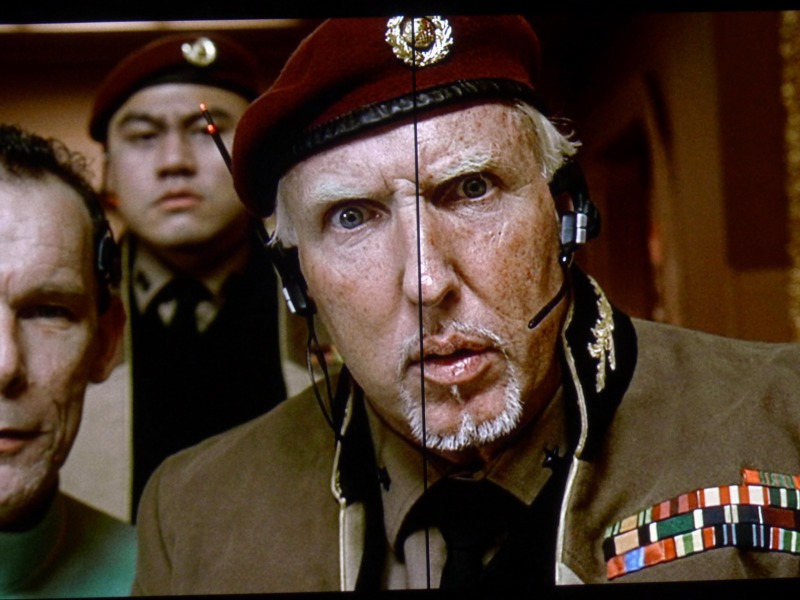

Has anyone here purchased the new Darbee Darblet. It is getting a lot of play over at AVS. It is a video enhancement device that goes between the pj and the source or VP or whatever (last link before the pj). Jeff Meier said it makes a JVC LCOS almost look like a 3 - chip dlp.
umr wrote:
This product does not function like the current detail enhancement circuits or sharpness controls. It appears to alter the local gamma with a variable bandpass logic. It is effective at restoring image sharpness lost from excessive electronic filtering or less than perfect optical systems without the characteristic edge enhancement from older methods. It is also capable of further enhancing the object contrast when the level is action is increased.
With my JVC projector it makes the image look very close to a $50,000 three chip DLP by restoring most of the lost sharpness from a lower system MTF without a significant increase in artifacts. That is easily worth the price of admission with this product for me. I have purchased no other external video processor in the past so I am no huge fan in general of these products, but this is an exception in my opinion.
I looked at it pretty extensively and have significant capability in that area as well. I have been in major post production houses like Sony and Todd-AO and also work for professionals at their home and work who produce films for Delux, Sony, ILM, IMAX.... I have about $40,000 of test gear and custom engineered tools as well that deliver the best results possible.
There are negatives to this product. That is why it is an enhancement I would not use on my Pioneer Elite. The tradeoffs are worth it to me on my JVC projector.
Anything that alters the image going to the display is not providing the source as it was sent to you. What this can do with some projectors is restore some of the lost edge sharpness with little negative impact. Using this with other products with high MTF or using high levels of enhancement will alter the image sent to you. This can be a negative or a positive depending on your desire.
It does not add halos as found with other sharpening tools, but it does alter the image around regions where edges are found to various degrees. The higher the setting chosen the area affected around each edge is increased and the greater the change in signal levels used to increase the contrast. This can dramatically alter the image or more subtly depending on the level chosen. It can also increase the appearance of compression artifacts to various degrees depending on the level of enhancement chosen. From what I saw a low level of enhancement made the image on a JVC projector look about as sharp as a 3 chip DLP without any more increase in image artifacts than that sharper machine would have at showing them in the first place.
Judging from these and other comments, it looks like this could be a nice addition to CRT pjs. The cost is only $250 and AVS has money back guarantee. Any takers? I am looking in your direction Haydn Very Happy
http://homecinemaguru.com/?p=1909
http://www.avsforum.com/avs-vb/showthread.php?t=1399154
setting 40 on the darblet

setting 80 on the darblet

I'll be very interested in hearing your evaluation, Bob, in the context of a CRT setup. There are some losses in MTF inherent in CRT-based systems, and this may be effective in compensating for those, when used in moderation.
Just a note that most commenting on it in the A-forum are using it in the range of 40-80% (out of 120% max setting). OTOH, when Jeff made note of the improvement he was able to get on his JVC, his settings were in the 5-15% range. I would suspect the usefulness of the Darblet for CRT (without introducing negative side-effects) would be in the same neighborhood. Dependent of course on your particular CRT configuration. [This would be in an adjust-it-once-and-leave-it mode. Rather than dinking around with it on a source-dependent basis, as many are doing.]

I didn't see where Jeff had mentioned what settings he used. Honestly with the low MTF of CRTs, I would think a lot of people would crank up the setting.

I don't remember or have the link handy to where I saw it, but his comment was that he found it best "at 5/10/15% settings".
I was going to suggest that too, but I think its dependent on your CRT. E.g. those running blends don't need nearly as much bandwidth per machine, so the MTF limits wouldn't be as severe as on lower BW or single CRTs. Thus making a 10% setting perhaps adequate. While others may need something closer to 20% or even 30%.
The second factor is that the Darbee enhancement also makes any artifacting in the source more visible. One thing that CRTers enjoy is the fact that they smooth out some of those unnatural elements from our digital source material. At some point, the Darblet will make those artifacts visible enough on CRTs that you'd want to back off. Even Jeff admitted it was a compromise, but one he was willing to make on his JVC (but not his other devices). And he's using it at the very bottom end of its range, even there.
