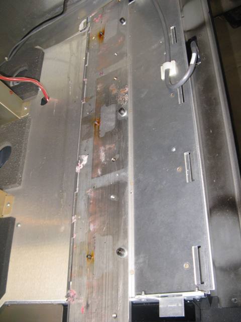

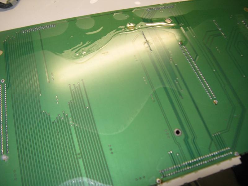

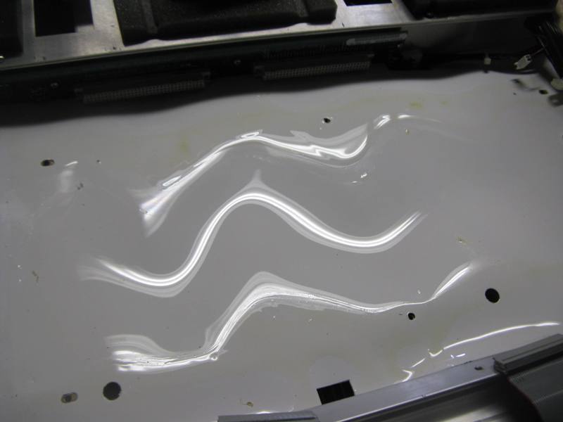

or not. This is a machine local guy bought for a grand + freight. Looked like a real jewel at first but he had me check it out and do some mod's to it. What a fricking mess, the motherboard ,insulating strip under it , and one of the umbilical's to the neck-board were just swimming in Glycol. It's a miracle the Glycol didn't drip down on the VIM or CLM or seep under the Back-plane. This a machine with less than 1K hours on it
When I took the fill plugs out the Glycol from the tube shot out 3 feet and sprayed the wall. Folk's, this is what you should expect with any marquee LC that hasn't been serviced or re-built. MAkes a strong case for a good old 8500 don't it?

I tried, the owner got caught up in the 9 inch buzz and rolled the dice on this. As it turns out, even with my repairs, he is getting a sweet machine. Correct lenses, newer Ultra , low hours, clean tubes.
However If I wasn't local though he would be screwed and paying double the purchase price to fix this mess. What does VDC charge, $450. per tube to replace bellows and Glycol....... Shocked
