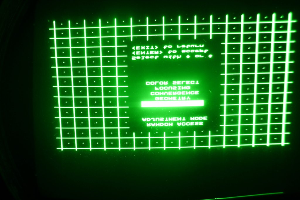

I turned on the unit and it fired up but now I cannot focus the right side of the green tube only electronically. Even the text box for the adjustments is almost unreadable. The adjustments worked on center and left but nothing at all on right side. It is out of focus on the crt face. There also seems to be an area just left of center that is also slightly out of focus. Switched focus board with no change in ability to focus.

I powered up today and same thing with right side out of focus and adjustment does nothing. Changed out the conerg tray and no change to focus or ability to change focus on right side (this converg tray has other issues with split vertical lines on left side. Removed lens to be 100% sure and it is out of focus on face.
Focus board swap - no change
Complet converge tray swap - no change
Running out of options...
Posting a not so good picture of crt face with lens off.
Side focus issue
 Filesize:  104.88 KB
 Viewed:  10261 Time(s)
Posted: Fri May 11, 2012 1:58 am    Post subject:
Well, short of getting in there with a scope to check waveforms, it's a bit strange. It does look like the astig is a mile off on the right side, looking at the dots. Any chance that the cable to the focus yoke on the green has wiggled off?
Otherwise this is a case where you might need to send me boards to test. The focus is controlled by the focus board and astig board, that's it. NOthing fancy about the circuits. It's possible that both focus boards are bad? you say the right side cannot be adjusted. Do you notice change on the left side with both the astig and focus controls? THe chip that controls the left side also controls the right, so it would be a bit weird if one side worked, but not the other. I usually find of the focus board is dead, both sides, left and right, look like the right side does. The fact that the left side is fine, but you say it's the tube face that is out of focus is mystifying to me.
Posted: Fri May 11, 2012 2:03 am    Post subject:
Oh, one more thing: If the center focus is defocused, can you get the right side to get better? If not, then this isn't a focus issue, then it's an astig issue, which is what I'm leaning towards.
Even if the focus board is bad, as long as the center focus can be adjusted, you should be able to ignore everything but the right side of the screen, and by iusing the center focus control, you should be able to get the right side as sharp as the left side looks right now.

unplug the green astig wire and set up the astig rings first.

I had the same issue one time and it was nothing to do with the electronics. It was very simple and seems to be overlooked so far in this thread. Fungus on the one side of the tube. If it has fungus there is no way you will get that side to focus. Drain and cleaning the tube may fix the whole issue.
