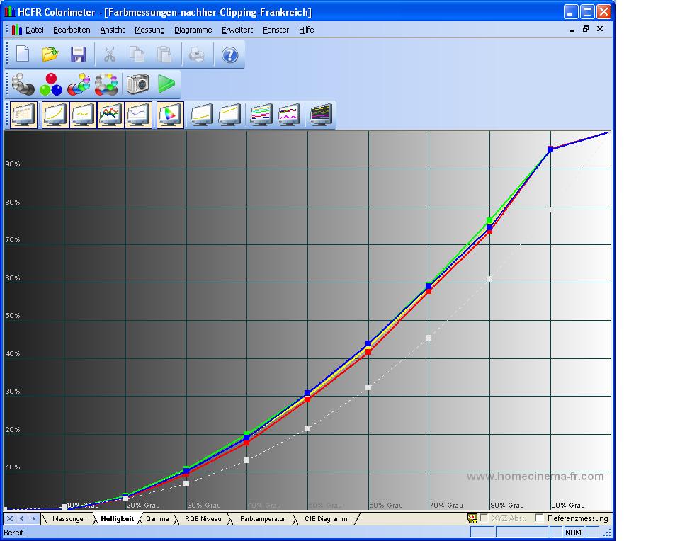

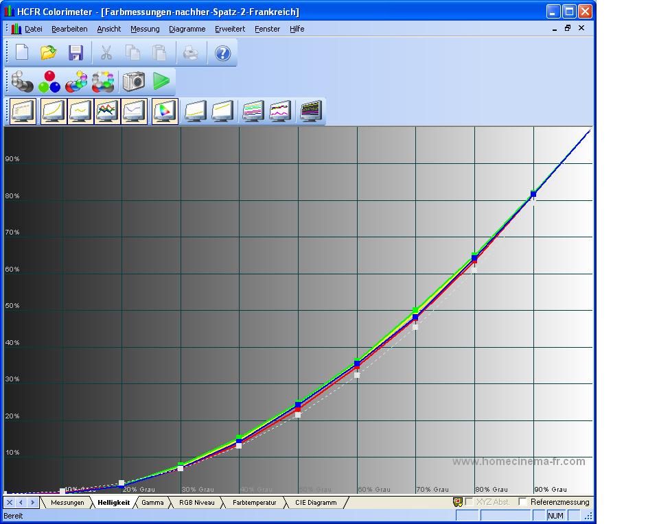

for some days I try to calibrate my Sony G70 with hcfr software and sensor.
Luminance shows clipping and I have no idea how to manage it.
First picture is using RGB Connection via DVI to 5xRGB Spatz box.
Second shows luminance with MoomeCard and Clipping
Moomecard gamma is on max. and contrast on middle position.
Sony G70 contrast is 60 and bright is 55.
Gain and Bias is 127 of 255 for green
Please help.

Why did you change the contrast setting? This needs to be set with an oscilloscope connected to the green pin on the multi pin connector. Feed the HDMI card a 100 IRE white window. Then adjust the contrast pot until you see exactly 0.7 volts peak-peak.
The contrast pot being set wrong is the most likely reason you are seeing clipping. You are probably sending to high a voltage for RGB from the card and the projector can not take this.
The other possibility is that your gamma is set much too low on the card.

what do you mean with you see exactly 0.7 volts peak-peak?
Do I need an oscilloscope to see it or is there anything to see on the 100% IRE white windows?
Regards

You need an oscope to see it.
A less precise way, but not too bad is to do the following.
Put a test pattern on the screen that shows whiter-than-white in 1 IRE graduations. Adjust the contrast pot on the board so that you can see all of the white levels through 255. Once you can see all the white levels turn the pot a little more so that you have some overhead. Don't go too far or you will compress your gamma because the peak-peak voltage may go below 0.7 volts. Just get to where you can see all the whiter-than-white bands and then give it a little bet of extra turn (maybe 1/4 to 1/2 turn).
