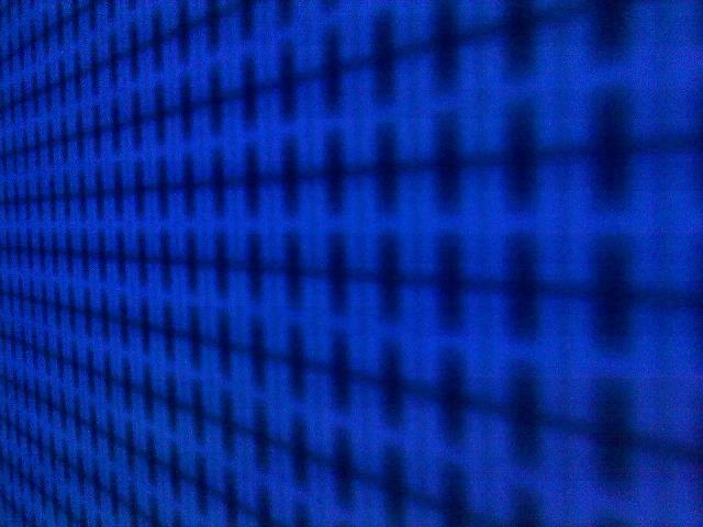

Separately, and less importantly, from my other post "my blue refuses to completely focus. The green and red do quite well with the manual adjustments (though I'm sure it could be better, I wouldn't know), but the photo is as good as the blue gets. ideas?"

As for the focusing, there are focus pots on the side of the chassis. Try tweaking those. It's normal for the blue to focus a bit less than the other two colors, and if the rear of the lenses and front of the tubes are clean, then it's probably as good as you'll get. THere may be dust between the lenses and tubes, pull the lenses to check and clean with lens paper. It looks from the above pix that you may have slight haloing from dust particles on the back of the lens.

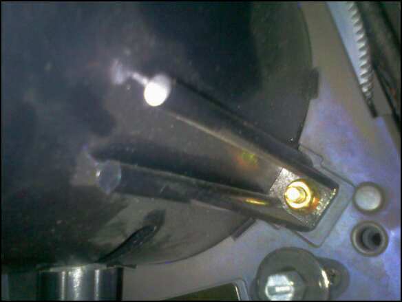

Good grief, the pots are right there, I read that 130 page service manual I don't know how many times and never saw mention of those! It did make a difference, but if I do remove the lenses, is there anything I need to know? It's ceilling mounted, so I hope i can do it without taking it down. Is it the nuts shown in the pic?

Yes, take off those 4 nuts on each lens, and it will come right off. It's about 3Kg, so beware that they don't drop.
