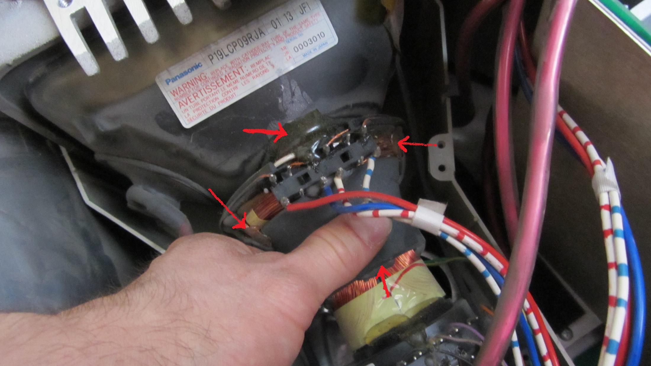

Hello! im starting a new thread so i wont spam the frankenyokes thread.
Like the picture shows,is this the right way to grab hold on the yoke and then twist it by hand? should i peel of all of the glue marked on the picture? the contrast should be at low levels i guess.

I would slide a small screwdriver under the glue. Most of the glue on these yokes will loosen once you twist the yoke, but I've sheared off a couple of wire loops on a couple of sets when the glue doesn't loosen. Make sure you don't shear the wires with the screwdriver though.
Worst case, I've got a pile of spares, so no worries there.
Also, there's 800 volts on the H yoke windings, so maybe wear gloves when you rotate the yoke..
Posted: Wed Apr 11, 2012 1:18 pm    Post subject:
Dont grab the Yoke itself unless you want a nice static shock!! I just grab the wires around where the tape is and move them that way.

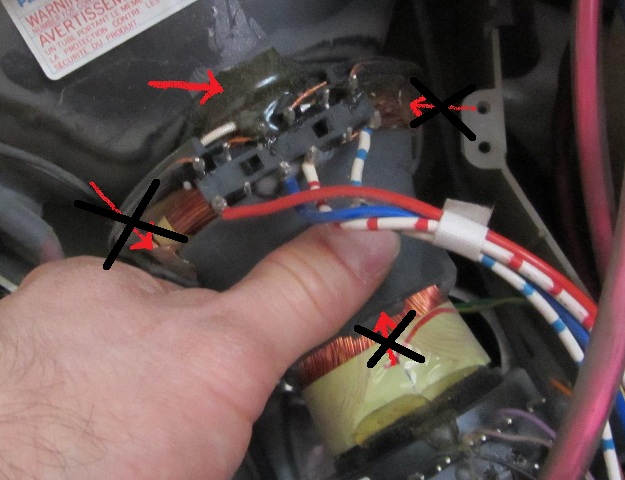

Three of the locations in Your picture should be left alone as they are part of the yoke itself. Only the glue between the tube and the yoke should be loosened...

good tips! i have managed to adjust them thanks to all your tips. Good thing i did not peel all the glue on my picture of then. It did have a impact on the magnetics so i had to do the cps magnets again... I will wait till darkness falls to fine tone.

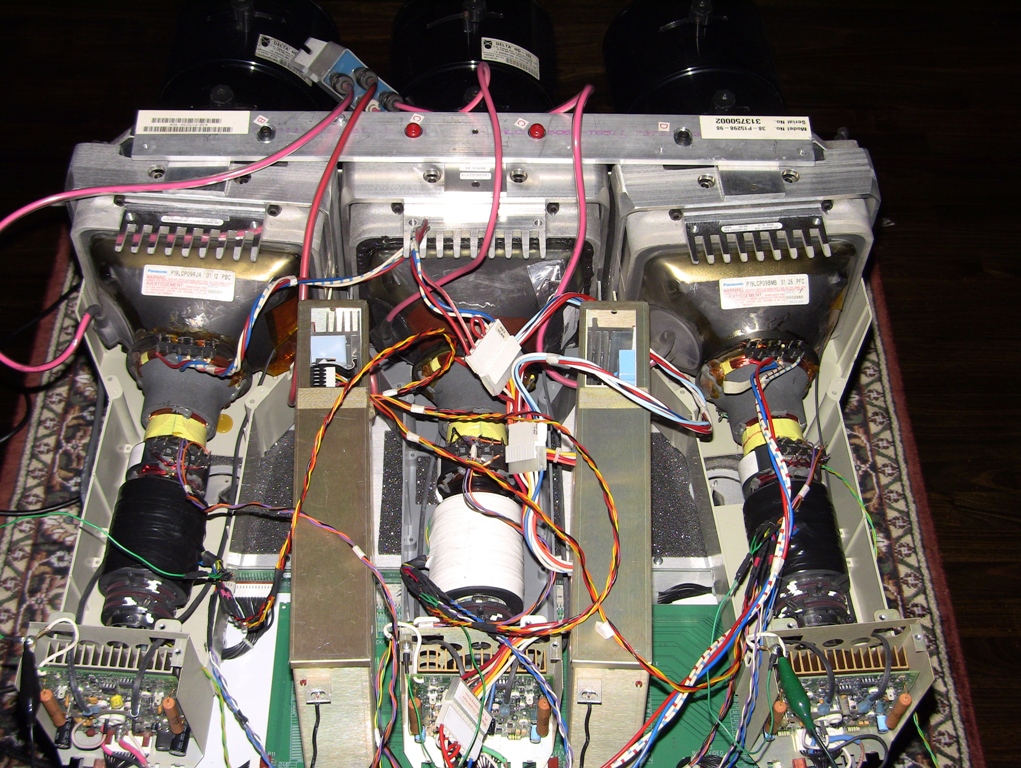

Nash is going to scold me for not putting this in the frankenyoke thread. All in good time, as I am documenting this!
I have the G90 yokes in the projector. I am connected black->green on the static coils and I have experimented with polarity on the dynamic coils too but stayed orange->red. I have tried physical orientation "normal" and "flipped." I currently have them all with the static coils facing the convergence yokes. I have experimented with position along the neck and with rotation. While the red and blue show good promise, the green is being problematic. I cannot seem to get good side focus, especially on one side (I'm worried the magnetism is degraded). I have been moving the yoke along the neck and going back and forth between center, side focus and dynamic stig trying to find the "sweet spot," but haven't found it yet.
As I'm sure you know, there is a LOT of interaction between these devices. The only way I was even to get the green centered was between rotating the G90 yoke and fiddling with the CPC flare ring.
Unfortunately, I have no more time to spend on this for a few days. I am going wild boar hunting tomorrow and won't be back online until Sunday. The wife is none-too-happy leaving her with an unwatchable projector!

Steve, For the placement of the coils relative to direction. I was looking at how the Marquee Coils are arranged back when I was experimenting myself. The static is placed first in the coils then the Dynamic. Same for the Barco coils, they are placed in the front. Now for the Barco coils they did something different regarding the magnets, for the green yoke they have them flipped 180 degrees. So the polarity for the Red and Blue are the same and green is opposite. I beth they did this to counter the magnetic field interaction that may occur between the tubes, but I think they are placed a bit closer to each other than in a Marquee. Not sure tho .
Ok back to the Coils, my theory is to have the Static first and dynamic second because the overall beam will get focused first by the static then the dynamic will finish off the edge focus after the dynamic has completed the overall focus. I pointed this theory out in the franken Yoke thread somewhere. There is a lot of info in that thread so finding it would be daunting .
Very interesting about the magnet polarity! I didn't remember any specific distinguishing identifiers between the G90 yokes, but I just went back and looked at the wiring I discarded from the G90 yokes, and one set has bright green tape on it, but the others have nothing! Maybe that means blue=red but green yoke must be between and Sony was doing the field polarity alternation across the three tubes that Barco does. But I don't know which is which anymore! I will have to pull them off and use a small bar magnet to sniff the fields and see if there is any difference in magnet polarity between the G90 yokes. This will be very interesting! Maybe I have a cheap compass around here somewhere...
When you say static coil first, I assume you mean closest to the neckboards. Hmm, I definitely do not have them that way currently. I thought I tried it that way and determined it better with it after the dynamic, but can give it another try.
Thanks for the great info! Good stuff. I thought I'd absorbed the whole frankenyoke tome, but apparently not.
