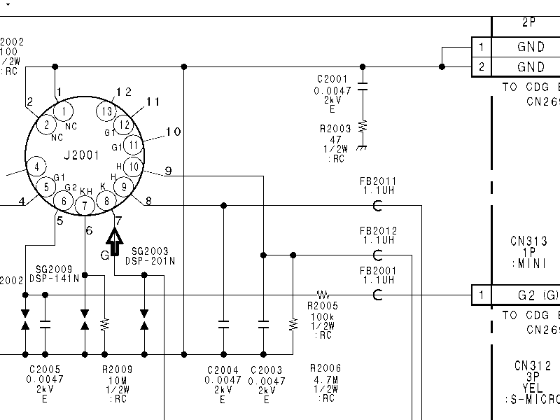

Posted: Mon Dec 11, 2006 7:05 pm    Post subject:
Sony (G90) connects pin 7 to ground through a 10M 1/2W resistor.

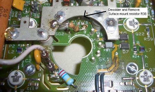

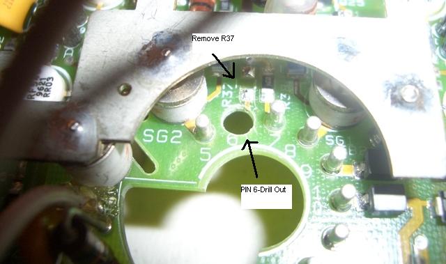

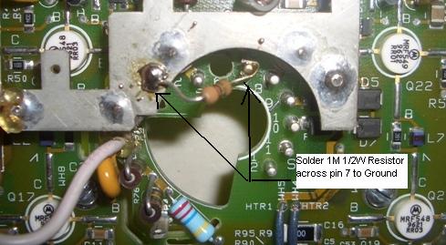

The first pic shows a modified neck card for P19LCP07's and PT-22. Desolder and remove pin 6. Then drill out the hole so that the G2 lead will fit through with no problem onto the pin from the tube that will now protrude through the hole. Use porgressivley larger bit until you get to the size that is large enough. Then desolder the resistor R37 for added insurance.(This procedure is coursey of CMJohnson)
Pics two and three show the next step required to use a LUG in the Marquee. Desolder and remove resistor R38. Using a 1M 1/2W carbon resistor jumper from Pin 7 to the ground block as shown. You will have to scratch up the surface of the ground block to get solder to stick. I put part of the resitor through the hole that is there already. Solder the other end to the tip of pin7. Becareful not to get it too hot or you will desolder the pin from the board. The two things you need to keep in mind is:
1)Position the resistor so that you can still get the G2 lead onto pin 6 but so that it doesnt interfere with the tube center.
2)Make the lead from the resistor to the pin short enough that in can not be pushed over to ground block or it will take the resistor out of the circuit and in essence wil be a straight ground.
EDIT:See updated post below with an additonal way to mod for LUG with more details

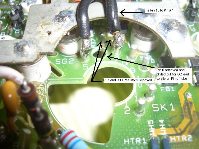

Posted: Tue Dec 19, 2006 3:57 pm    Post subject:
The attached pic shows an alternate way to mod the neck card for the LUG to work in the Marquee. It requires that you do everything same as previous LUG mod I posted with the exception of installing the resistor. In lieu of the resitor from Pin 7(KH) to ground you tie Pin 5(G1) to Pin 7(KH). I am told that internally this makes the tube equivalent to a PT-22.
Initially I can not tell awhole lot of difference between both ways ie with the added resistor or tieing the pins together. I did adjust G2 a bit but not much.
In general the notable thing I am noticing with the LUG is that G2 levels and Drive are significantly lower than with the P19's or PT-22's. Also the way the tube reacts to Contrast and Brightness adjustements is not linear with the the P19's or PT-22's. What I mean by this is that increasing contrast by say 3, more adversely affects the LUG and it seems to be somewhat exponential due the rapid increase I see in blooming.
Thus when you setup grey scale at your 50/50 Contrast/Brighness and then if you turn them up once you are done calibrating you do not get a lineal color balance. This makes setting up things a bit more difficult and I have't yet fooled around alot with it, but I will. This is one reason why it may not be advisable to mix and match LUGS with other tubes.
I will report back once I gather more data.
 Filesize:  87.04 KB
 Viewed:  18273 Time(s)
EJ
